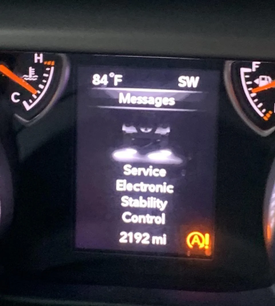

So was it only a loose wire and bad door latch issue? Both of these lights came up two days ago. The only difference after 1.5 years of driving it was that I recently got an oil change a week before and I was stuck in traffic for approximately 4 hrs on the highway. They've been coming up ever since but do reset when you turn off the vehicle. Nothing different has changed when it comes to driving.
Just had the same thing happen to me. Moderate rain, stop and go traffic, hot humid day.
I have never taken my doors off.
I took pictures for the dealer as the codes reset when I stopped and restarted the engine.
I guess I will ask them to look at it when I go in for V41.
EDIT: I should also note that I have the basic Sport, so no electric windows, locks, or mirrors.
