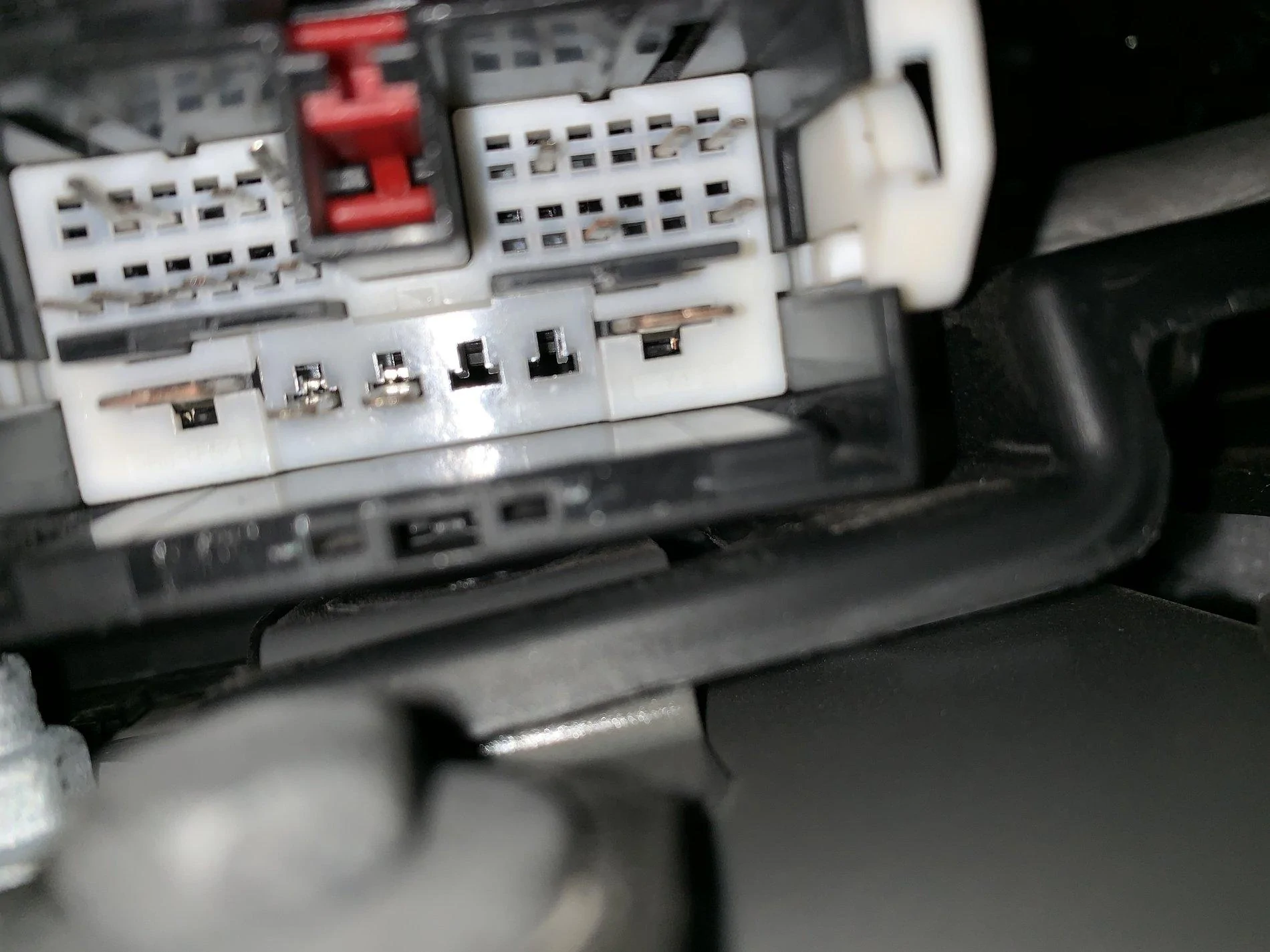

This way my issue. After removing and replacing the doors many times on other JLs, I’m surprised this happened. Here is what mine looks like. See the top left.
Jeep Wrangler JL Service Stop/Start System Warning Light - P2AF6 42A92DFC-704E-4AEF-B92A-820886BA85A7

This way my issue. After removing and replacing the doors many times, I’m surprised this happened. Here is what mine looked like. See the two pins bent, top left.
Quite certain that’s it. Try to carefully bend the pins back and attach the connector. Hope that helps! I’m extra careful now when plugging that thing back in. Strange too it only happened to the driver side door.

My issue is definitely bent pins.
