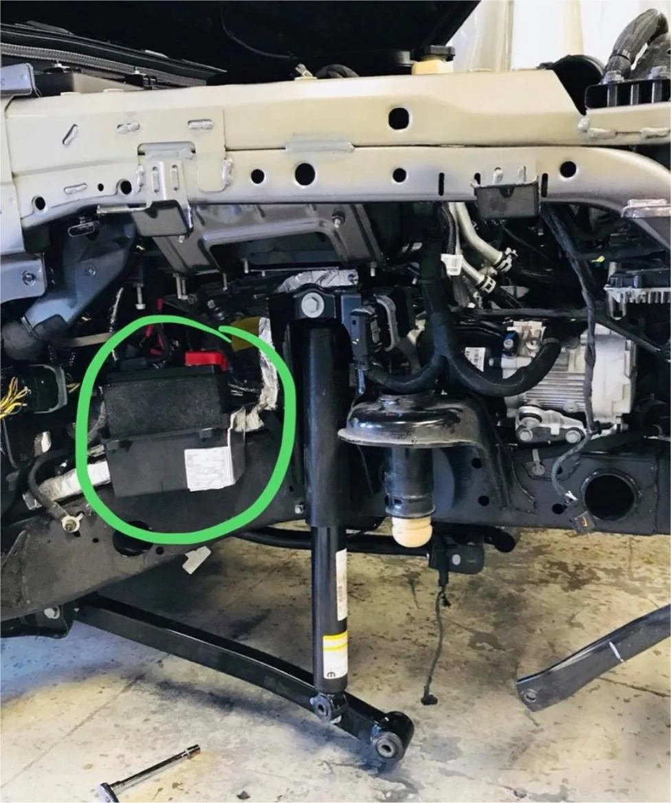

For Aux battery change the easy way and more battery related info read here:
https://www.jlwranglerforums.com/fo...ent-the-easy-way-pull-the-fender-flare.56807/

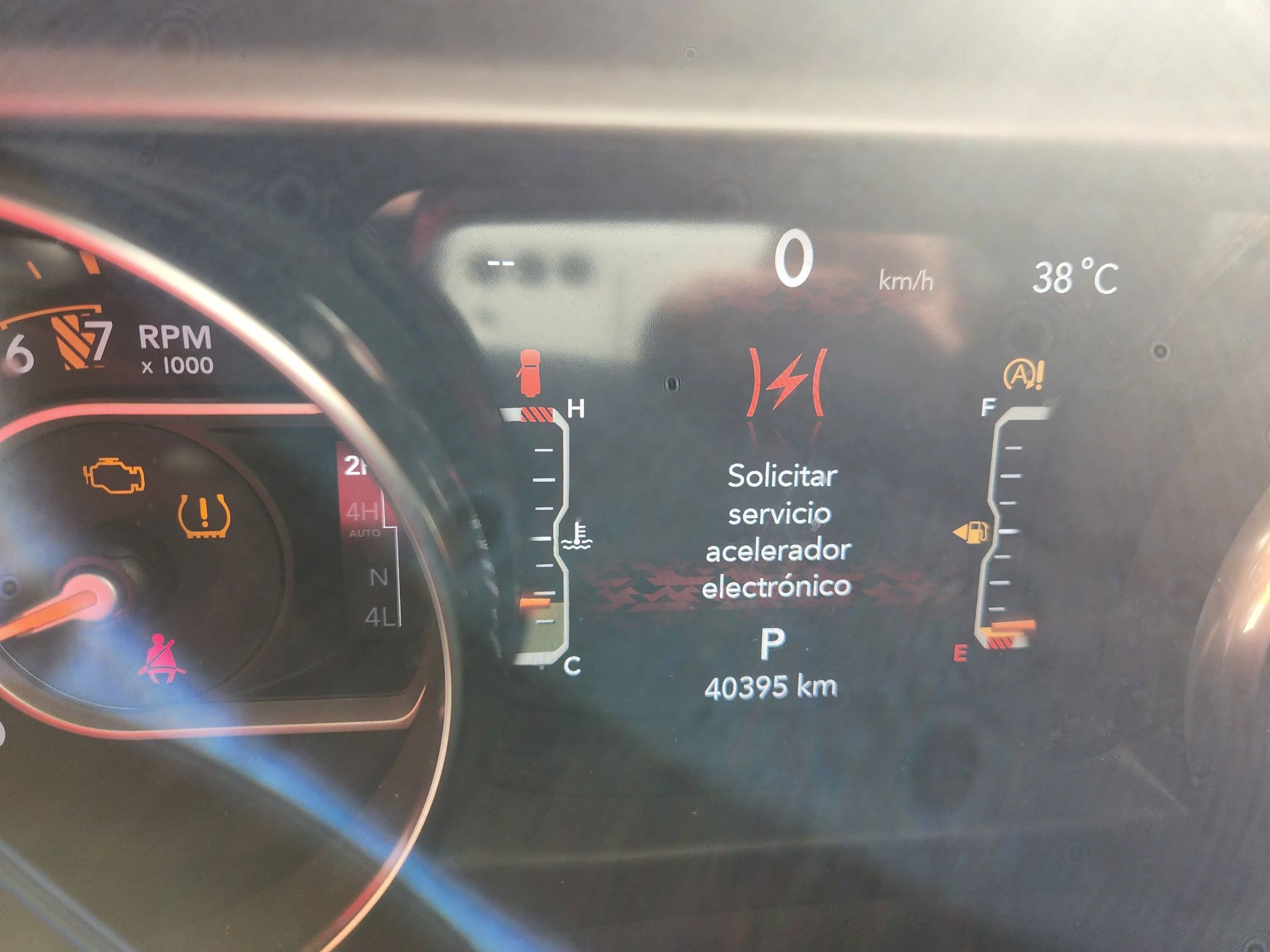

My ESS sport working 1 year ago, never had any warning light regarding that problem. 6 Month ago I apparently I had a loose ground wire and all this lights came ON. Beside the ESS not working (which I really dont care) I dont have any other issue, but I want to clear all those lights. There is any way how to clear this lights? Will a OBD2 scanner clear all this codes? Does anyone know what is causing all this lights not to turn off? I changed both my batteries 1 month ago.
2019 JEEP WRANGLER JLU 3.6
well for one, you need to put some gas in it. Then, you need to fix the actual problem.

I Removed the fender Liner. The jeep rides amazing, don´t notice any difference on it since I got all my lights ON. Wonder if I will be able to clear all the codes with a cheap OBD2 scanner.

The throttle control system fault should immediately clear on restart. Something isn’t right.
Do you know if does exist any sensor related to the throttle body? I have been looking more info about it but dont found any. In the dealership they said I might have something wrong with the Throttle body, but if that would be the case I should feel something unusual in the Jeep (and is not the case).
