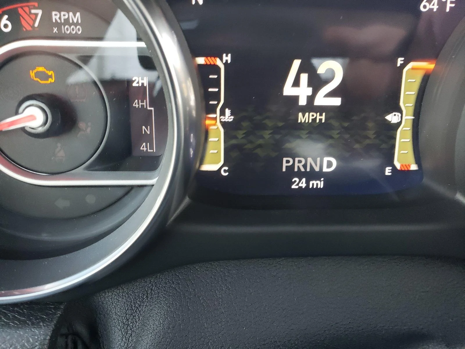

My brand new Rubicon JLU (delivered August 6) had the Engine Check Light go on at 117 miles.
Drive it home and the light was off when I turned the Jeep on a few hours later.
At 290 miles it came on again.
Took it to the dealer but couldn't make a service appointment as I was having surgery the next day plus time to recover.Finally took it in Sept 11 and they "fixed" it (apparently a software issue).
Picked it up on the 12th and the light was on again. They reset the system and it seemed fine (off).
Wife is driving it today and the light came on again, AND the Stop/Start System Warning Light has come on. The wife also says it's nor accelerating as smoothly now an there's a slight "tremble" when the engine is running, not smooth like before.
Anybody have any experience with anything like this.Obviously I'm taking it in again, but this is a brand new Jeep and disappointed is an understatement,
Hey my 2018 Jeep Wrangler 4 door sport 3.6L v6 check engine light went on with 184 miles on it. Out of the dealer the “A” assist with the “!” Next to the “A” Has been on my dash since I left the dealer. I’ve owned many many new cars and have never had a check engine light go on ever

2019 JLU Sahara. Got CEL at about 900 miles; dealer said it was a "cracked purge valve". Waited 3 days for part, then dealer returned my Wrangler and said all better.
Now at 3990 miles, got CEL and the Stop/Start System Warning Light, showing a P0507 code. Made an appointment for service on July 5th. This is getting annoying on a fairly expensive brand new Wrangler!

Well a follow up to my earlier post. Jeep still at dealership. They have entire dash out replacing entire wiring harness behind the dash due to a bad harness. Service manager stated that they have a new part number for the wiring harness and have seem a few problems around the country with the harness. I am wondering if this was the electrical burning smell I noticed about a month ago.. NOT A HAPPY CAMPER!!!! I am hoping they do not scratch up anything while taking my brand new vehicle apart..
