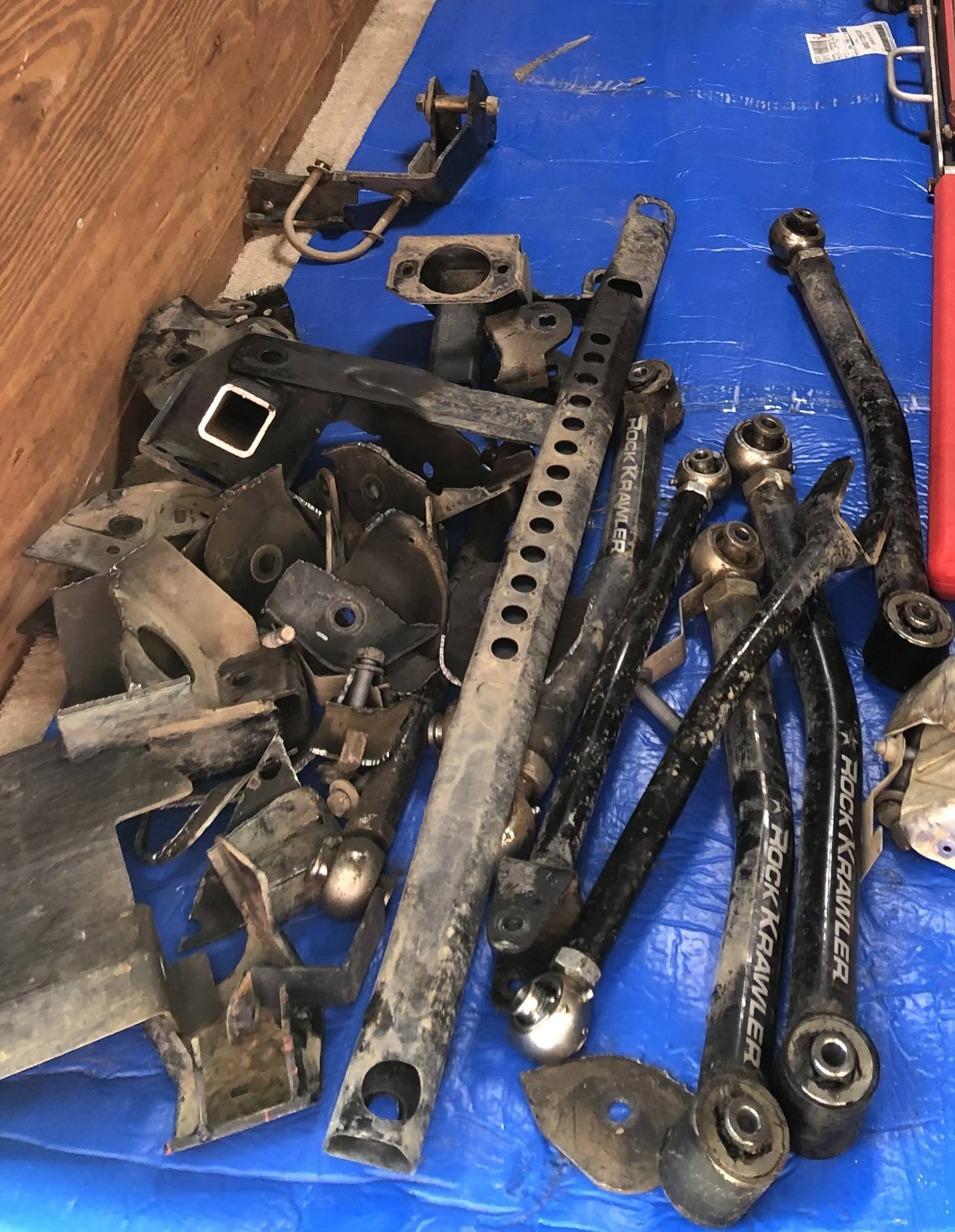

Agree with Zach, for your intended use, brackets will work fine……this is what comes off your rig when switching to long arms, unless you go to a bolt on kit….. but I’m old school and don’t believe in bolt on….?

Same pile for a full Metalcloak long arm bolt on kit. All the stock sheeit needs to come off. LOL
