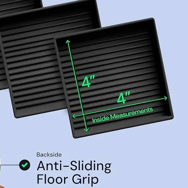

I use a generic, rubber, 4-inch furniture pad (up/lip-side down). It fits and works perfectly; the combination is much more secure than a 1.25-1.5 inch diameter bottle jack saddle on wood cribbing.

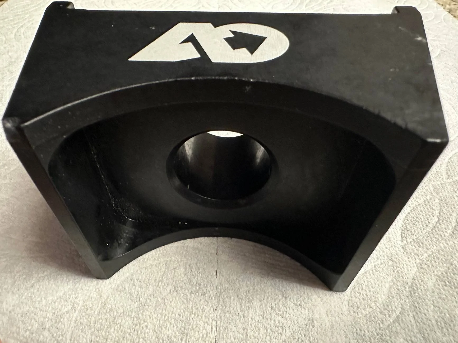

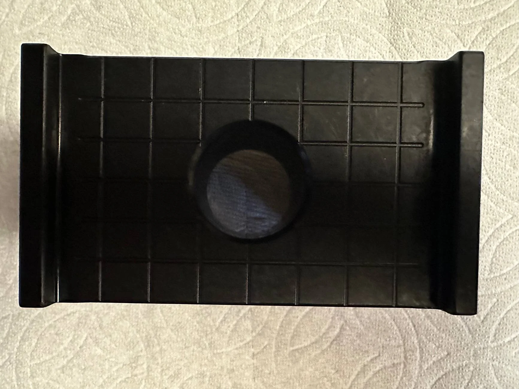

I bought a couple of 3.5 ton HMMWV scissor jacks back when they were plentiful for around $100. Now they have almost tripled in cost. I have these adapters from Agile Offroad for the HMMWV jack that allow you to lift from the axle or the frame rail. I keep one of the jacks at the rear of my Tuffy Security box and one in the garage.
