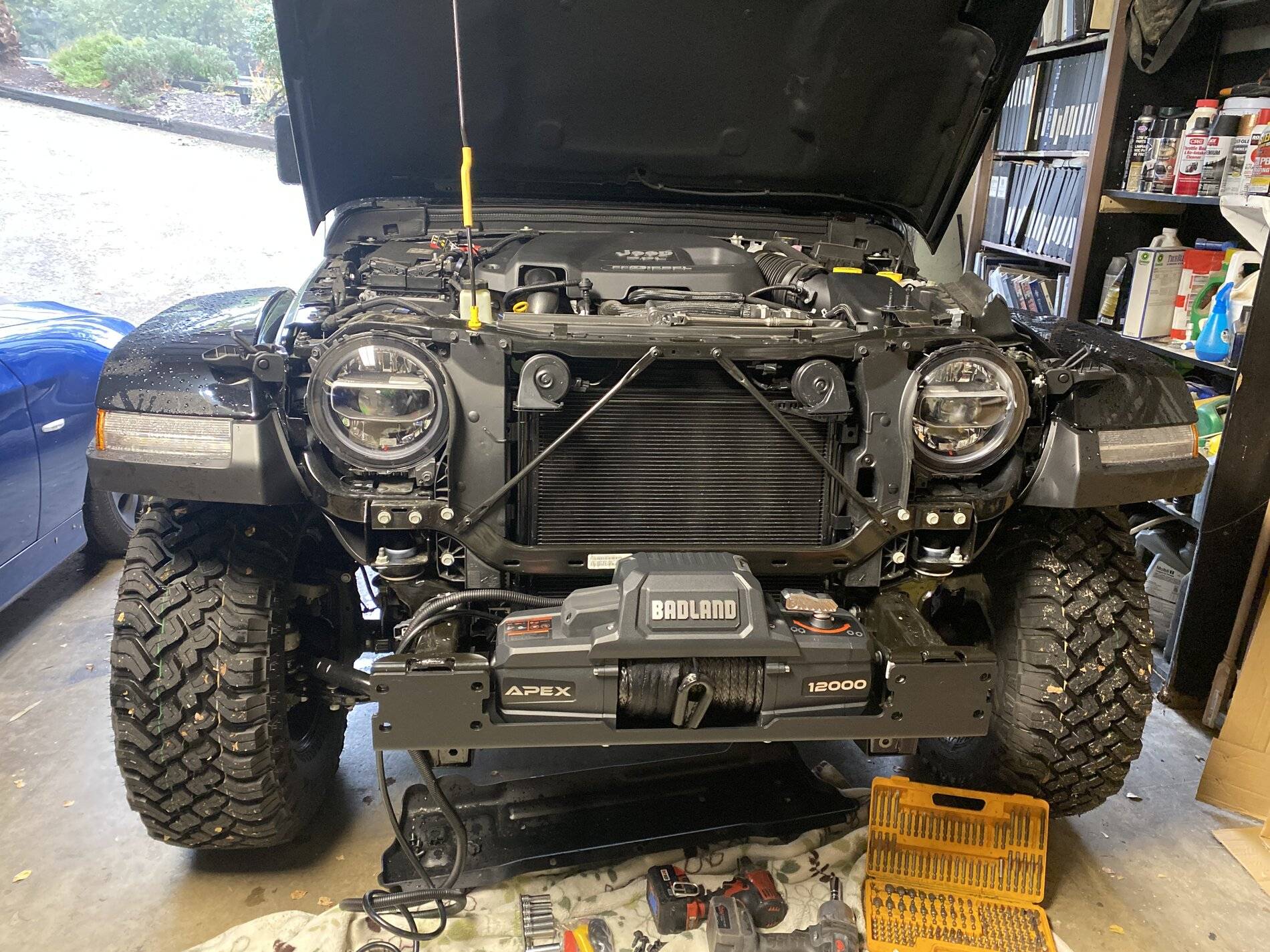

The winch does cover a large amount of air flow to the lower 1/3 of the radiator/condenser
That's a little deceiving as the bumper covers 80-90 percent of the winch. Even without a winch in place, the lower 1/3 of the radiator is completely blocked with the stock steel bumper. With the winch in place there is ample room for air circulation at idle and under power. If the radiator was completely blocked it could cause an issue but that doesn't seem to be the case. Remember, our steel bumpers are designed to have a winch placed in that cavity-infront of the radiator at that specific location. From the OP's original photo it appears to be a Warn Evo which has a normal footprint and is properly centered.
There is a very good chance the thermostat is the culprit here. Especially with the fluctuating temperatures.
If it were me, I would first check with the installer and then investigate the thermostat and surrounding wiring connections.
