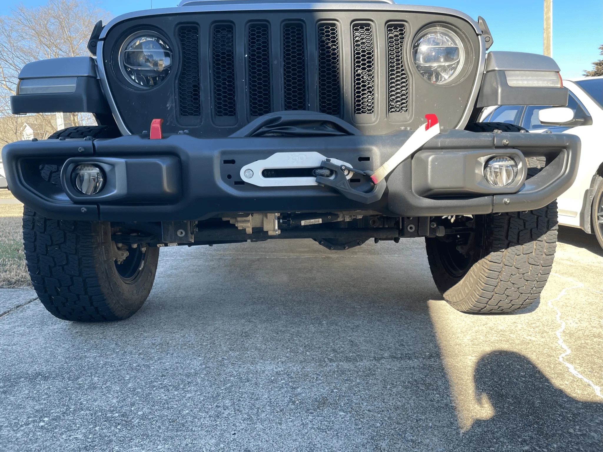

I just bought a rubi sway bar for my Sahara and did some research on it, it seems like no one has successfully rigged aftermarket electronics to work on it without frying the motor. Since the motors are so delicate and failure prone anyway, I'm just going to run it with one of these:
https://evomfg.com/products/nolimits-manual-rubicon-swaybar-disconnect-jk-jl-jt
It'll still make it super easy so disconnect and reconnect, compared to pulling the links or using a disconnecting link kit.
This is seriously the best mod I've done on the Jeep! Only takes a few seconds to turn that knob to disconnect and reconnect.
Jeep Wrangler JL Rubicon sway bar questions 1661189872742
