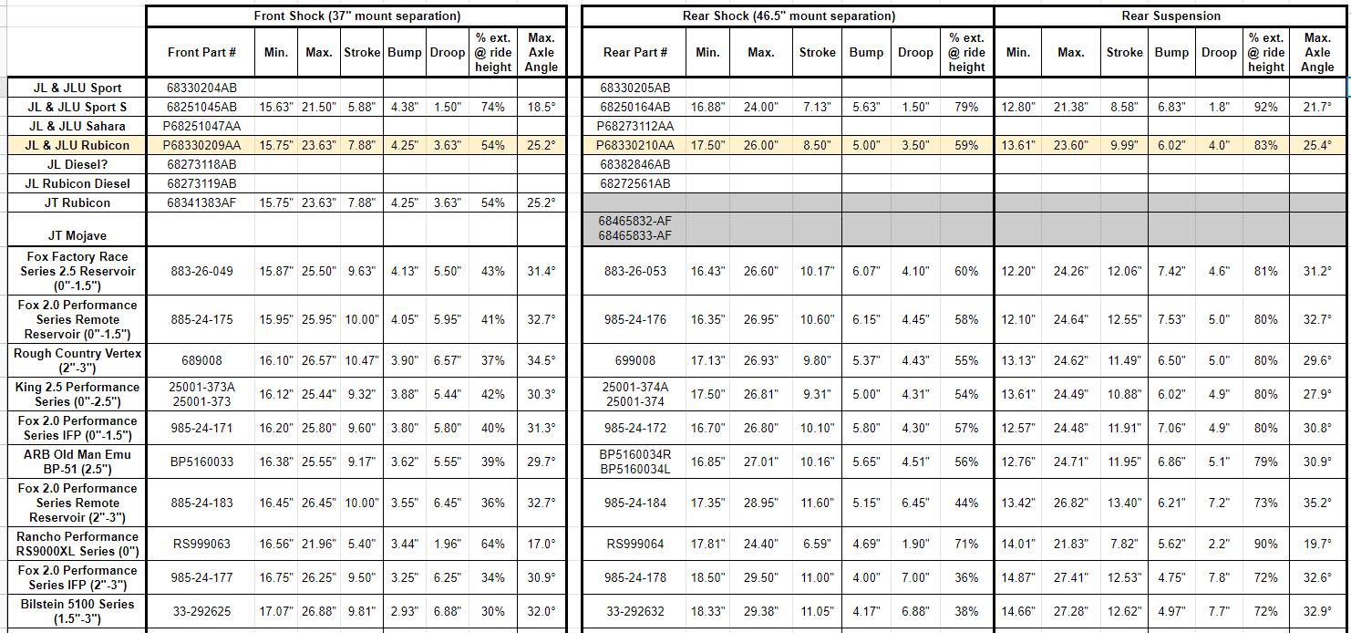

I just saw this the other day from a member, but for the life of me cant find it. Does anyone know the member that made this holy grail Of information.

I assume you’re referring to this by @AnnDee4444 . I’ve been referring to this to set up my ideal low CoG setup. This screenshot of his spreadsheet gives me so much information

holy grail
LOL @ holy grail.
It's not everything, as I am focusing more on the lower ride heights. Let me know if there's something else you would like to see.

Honestly i want the most lift i can get, another member offered me a spacer kit and now I’m hunting down a take off lift. I’m assuming JLUR with Steve bumper, hardtop, tow, and auto is the tallest lift. But i dont know much lol
emphasis on i dont know much

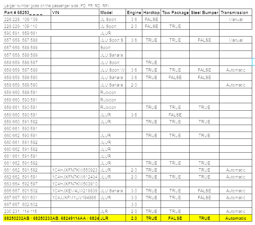

Sort of... there started to be too many combinations to keep track of, and the part numbers started getting inconsistent.
If you want something exact, I would find the model/option for sale online somewhere and get the VIN. Then send the VIN to @AllMoparParts.com and ask for them to decode what the proper spring part numbers are.

I might Be able to try to get those spring numbers if you give me your vin

You're mostl likely going to want a set of takeoffs from a JLURD steel bumper, hardtop, tow packages.
I have JLURD take offs on my sport, unsure what packages were on the original but still net roughly a 3in lift over the stock sport. Ride is a little more firm though.

What number springs did you get and shocks, but mostly want to know your spring numbers
