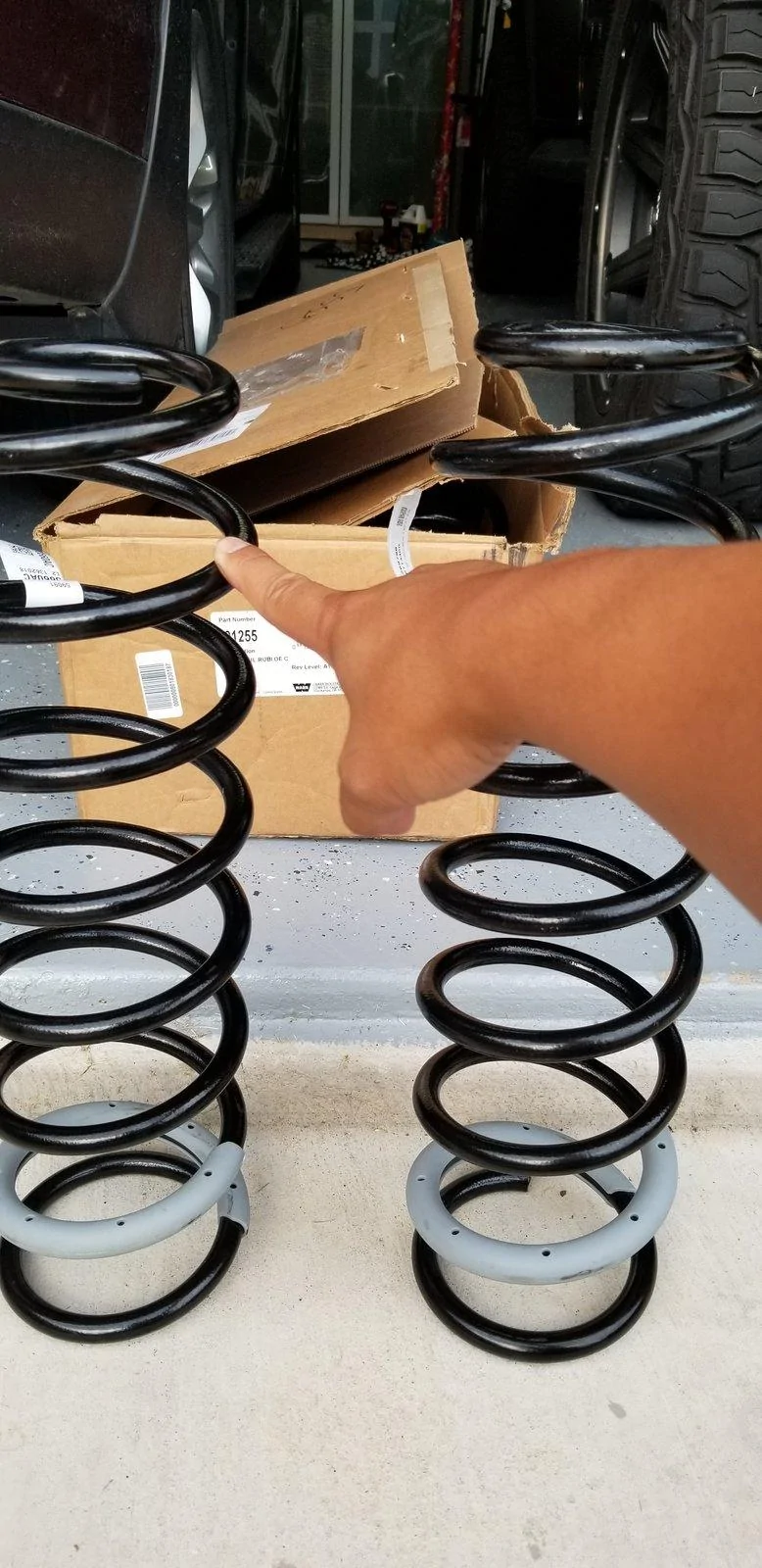

Looking up the 660AC part on Google reveils it's the replacement for 660AB. The 661AC is also the replacement for 661AB. My questions are if the 660AC is the front passenger is the 661AC the front drivers? I ask because what I've read here is that the passenger spring is is higher due to the extra weight on that side (batteries etc). But when I look at the springs the 661AC is taller. 661AC is on the right
Jeep Wrangler JL Rubicon suspension help 20180812_072914
Because of this do I install the 661AC on the passenger side? Also, does this mean that the newer Rubi suspension builds are taller than the ones previously built for the JL?

install taller one on passenger side because of the gas tank.. The extra weight gas tank causes it to sag to the passenger side.

Too bad they don’t have the colored tags, but it makes sense that the taller one goes on the passenger side as the wookie stated.

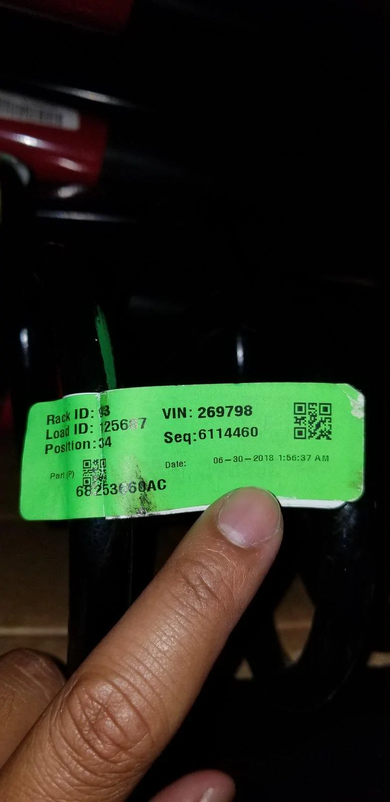

Yea... That makes sense. The 660AC (smaller spring) is the only one with the green tag
