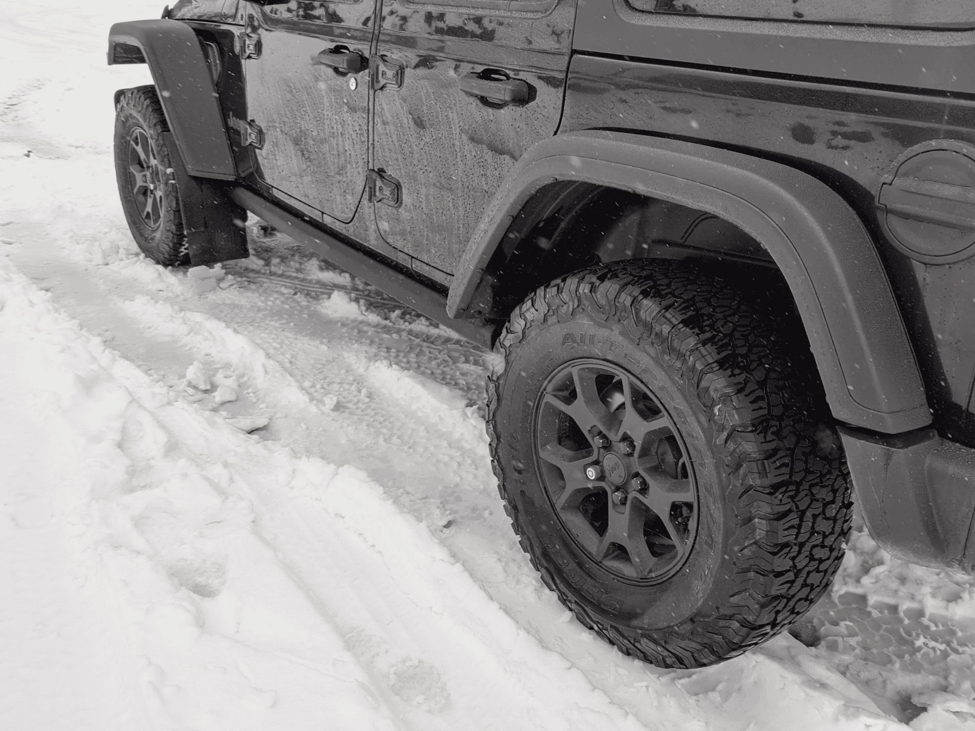

We use our JL with OEM KO2s a ton driving up and down mtn roads to various ski resorts. Was just up today and this pic had the tires sitting on a layer of ice. In 4H on a parking lot incline no slippage - then tried 2H and same result with no slippage. Have weighed the pros and cons - and will probs get these 285s again since my chains fit them perfectly. Gearing is perfect with ok acceleration - tires are not too heavy that might compromise components - ride is smooth and not too noisy - grip is good enough in rain snow and ice - sidewalls handle airing up and down w/o cracking - tread wears evenly and balances perfectly.
Only tangible negative for us is faster tread wear than expected. Suspect that the cause is the softer tread compound. Yes if you take a corner fast the rear end will unweight and let go in rain snow and ice. No tire does everything 100%. But because it does everything else good enough as a compromise AT - it is hard to deny. Def Toyo Falken GY etc have 3PMSF ATs as well but each of them also have their own pros and cons too. Problem is these KO2s have never let us down when it counted - making it hard to switch. For our uses these KO2s give us enough solid traction making dedicated snows not really required. Only thing is take iced up downhill corners prudently slow.
