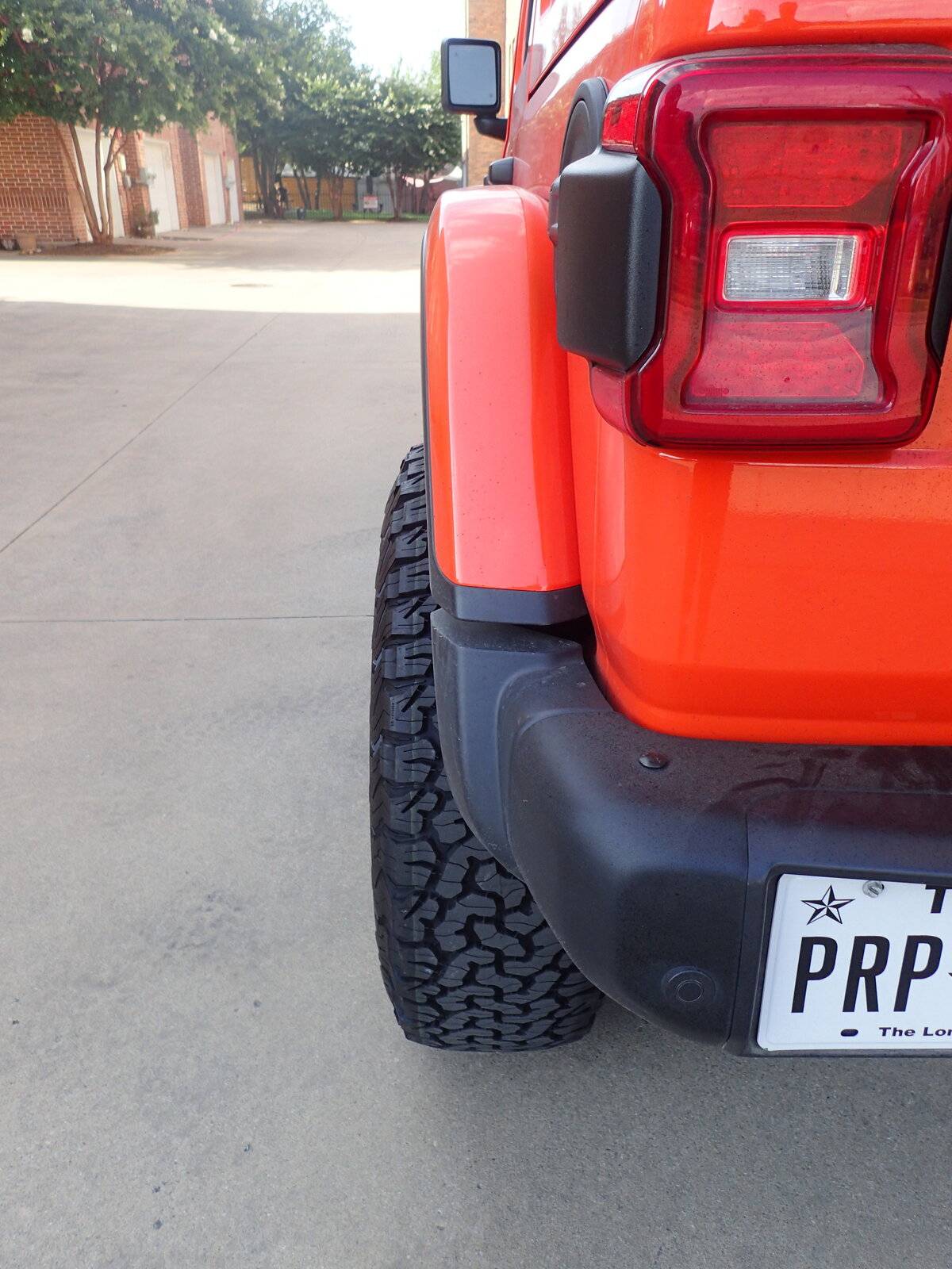

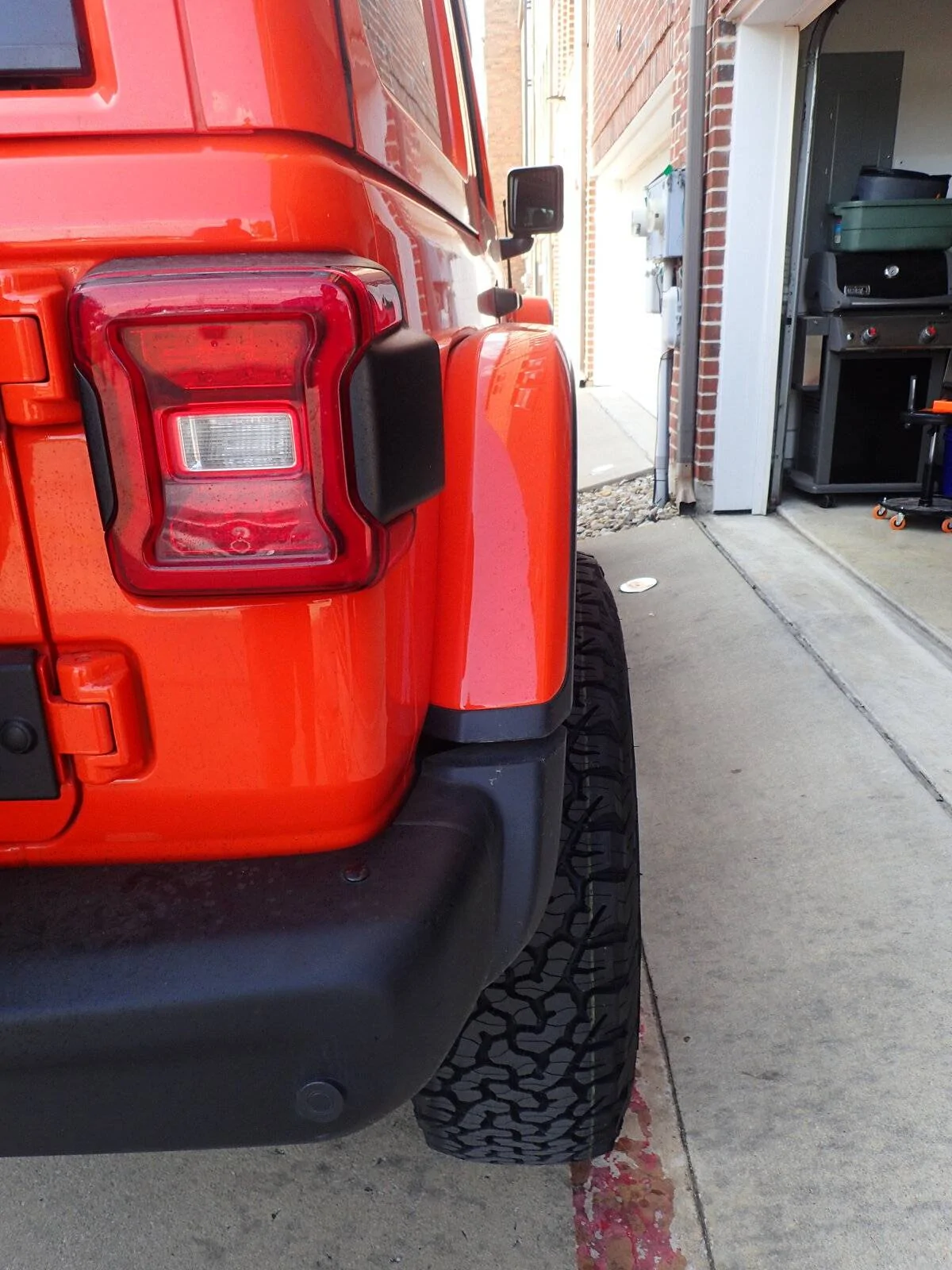

Here is a 17x9 -12 offset 4.53 backspacing
Jeep Wrangler JL Wheel and Tire Help Needed P7100012
