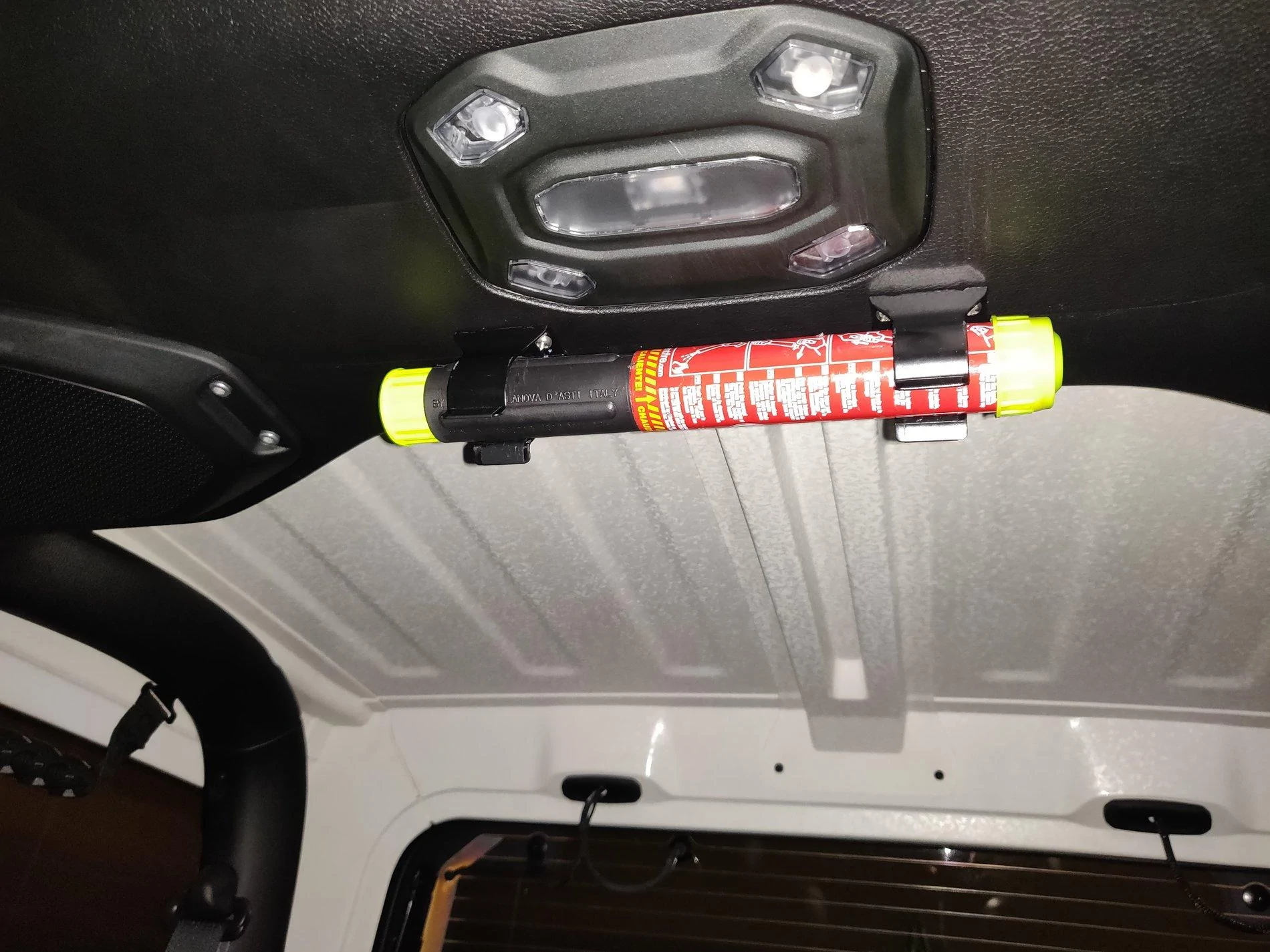

After years of carrying either two 2 lb extinguishers or a single 5lb extinguisher in my YJ's, TJ and JK's, I finally switched to an Element E50 for my JL.
I used the Rugged Ridge metal mounting brackets for 1.5" diameter flashlights (P/N 11238.06), and mounted the Element E50 on the center section of the soundbar. The brackets were a little too large for the E50, but a whack with a rubber mallet fixed that.
