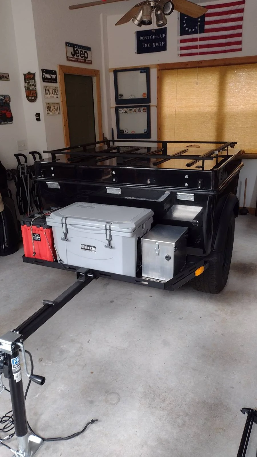

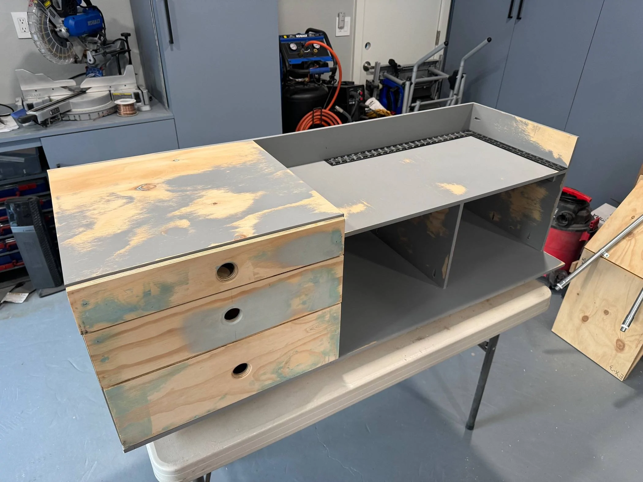

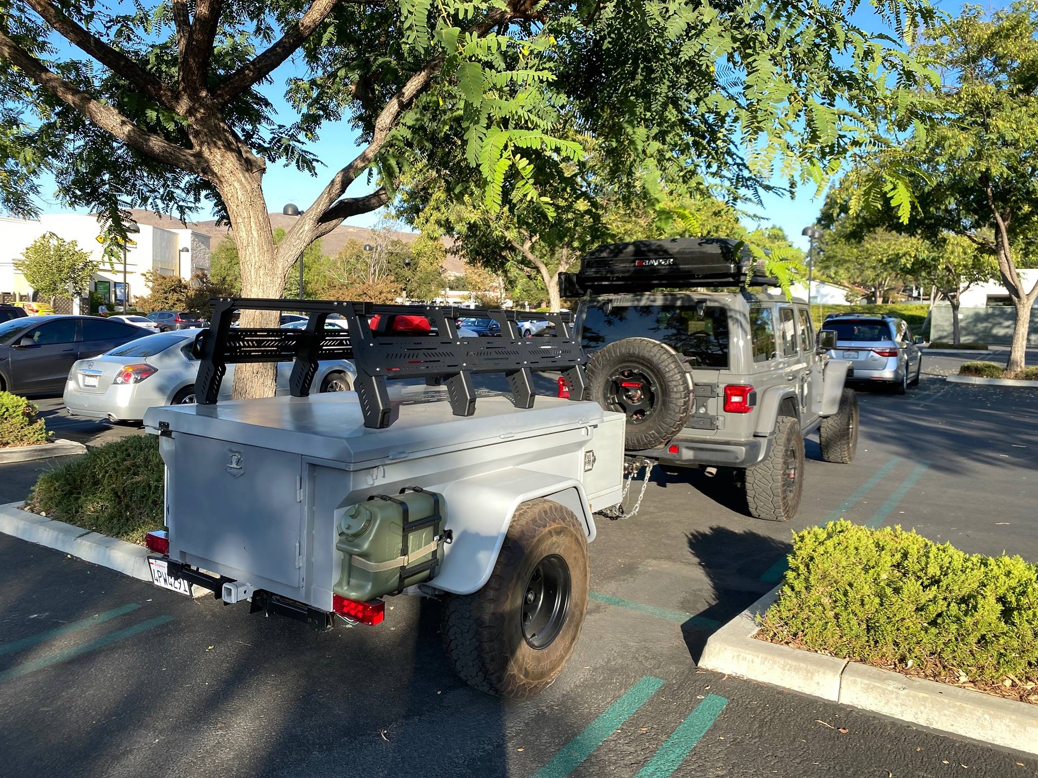

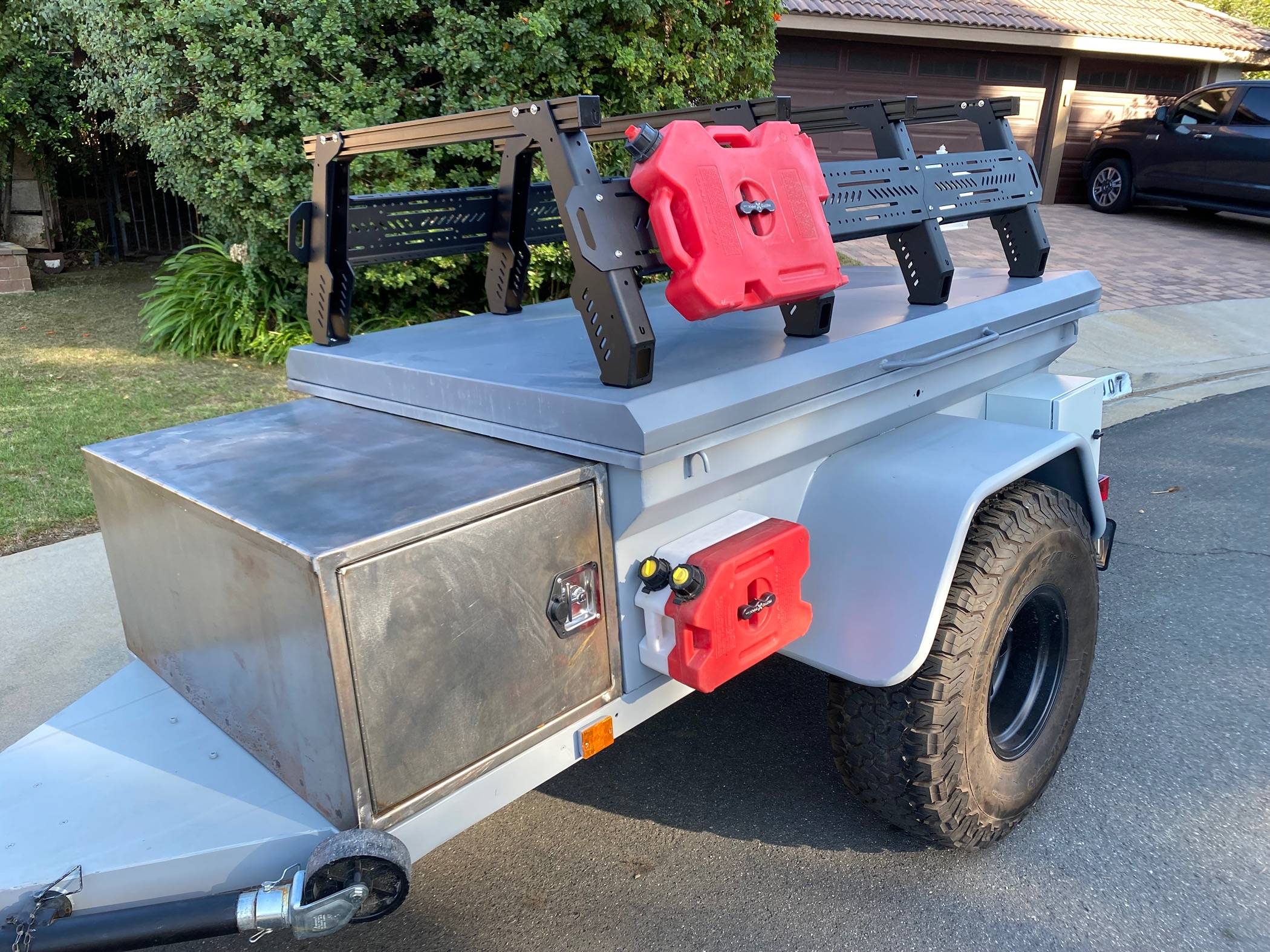

I’m currently going through the same thing. Like most things it has taken longer and cost more than i’d hoped it would to build but so far happy with the results.
I’ve spoken to Brad (Trail Recon) and Marcos (Overland X) at several overland events. They have been very helpful helping me design a trailer that meets my overlanding aspirations. I’d recommend checking out their websites and YT channels.
It’s not just the trailer but how it’s kitted out to meet your needs. Building it yourself gives the the ultimate flexibility in getting what you want and is a big part of the adventure. Buying one provides instant gratification but depending on your goals can be very expensive.

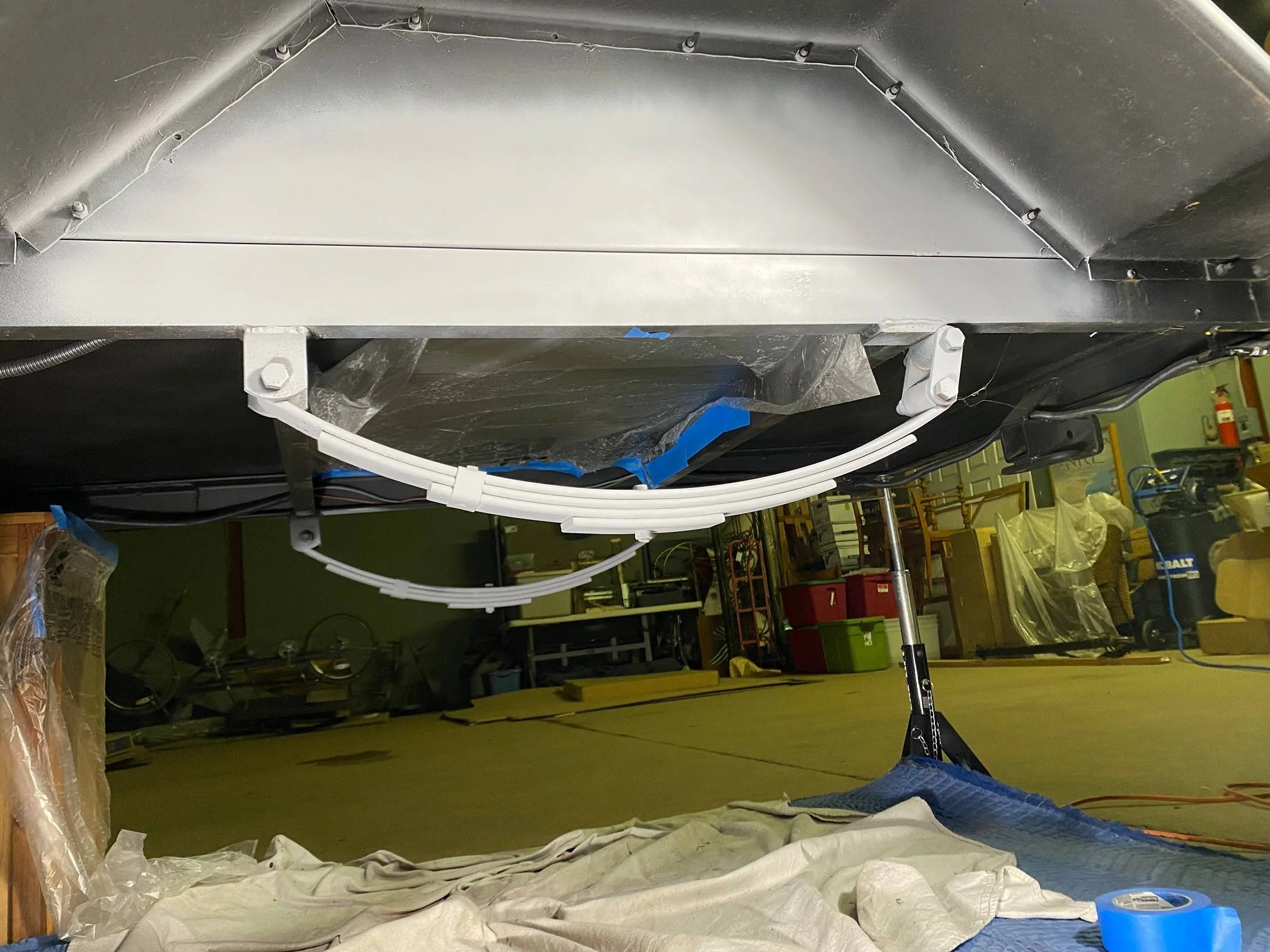

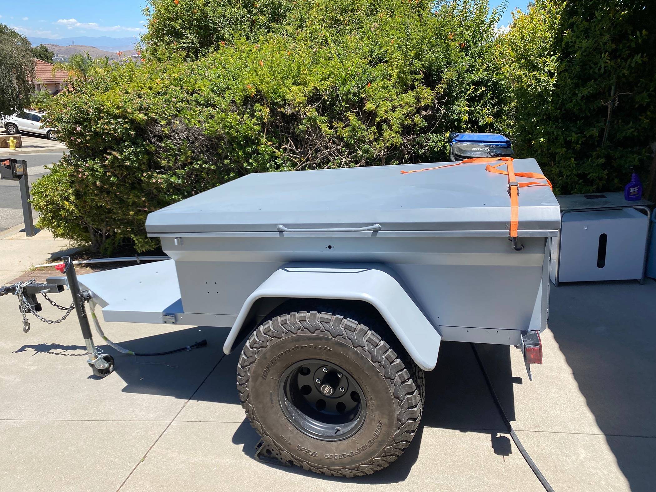

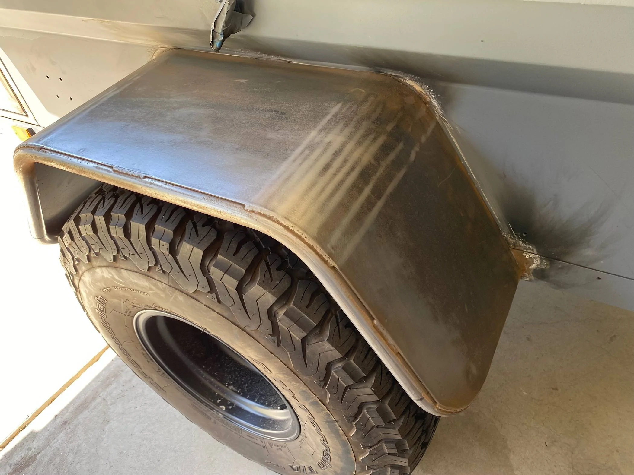

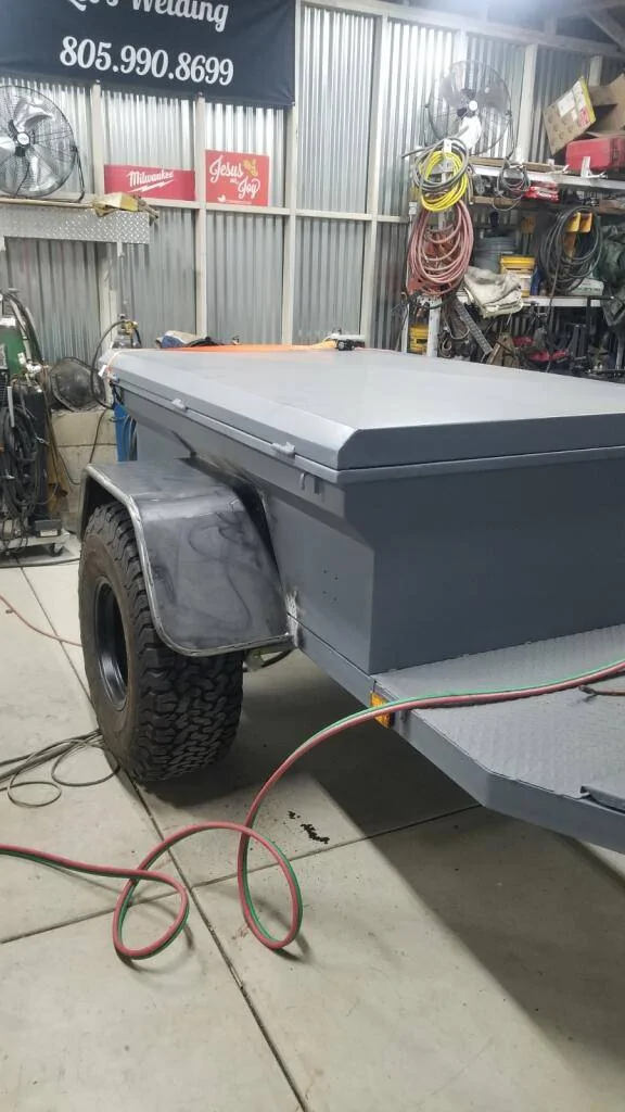

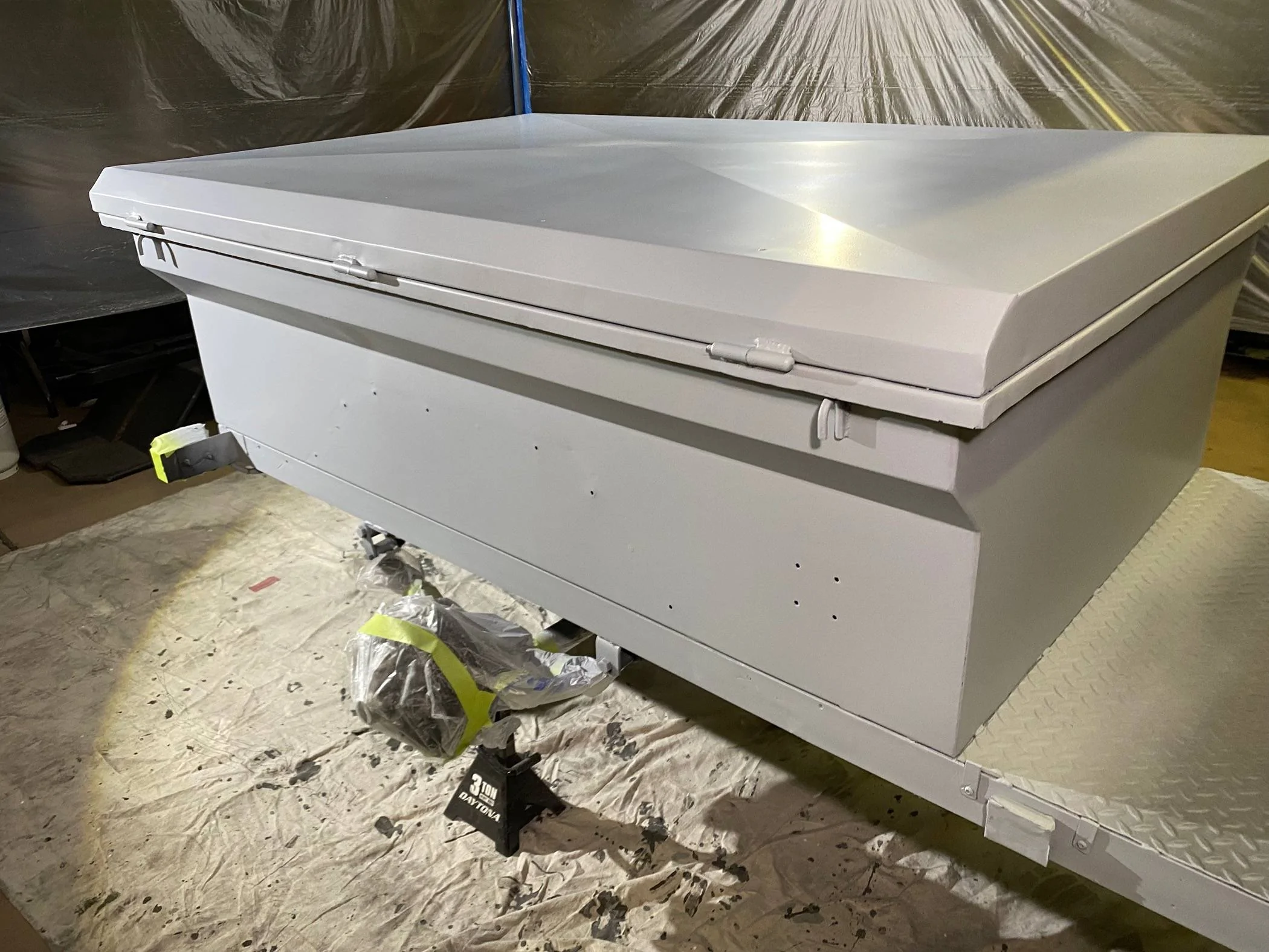

Not really sure. This is a bit of a hybrid. The M416 was rolled. Someone took the stock axle and mounted on the bottom of the leaf springs on 35’s the CG was too high.
I found a straight frame, got a 3500lb axle with a 6 inch drop. Extended the frame about 24 inches built new fenders.

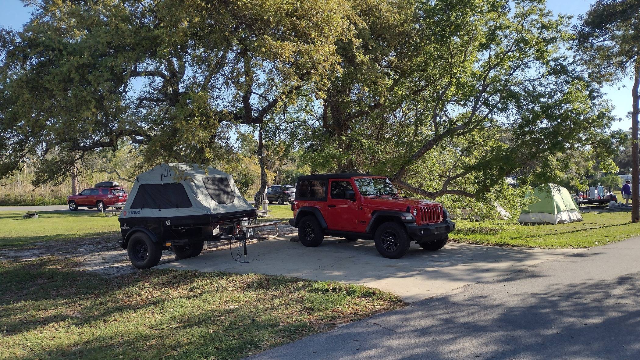

Two door soft top Jeep here...didn't want to do an exo-rack so the trailer was the route for me. I like the Taxa Wooly Bear but wanted to stay as light as possible. So we went with the Tentrax Ascend. Integrated tent and nice amount of storage let's me leave the sleeping gear, tarps, rainfly, chairs, Devos Lightranger and other things always loaded. Front rack has the lithium battery and have a Road Shower on the rear. Lightweight and easy.

Just looked that up - crazy light at 600# dry!!! Super cool, thanks for sharing. Starting to lean towards the trailer direction vs RTT....
Thanks for the info, I've been thinking about doing something like this but without ANY idea of how to start off. I appreciate you replying!

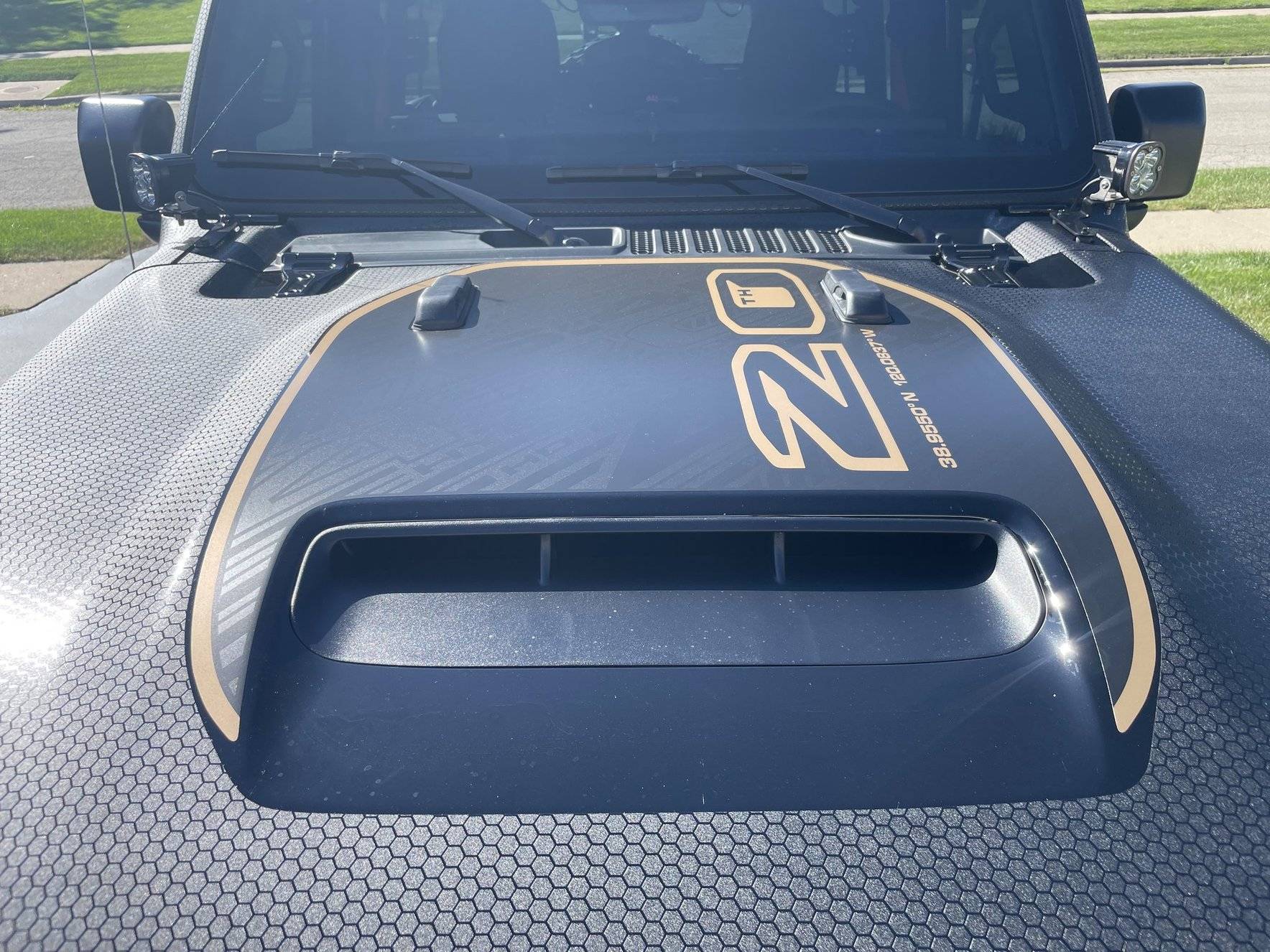

I like the wrap(?) on your top! Do you have a side shot available?

It's a wrap. Bottom half is a scratch resistant wrap and top half is more decorative (but subtle) and still protects the paint from the branches in trails we have in the Midwest.
A few pics!
