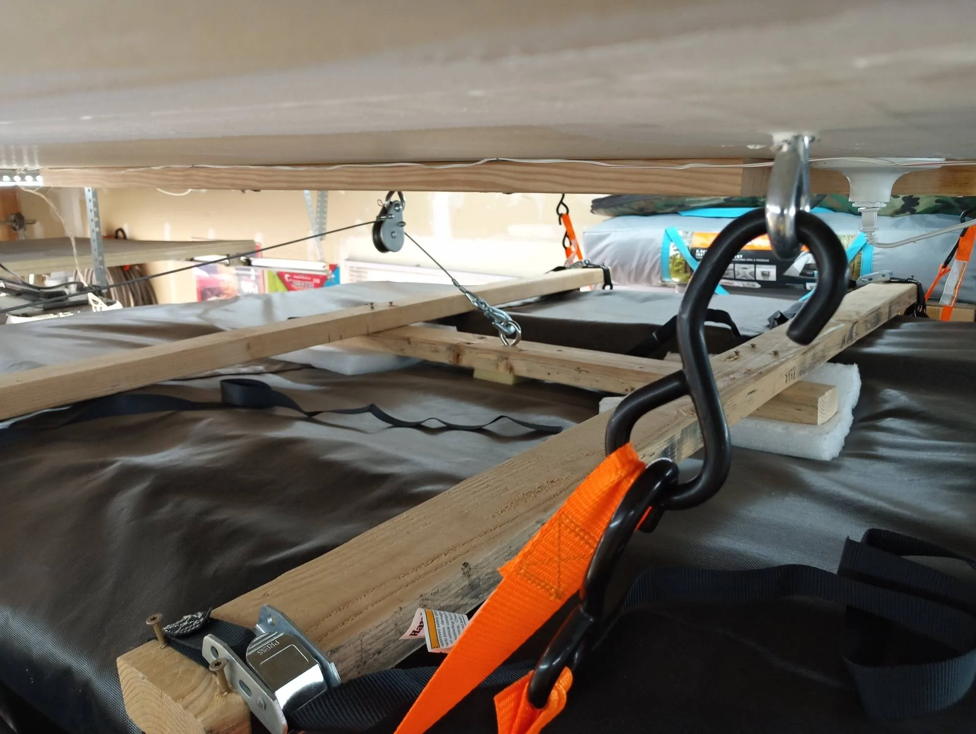

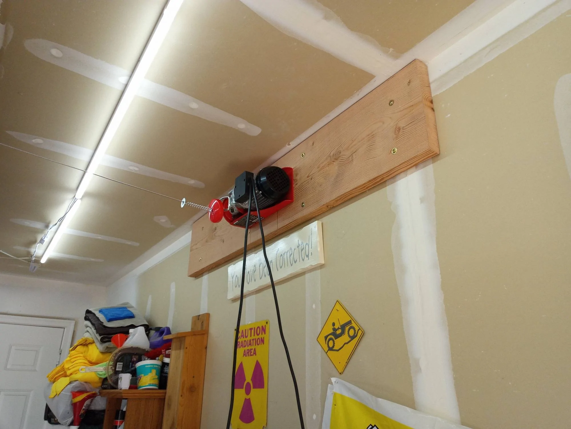

I have what I considered a pretty low ceiling in my garage, I have a townhouse, I used a harbor freight hoist with a wooden frame. I had to mount the hoist on the wall and run the cable to a pulley for everything to clear.
Jeep Wrangler JL Solo RTT mounting IMG_20190923_153317
Jeep Wrangler JL Solo RTT mounting IMG_20190923_153335_01
Jeep Wrangler JL Solo RTT mounting IMG_20190923_153327_01
