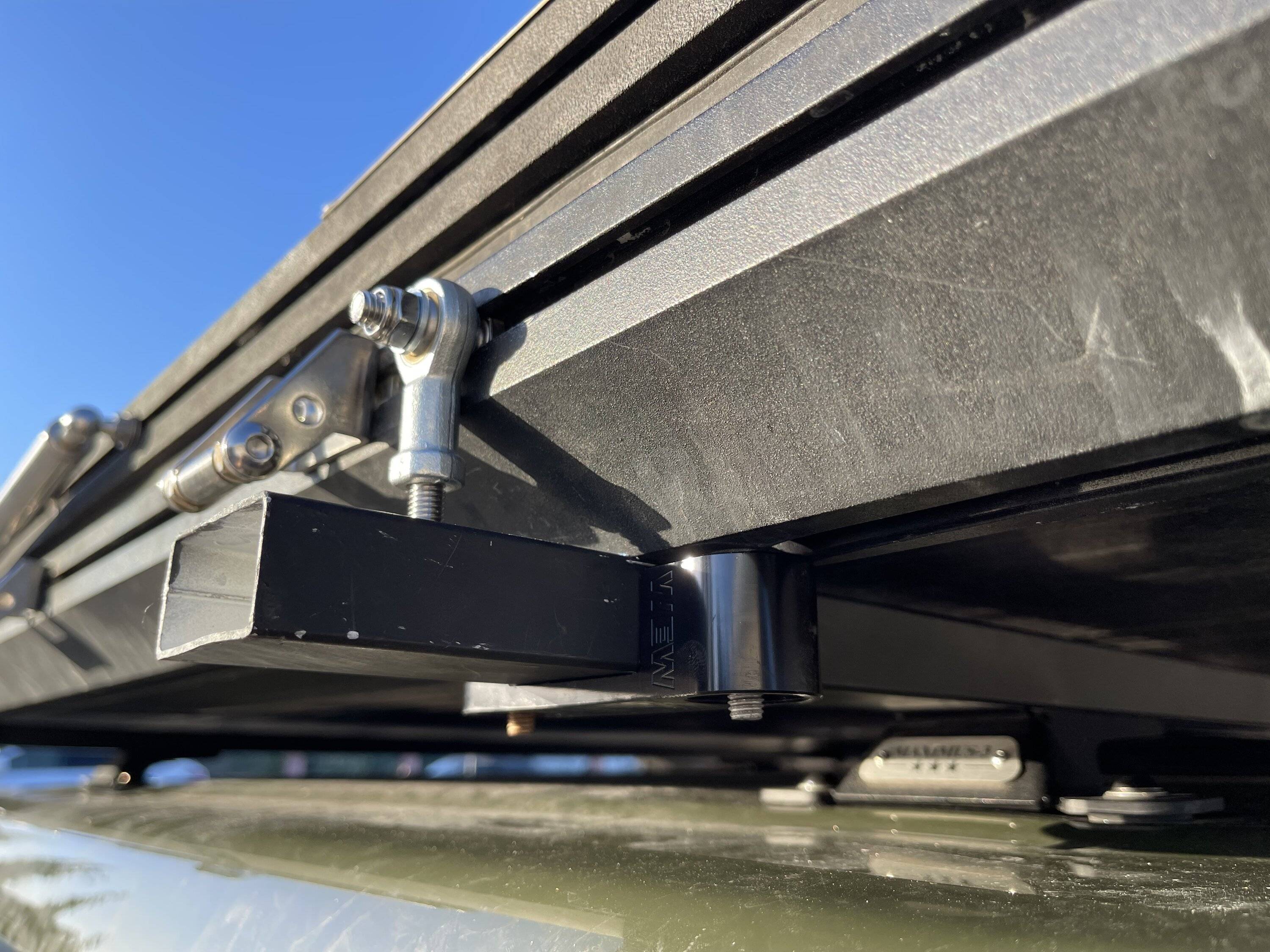

I don’t have a roofnest falcon but rather one of the many rebranded rtt’s of the same design. Here’s my mounting solution using the Maximus 3 mounting system and feet only. The cross bars are just 1x2 steel tube bolted to the Maximus 3 feet. The tent is secured to the crossbars using wheel every weekend security mounts and reinforced with the tie rods (from a shifter kart) attached to the side channels. The factory rtt mounting tracks remain in place for some tent floor rigidity but are only resting on the crossbars. I chose to skip the pioneer platform because my rtt stays up there full time and would take up all the rack space anyway.
Jeep Wrangler JL Relocating Factory RTT mounting channels IMG_5876

Mtran The tube solution to the Maximus 3 mounts is innovative! I dig your linkages too...used dabble in karting once upon a time.
As I'm getting this laid out and looking at it more closely I'm leaning towards leaving the factory tent rails for rigidity as was mentioned. I'm beginning to think I'm just going to bolt straight through the floor and add the Maximus 3 mounts at a proper place on the RR. Will of course update when I actually make the holes.
