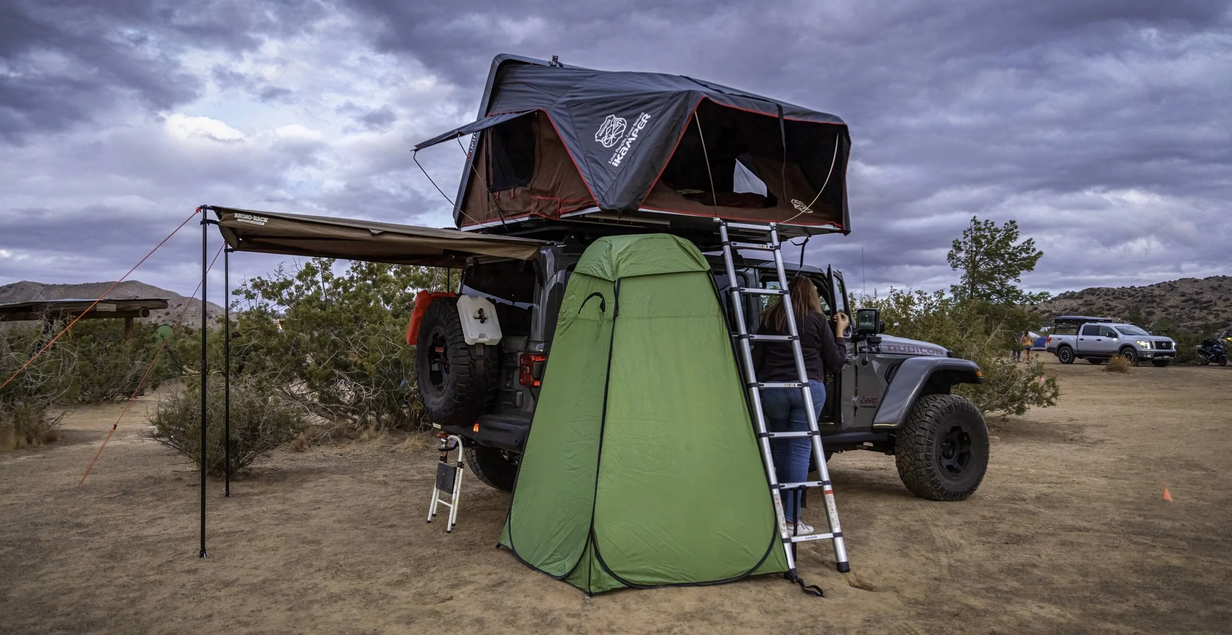

We have the iKamper 2.0 and over the past almost two years we've spent about 100 nights in it. When you've spent that much time in a tent anyone who says there are times they haven't been unhappy would be lying. I'm so sick of going up and down the damn ladder.
But this RTT has been great. Doesn't leak, used a diesel heater much of this past winter and even on the lowest setting when it was about 40 degrees outside it was still too warm in the tent - its well insulated. It's also the only RTT we've ever owned so I can't really compare it to anything else. The only real complaints about it is that it's pretty pricey but I think it's a great value and a little heavy.

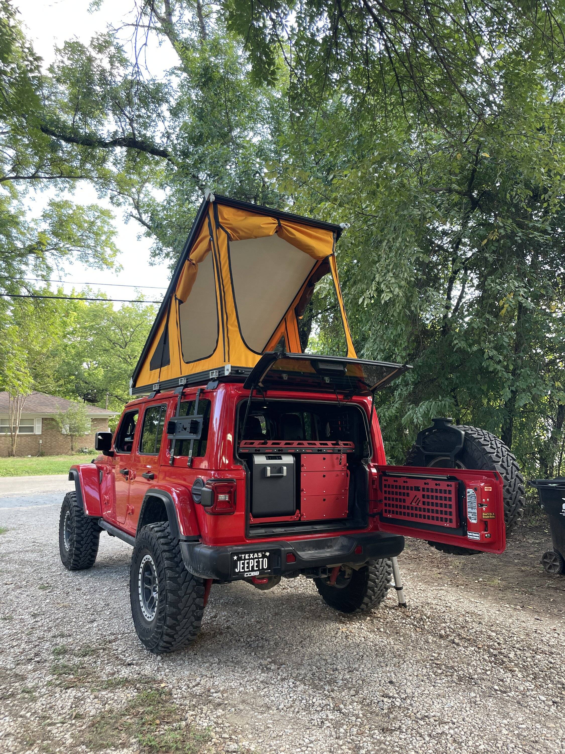

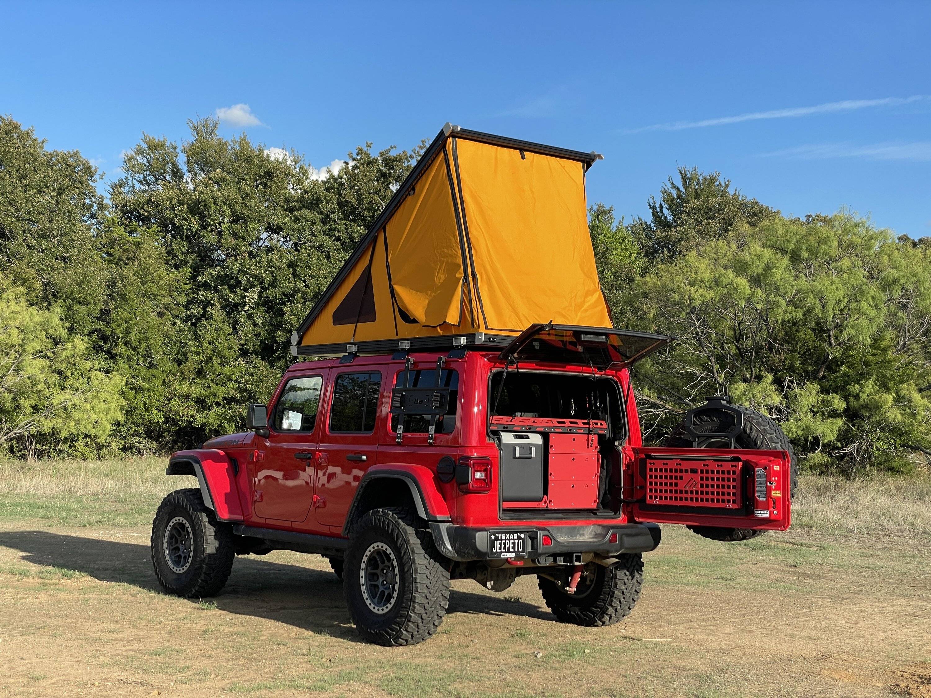

Sparky
GFC Platform RTT
It allows for super slick mounting for the JL with the rhino rack backbone and it’s made in the USA ??
Pros:
Made in the USA
Comfy
Light
Durable
Low profile
Cons:
Storage options
Price and availability
Not enough room for dogs or kids
Nice setup. Im very interested to see the Ikamper BDV in person. It's a unique approach to a RTT allowing you to assemble it yourself for a $400 reduction in price.

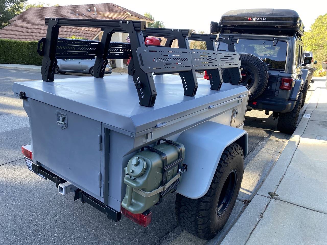

I really like the look of the GFC as well. The iKamper 2.0 is a king size bed and comfortably sleeps three and can easily sleep four. That's nice if you need it but II don't. The trailer is designed for longer more capacity camping so I'm moving the iKamper to the trailer and am starting to look at RTT's like the GFC for the Jeep.

This looks like a really nice! If I ordered one I'd do what you did and use the Backbone System as my base. Which mounting option did you choose from GFC? Aftermarket Rack Mount Kit or Crossbar Mount Kit?

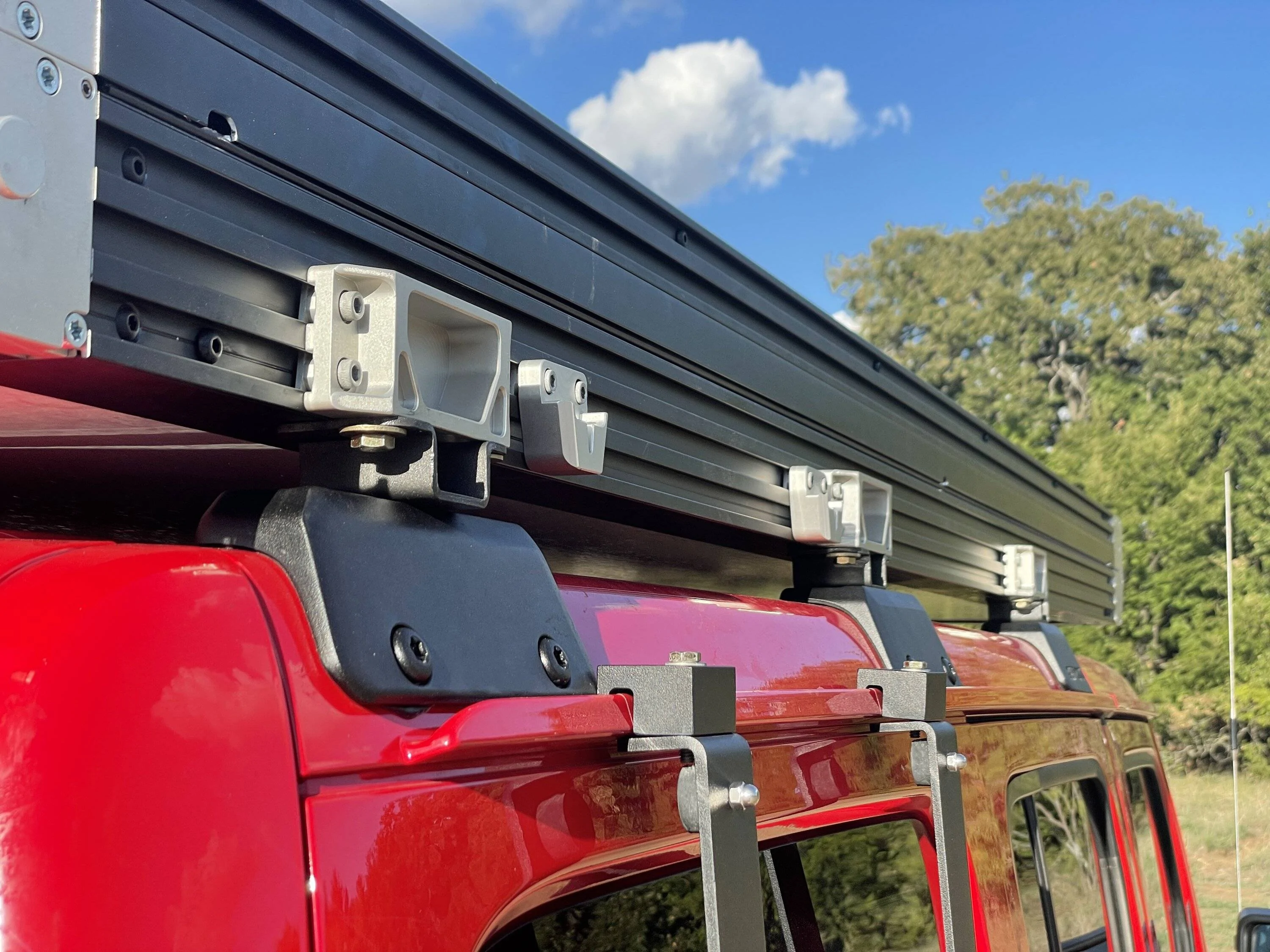

Rhino rack backbone for support and the GP Factor feet for the mount. You have to file the feet to get it to work but it’s worth it ?
Credit to @justinbmcbride for the mounting solution

I have been very pleased with the Rhino Rack backbone system. The end caps are a bit cheap, but rest of system is solid.
I ran about 12k-14k miles last year with the tent overhead, and the only issue was one of a bit of squeaking from the Vortex feet due to my reinstall. It wasn’t initially perfectly squared up, and it put diagonal stress on the footers.
Once re-squared, noise went away.
