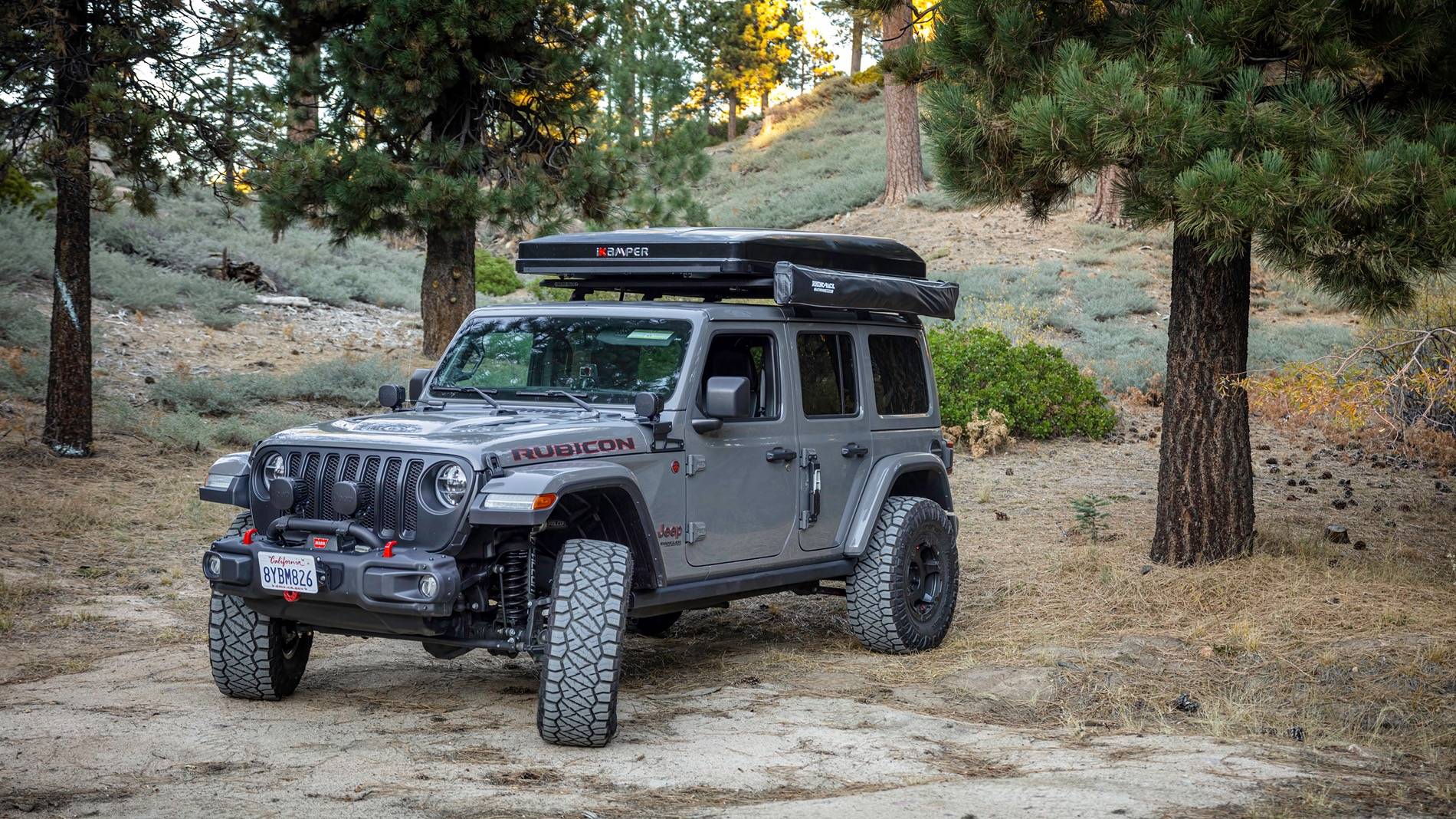

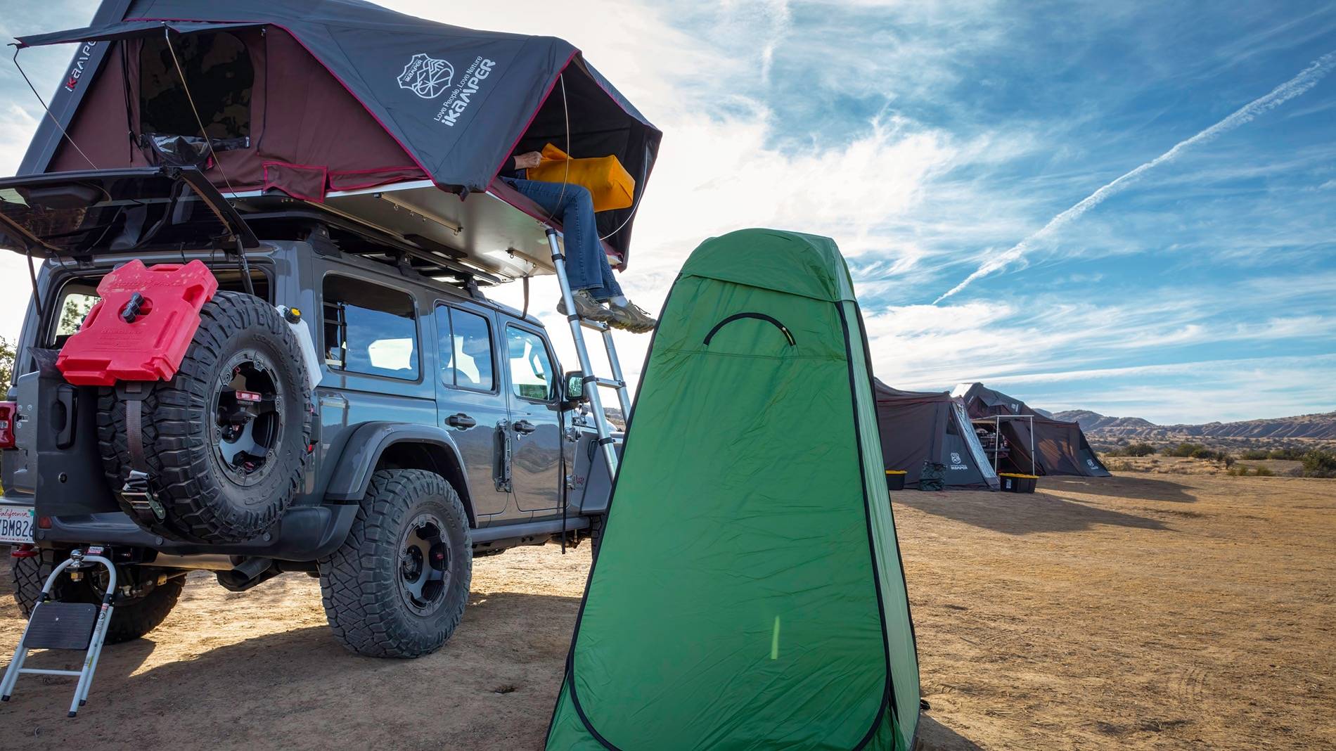

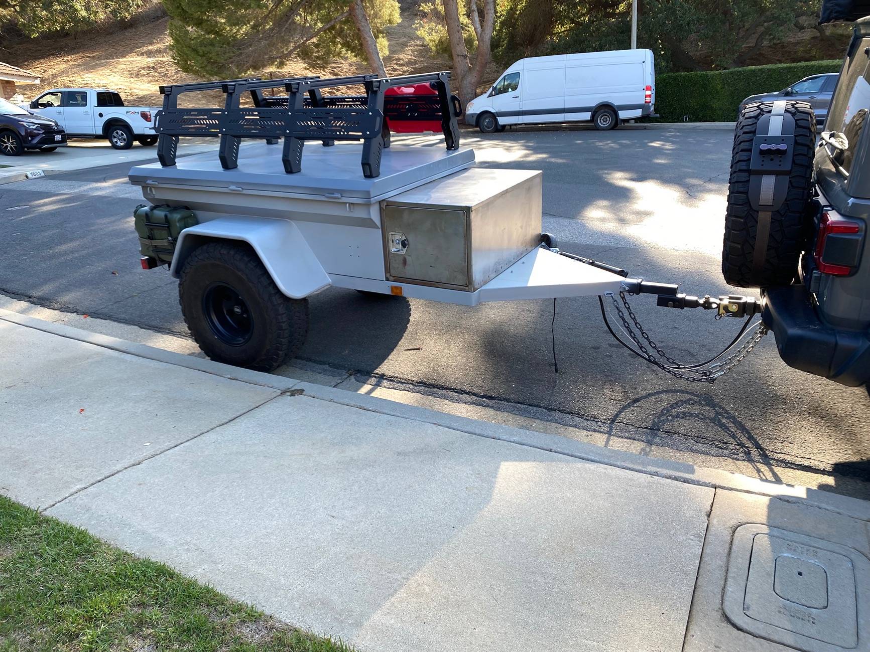

I have the Rhino rack on my JL, and both an UpTop rack for the RTT and Front Runner cargo rack on the trailer.
The Rhino rack is very good. Had an iKamper 2.0 on the JL worked great. I just decided to go with a trailer as a base camp.

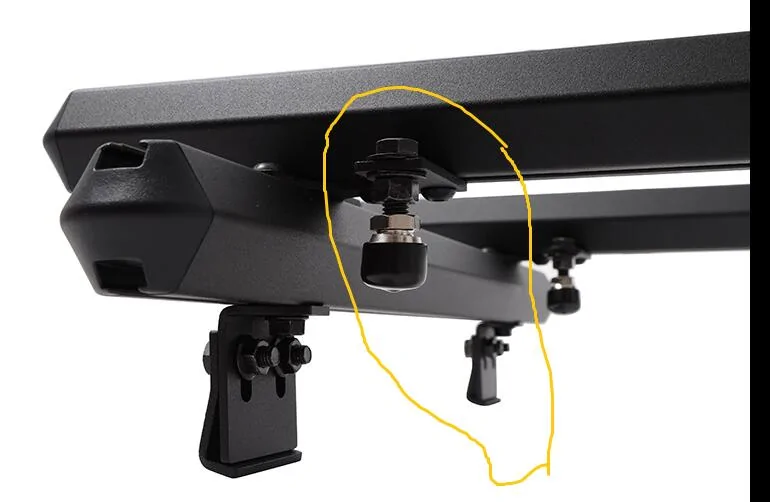

I just want to point out though that the Dee Zee rack doesn't bare its weight solely on the rain gutters: which some may see as a good or bad thing, but something to consider.
Weight is also placed on the hard top as per that circled in the picture below

The Rhino rack has a “backbone” inside the hard top that transfers the load to the body.
Please educate me Chuck, I honestly don't know, does this imply that the Rhino racks requires hard top drilling? If so I'd imagine the Rhino far stronger, but the Dee Zee of course is not modifying the hard top from its factory configuration for what, if anything, that's worth to the owner.
