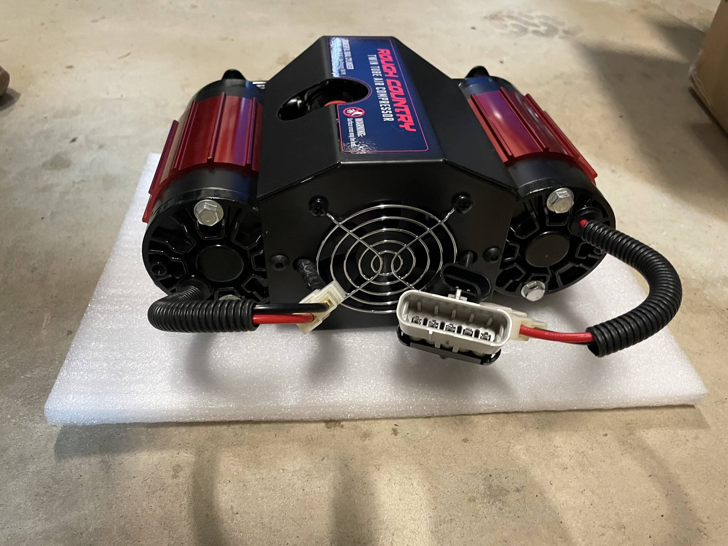

Update:
On a week long wheeling trip this past fall, one of the compressors started to blow a fuse immediately after turning it on. I pulled the compressor and harness. I checked the harness for connectivity. Both positives and the negative are fine. I checked the positive to negative- open loop. Visual inspection showed no issues with damage to the wires around the compressor. My assumption is there is a short in one of the compressors.
I emailed Rough Country about the 3 year warranty. We'll see what they say.

Update:
I have heard that RC has taken a HUGE effort in the last few years to improve quality of their parts, and customer service. Good luck!

Update:
Try cleaning the air filters. They aren't the best design. Even though they are about 1.5" diameter. The air only flows through about a quarter inch of them. So they can clog quickly. I am going to mod my filters at some point to get more airflow. Just haven't come up with a design yet

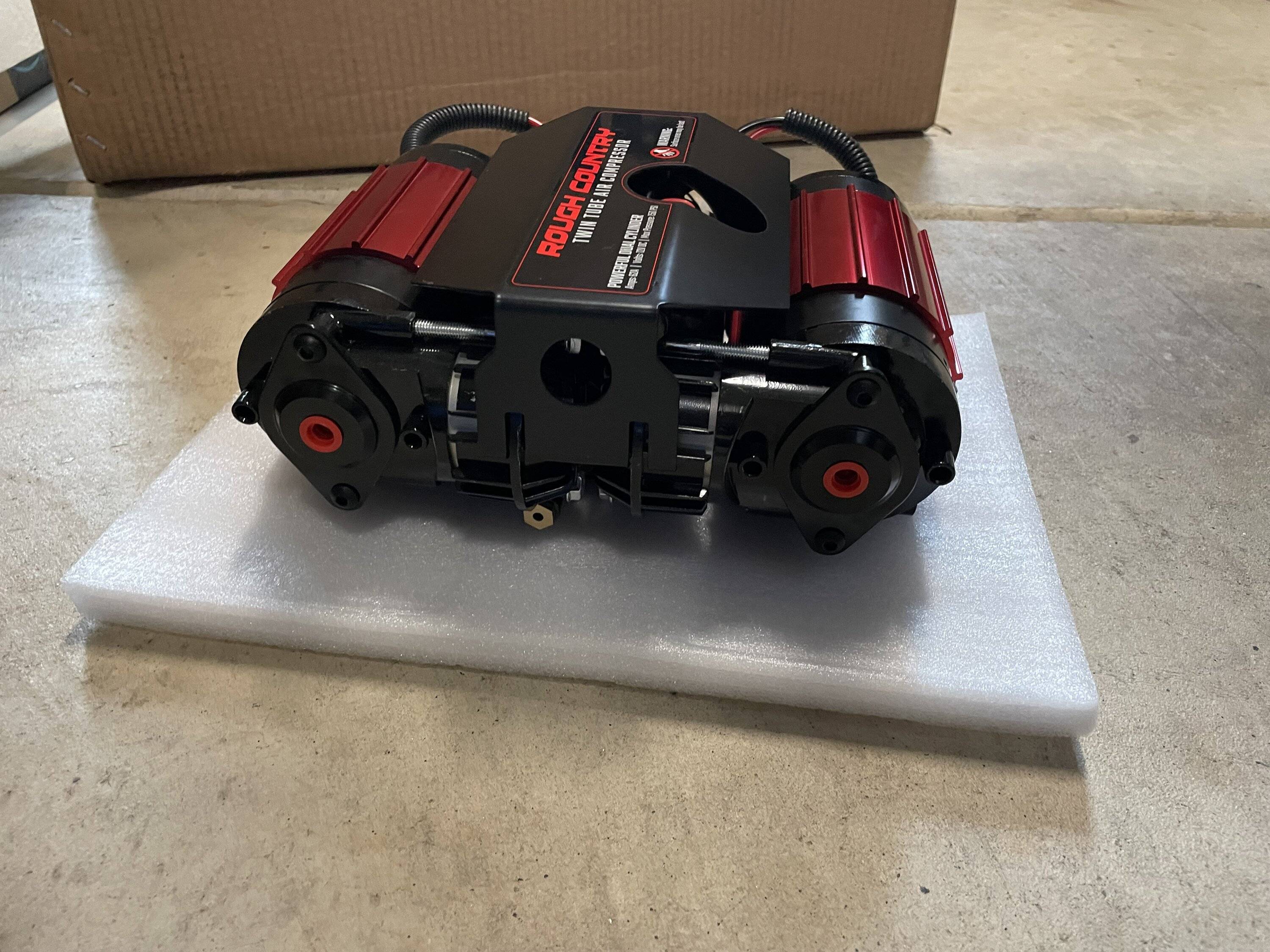

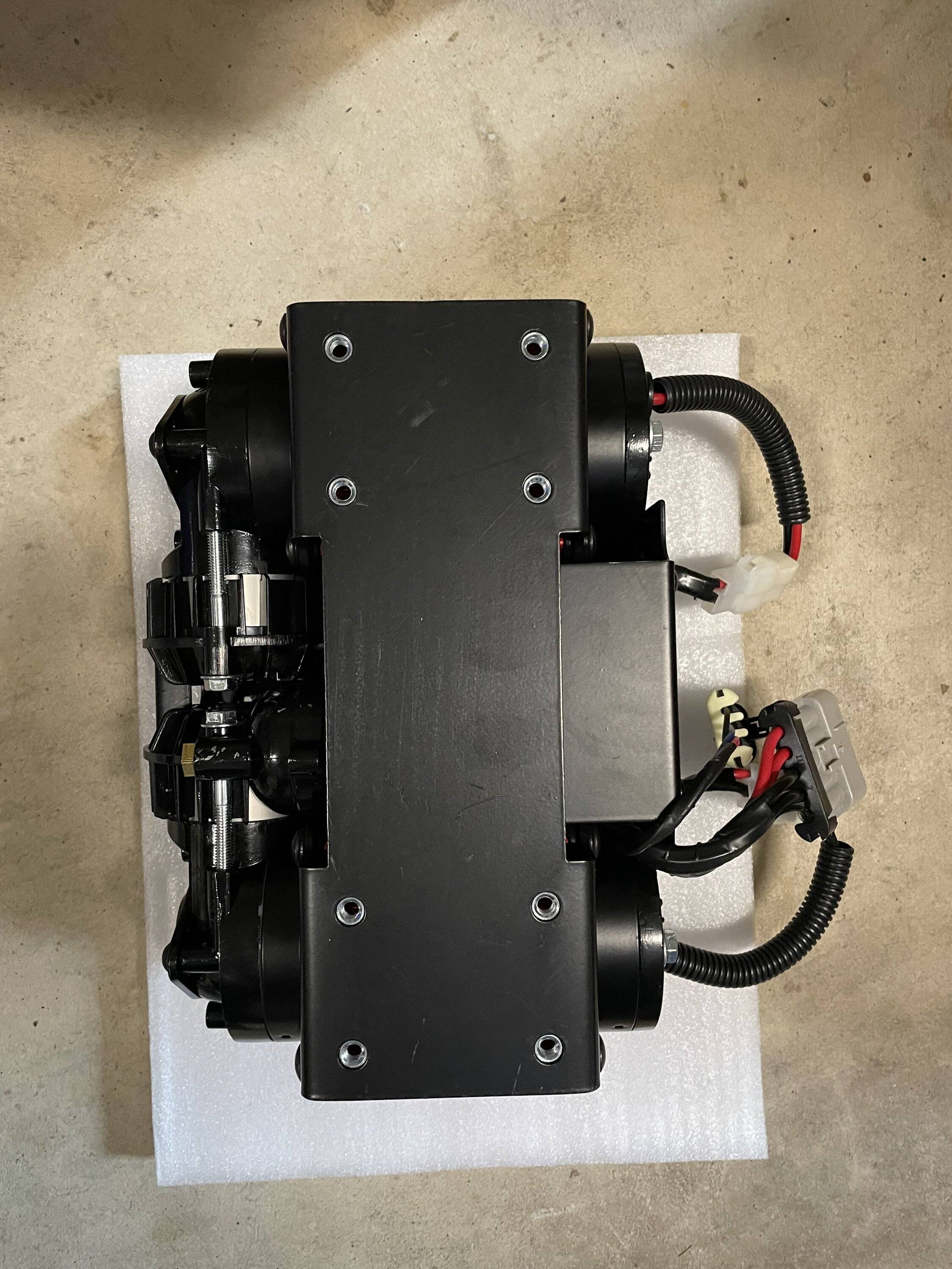

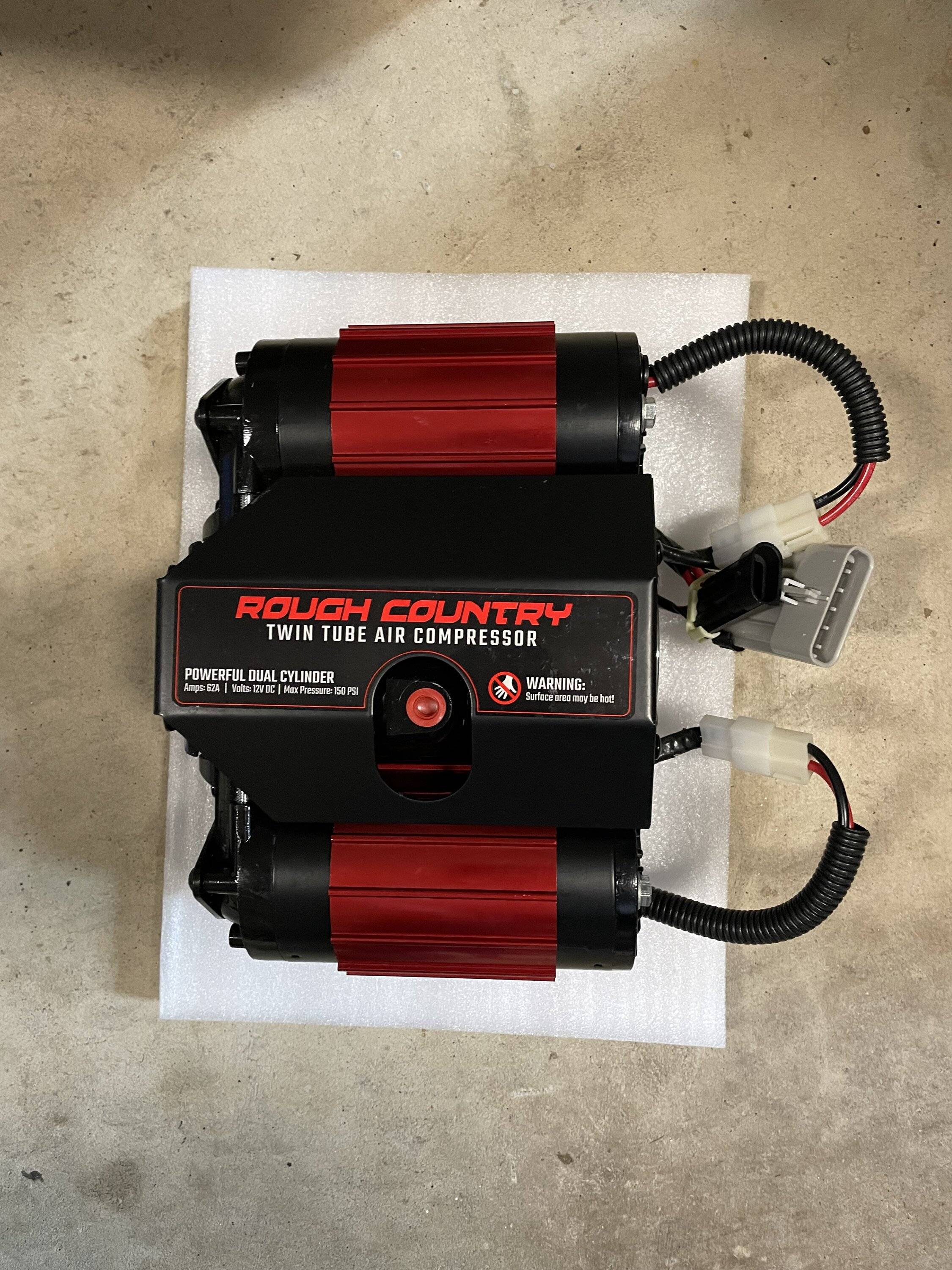

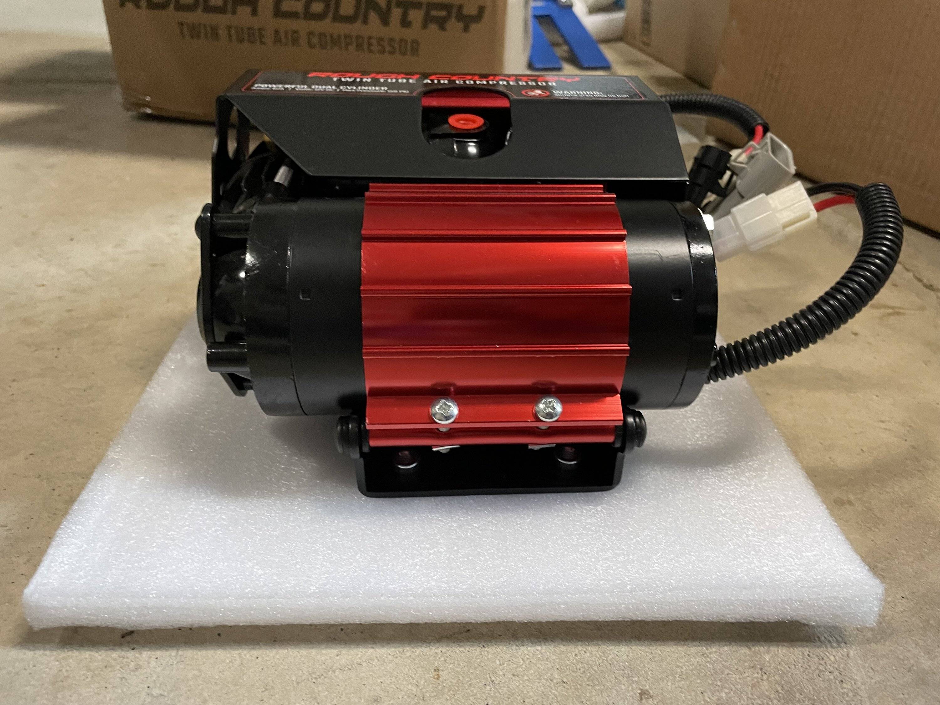

Update:
After contacting Rough Country and explaining the same I posted here, they agreed to send me a new compressor. I was surprised they did not ask me to send the old one in for verification. It did take a few weeks to arrive, but it was also the holiday season so I assume they had some stock issues. No worries.
The new one is different, like the pictures on the website. It has a cover now and a braided hose that exits from the front of the compressor.
Other than that, it seems to be the same. Same mounting holes and harness. I installed it using my old harness and turned it on, works fine. The only issue I have is now my hoses don't connect as they go to the middle of the compressor rather than the front. I have to change some connectors which I didn't have at the time, so I'll have to finish the project another day.
Hopefully this one lasts longer than the first one.
I just saw this. I don't understand why this would cause one of the fuses to blow 1 second after turning it on. Repeatedly. I would expect the compressor to run sluggishly and have a lower output.
They did have different filters on the new one. I used them. I have no idea if they are new and improved or just look different.
