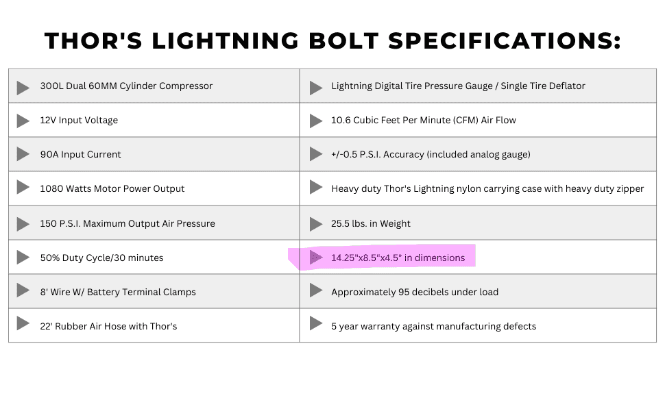

Size wise you can actually fit the Napa or the Thor's Lightning compressor underneath your seat as well. It's bigger but it's not so big that you can't fit under there comfortably.
So at this point the argument becomes:
Do you want to spend more money for less?

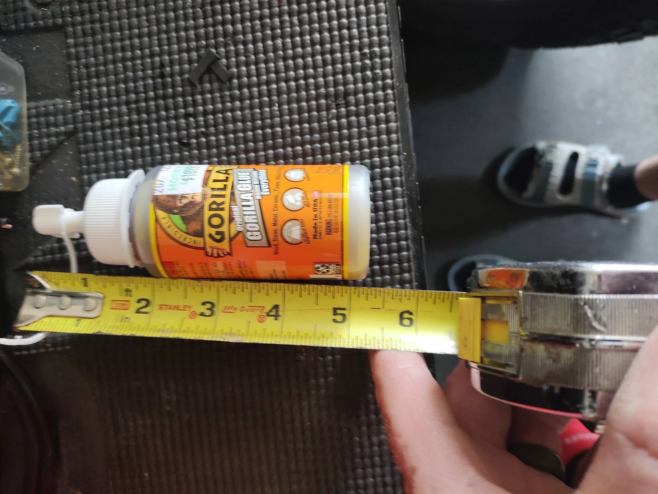

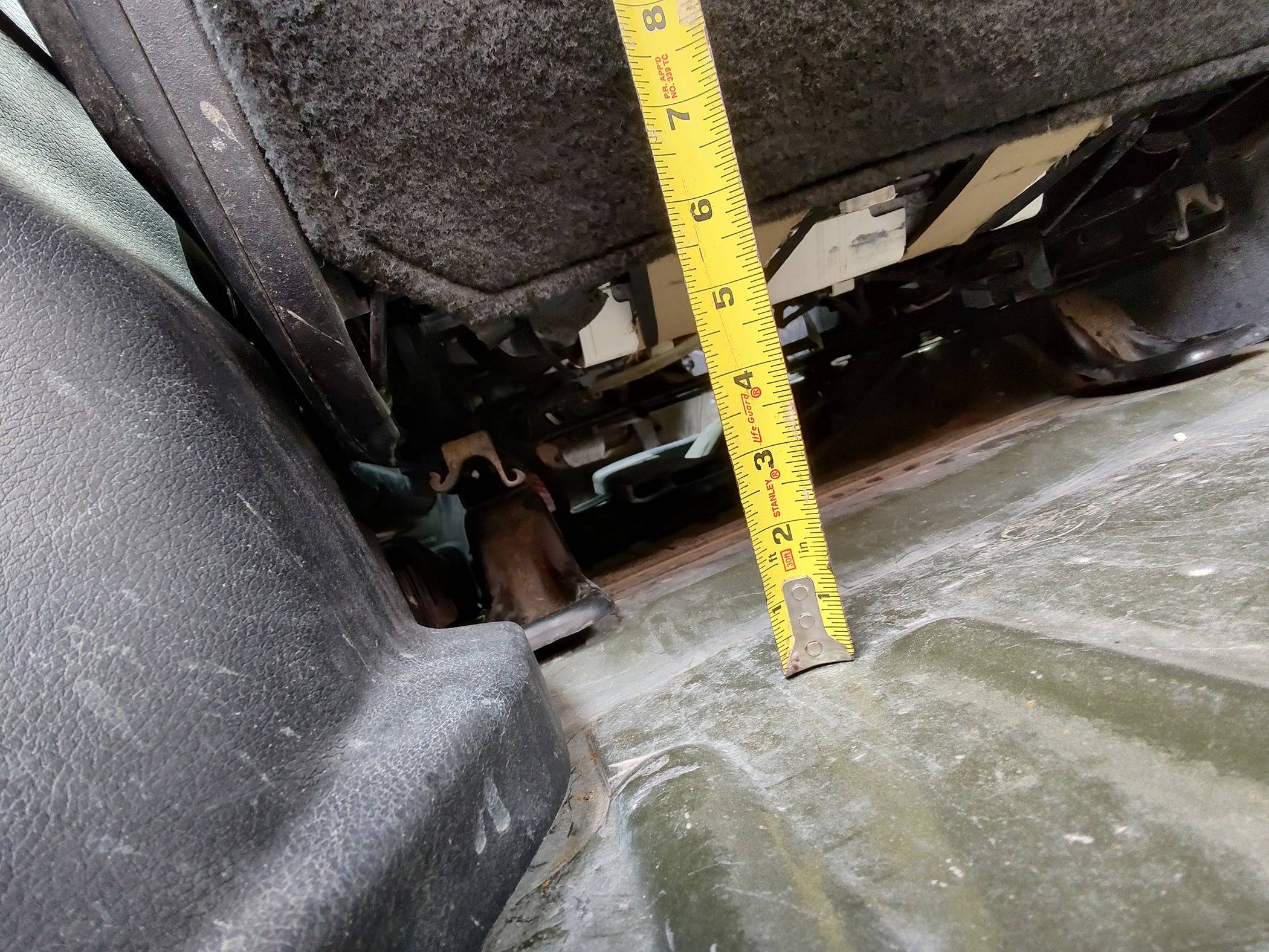

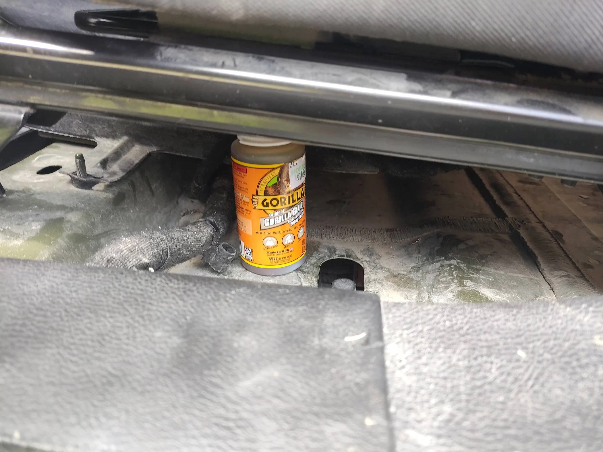

Here, I even did some measurements for you:
Jeep Wrangler JL Rough Country Compressor Screenshot_20240506-155208-057
Jeep Wrangler JL Rough Country Compressor IMG_20240506_155334754_HDR
Jeep Wrangler JL Rough Country Compressor IMG_20240506_155545162
Jeep Wrangler JL Rough Country Compressor IMG_20240506_155640351

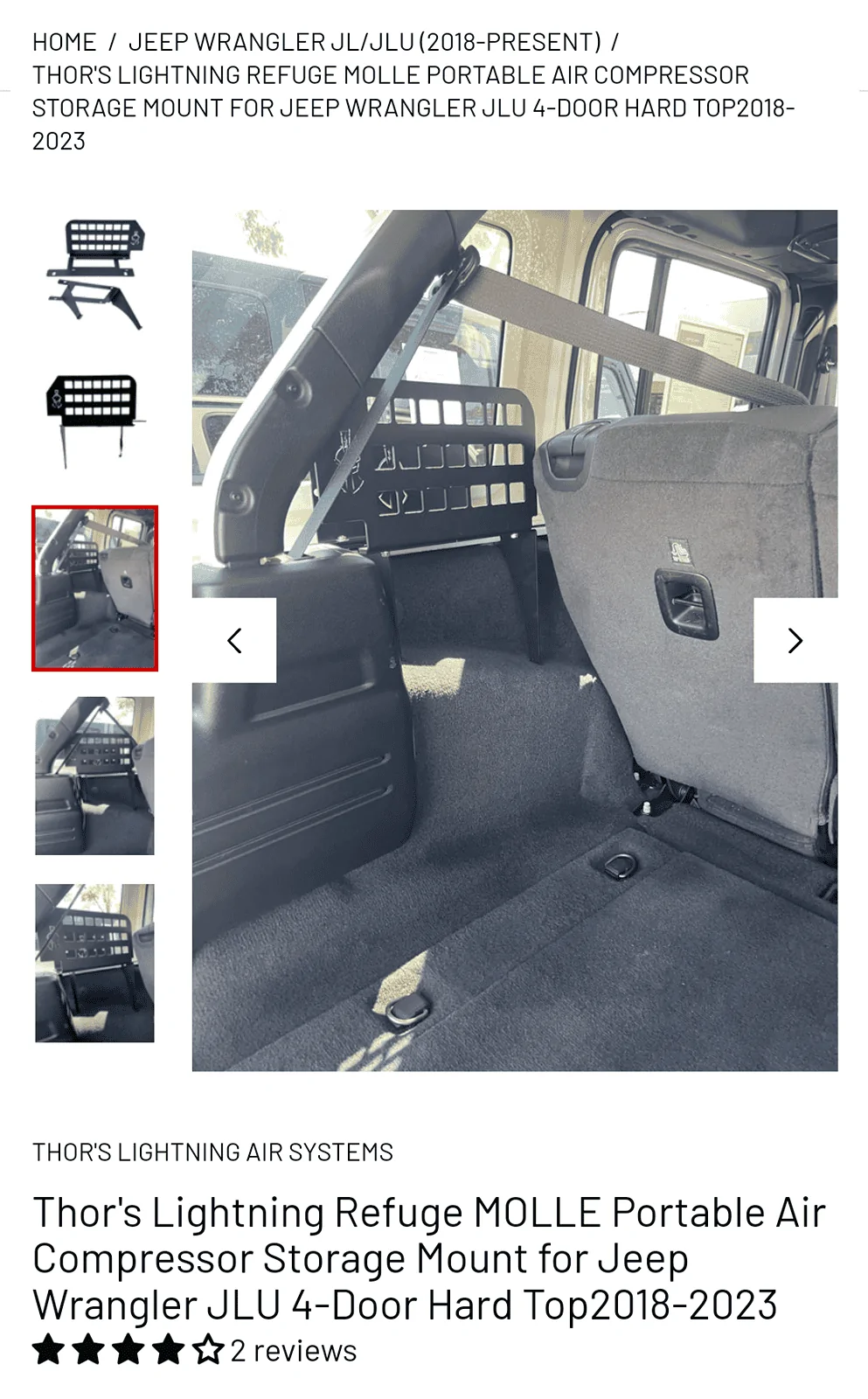

Personally I would make my own mount rather than spending $200 for one of the Thor's Lightning mounts, but I mean teach their own!
Though realistically, mounting it in the cargo area would make more sense.
Jeep Wrangler JL Rough Country Compressor Screenshot_20240506-160237-859

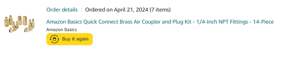

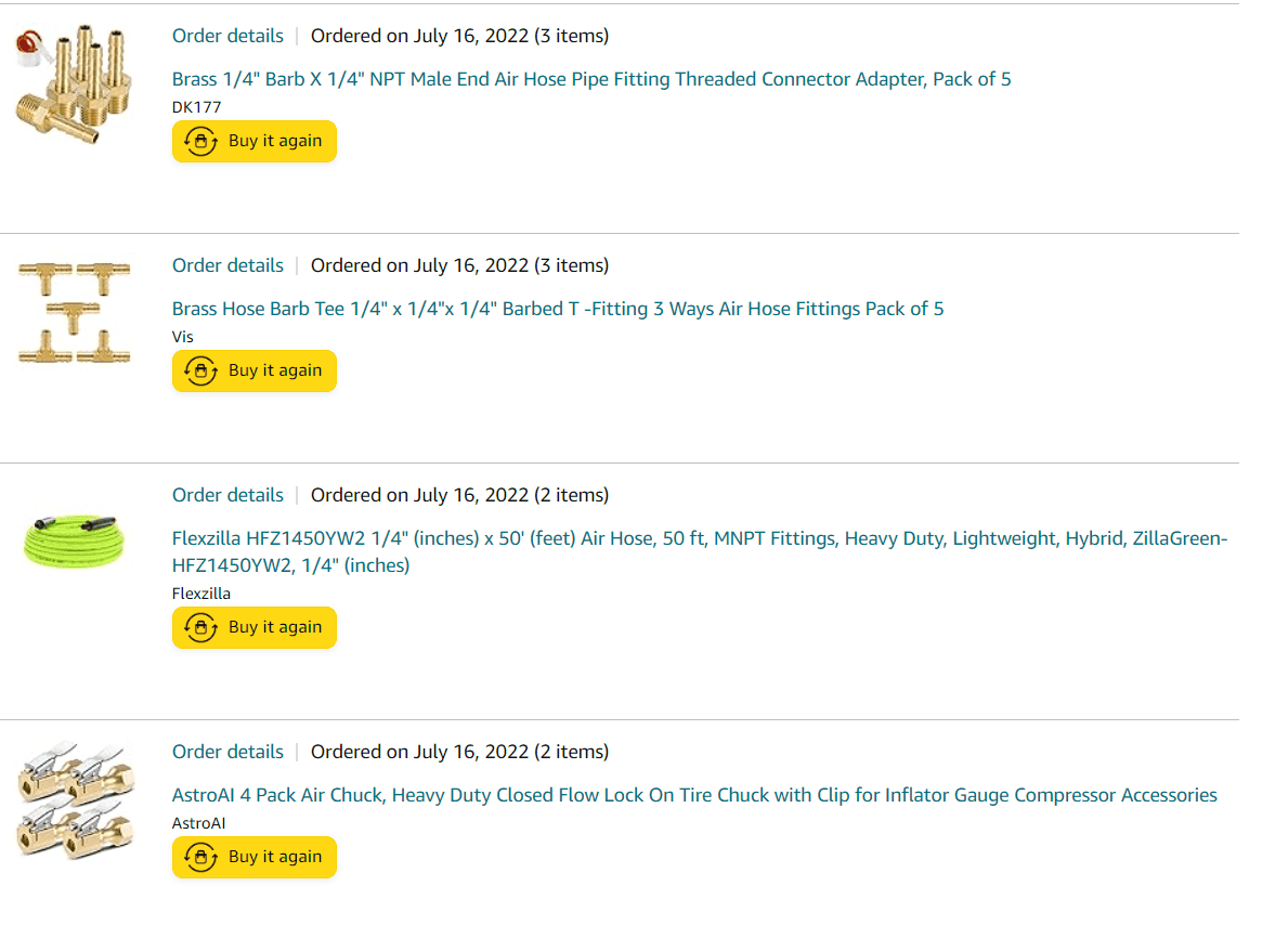

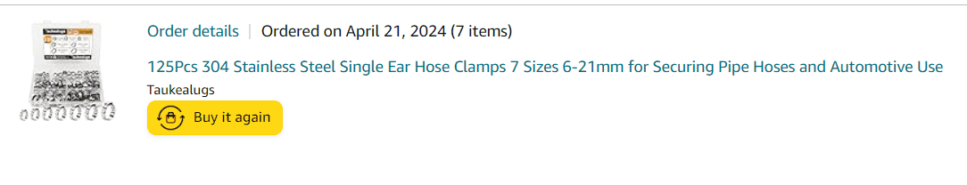

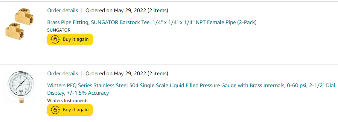

The Napa is the OG. It was branded "Maxi Trac" and came out a few years back and it blew up and was sold out for a long time. There are some weak points and a bunch of videos out there that you probably want to check out for "upgrades" on youtube. Note 300 Liters per minute = 10.6 cfm. There are probably 10 clones out there in addition to the Thor's Lightning, including Up-Down Air, Morrflate, EZ Flate, etc.
Most of those also sell 4 ways, but it's a super easy DIY for around $100. I have my original 4 way and a 2x2-way for my new on-board setup.
Example parts from Amazon:

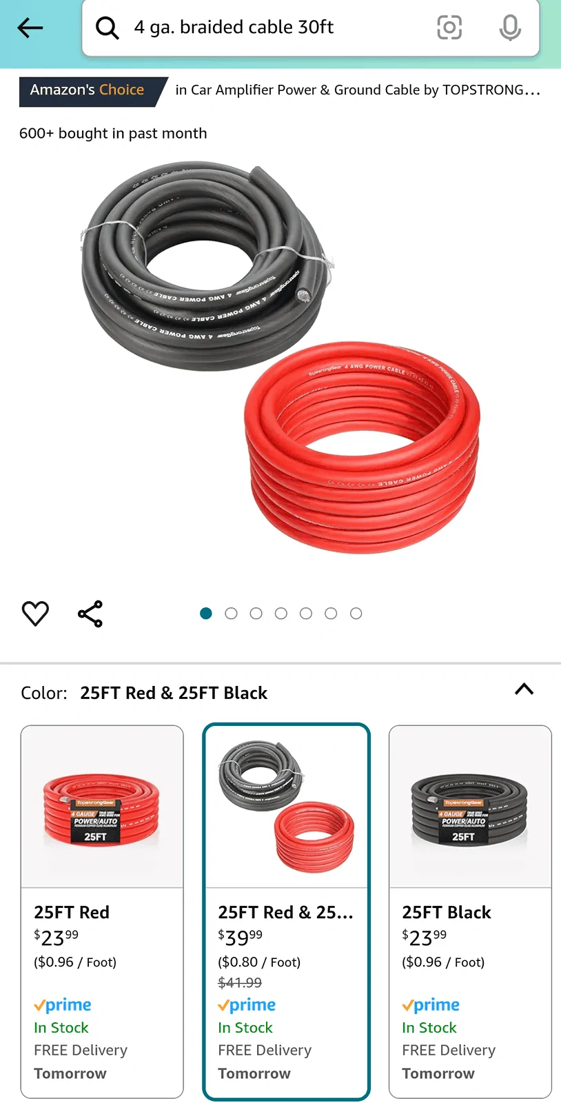

Interesting.
Jeep Wrangler JL Rough Country Compressor Screenshot_20240506-193952-863
Man these guys thought of everything!!!
Jeep Wrangler JL Rough Country Compressor Screenshot_20240506-195016-199
20 ft of 6 gauge copper wiring in that kit specifically for Thor's lightning compressor, with a 150 amp relay for added safety. Only $100. By comparison I found this 25 ft of 4 ga. Braided cable, copper coated aluminum for about $40 bucks on Amazon. I don't know, it's a bit more money, but the kits all there, kind of makes that $100 kit worth it.
Jeep Wrangler JL Rough Country Compressor Screenshot_20240506-194653-352
I feel like we're getting a bit away from the point here. Legitimately, it's a Wrangler you could spend a fortune on this thing do this whole setup for crazy bucks, air up in 5 minutes air down all at once with the same kit, I could see someone easily spending $1,000 with Thor's Lightning between the mounts, the compressor, the air systems, etc.
Personally I just plan on getting their four point connect system for the $200 bucks and at this point I'll be purchasing the Napa compressor for $150. I don't carry a lot so this really no point in me trying to mount something. I'll be adding some storage containers on the roof rack here before too long, I'm sure some of this stuff will go in those containers when I do hit the trail.
But legitimately all you actually need to do this system is the Napa compressor and the Thor's Lightning multi-tire kit, for a total of the same price of just the ARB dual compressor.

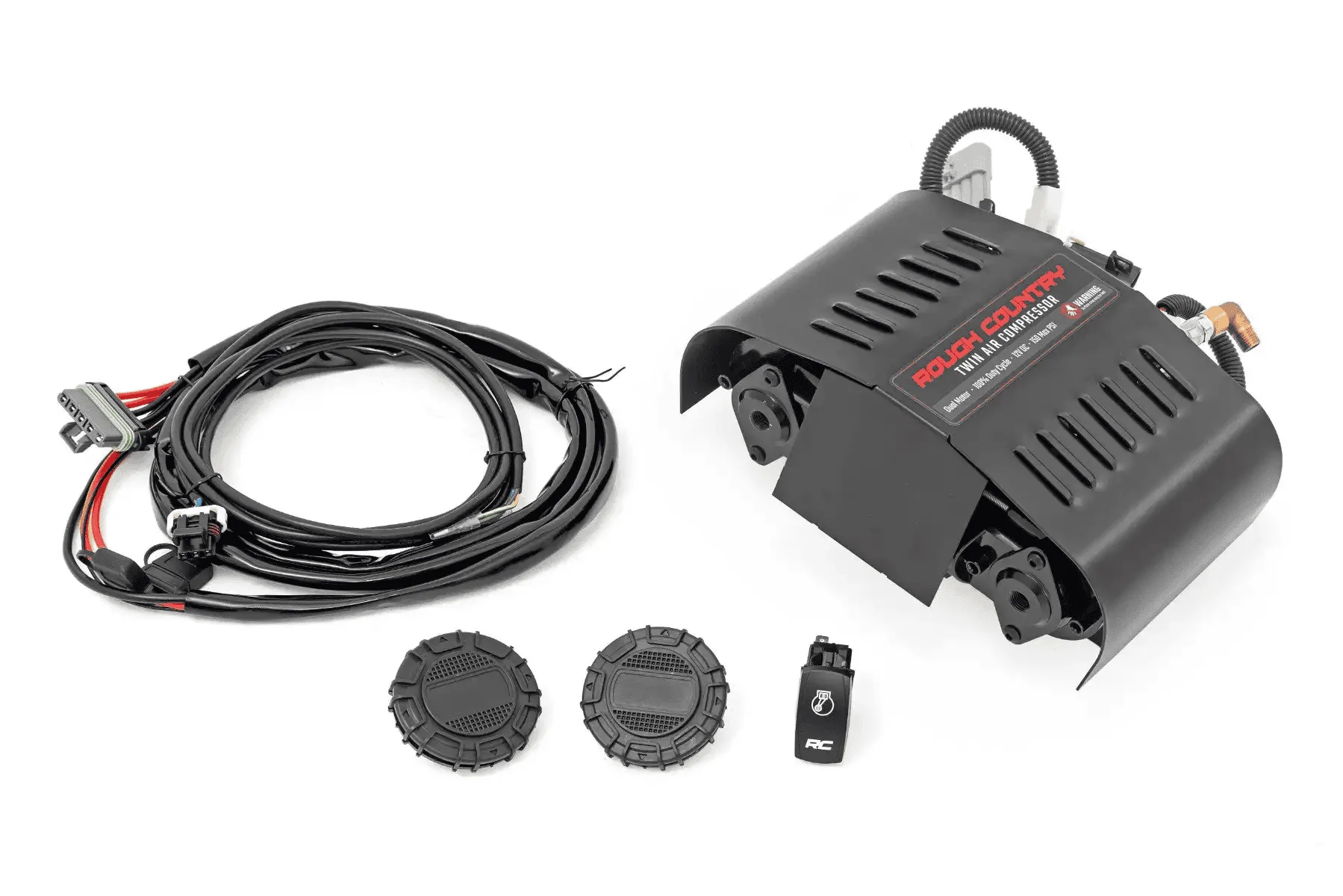

My ARB just showed up, still in the box. Any opinions between the RC and ARB? If I can save $300 for more toys, the ARB is going back.
It looks like they changed it pretty substantially from the initial release version we have. Doesn't look like as much of a straight copy now.
