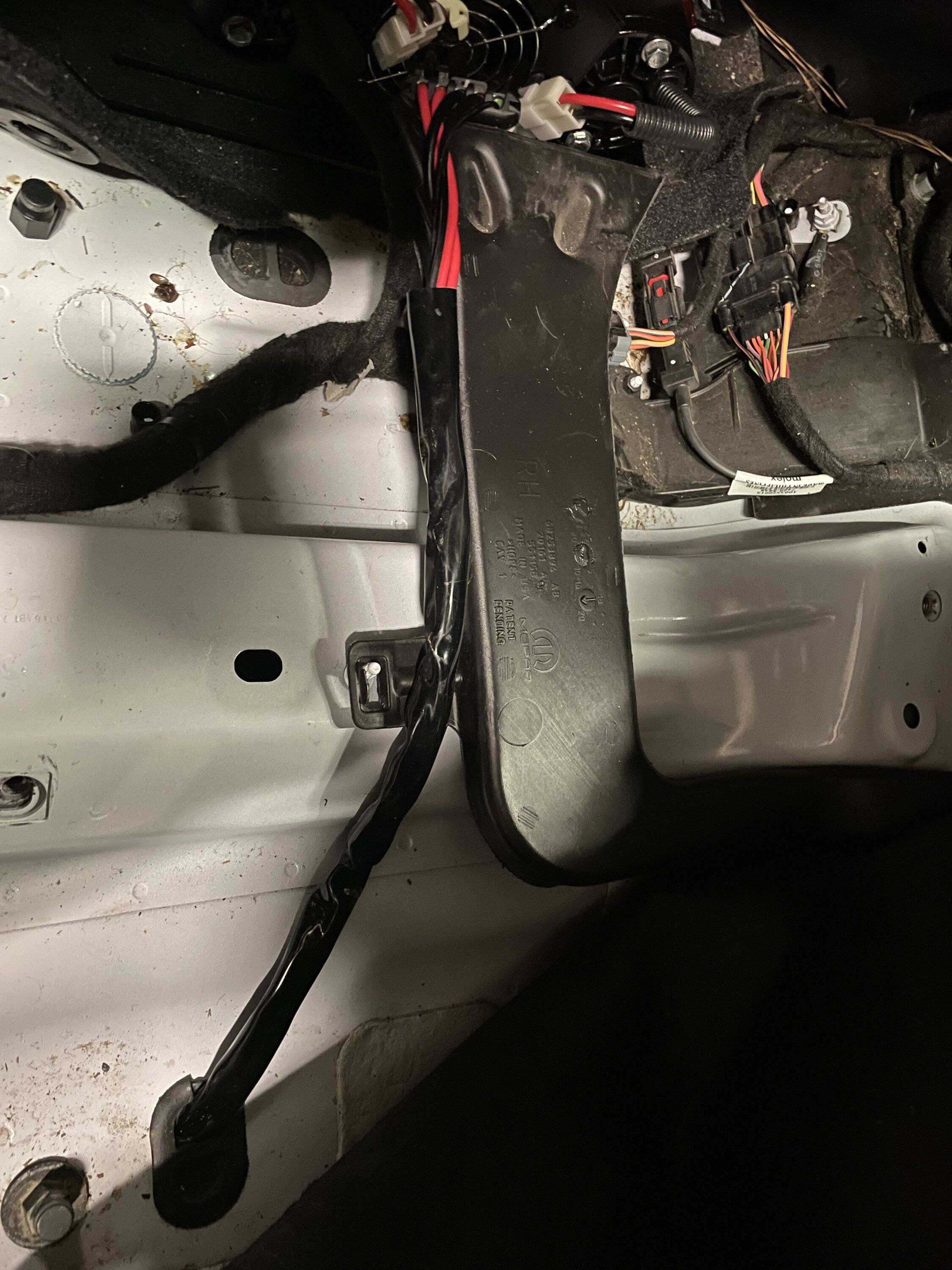

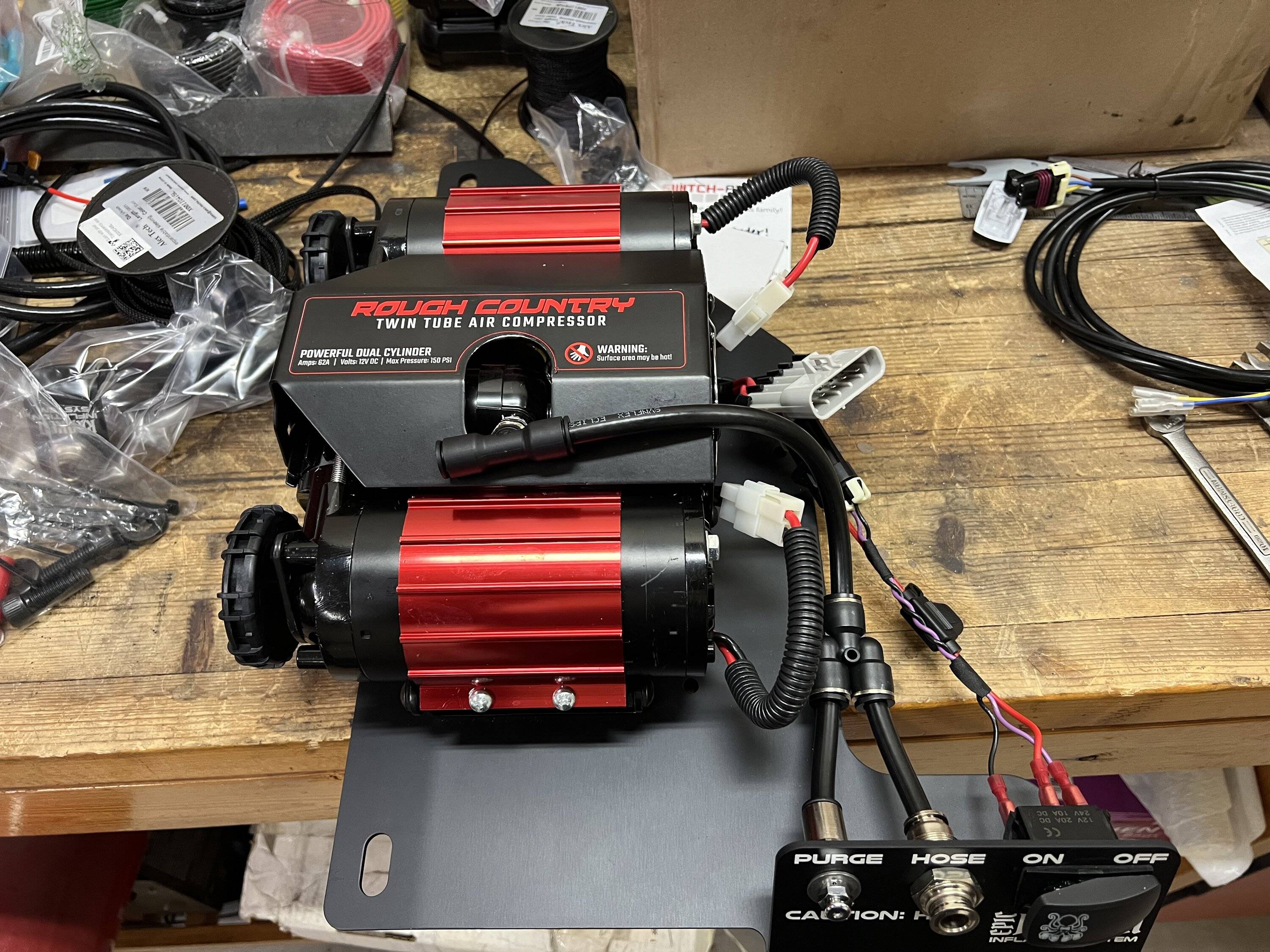

Finally getting around to starting the install late this evening. Went with @813 Fabrication & Design ’s underseat setup.
Fuse setup is different, we’ll see if the harness length can reach.
I’m cleaning up my other wiring with 813 accessory panel, so probably won’t wrap up till tomorrow.

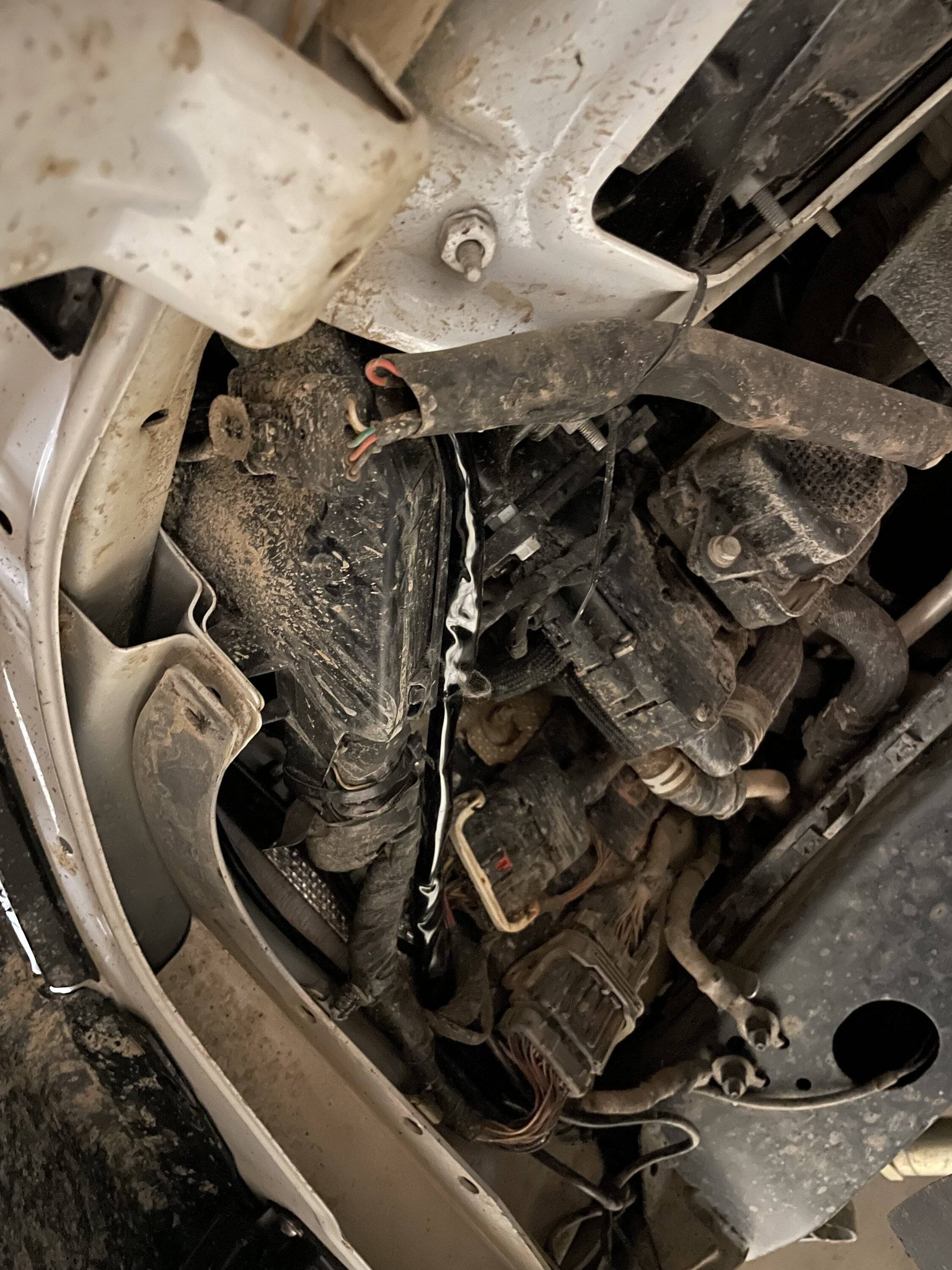

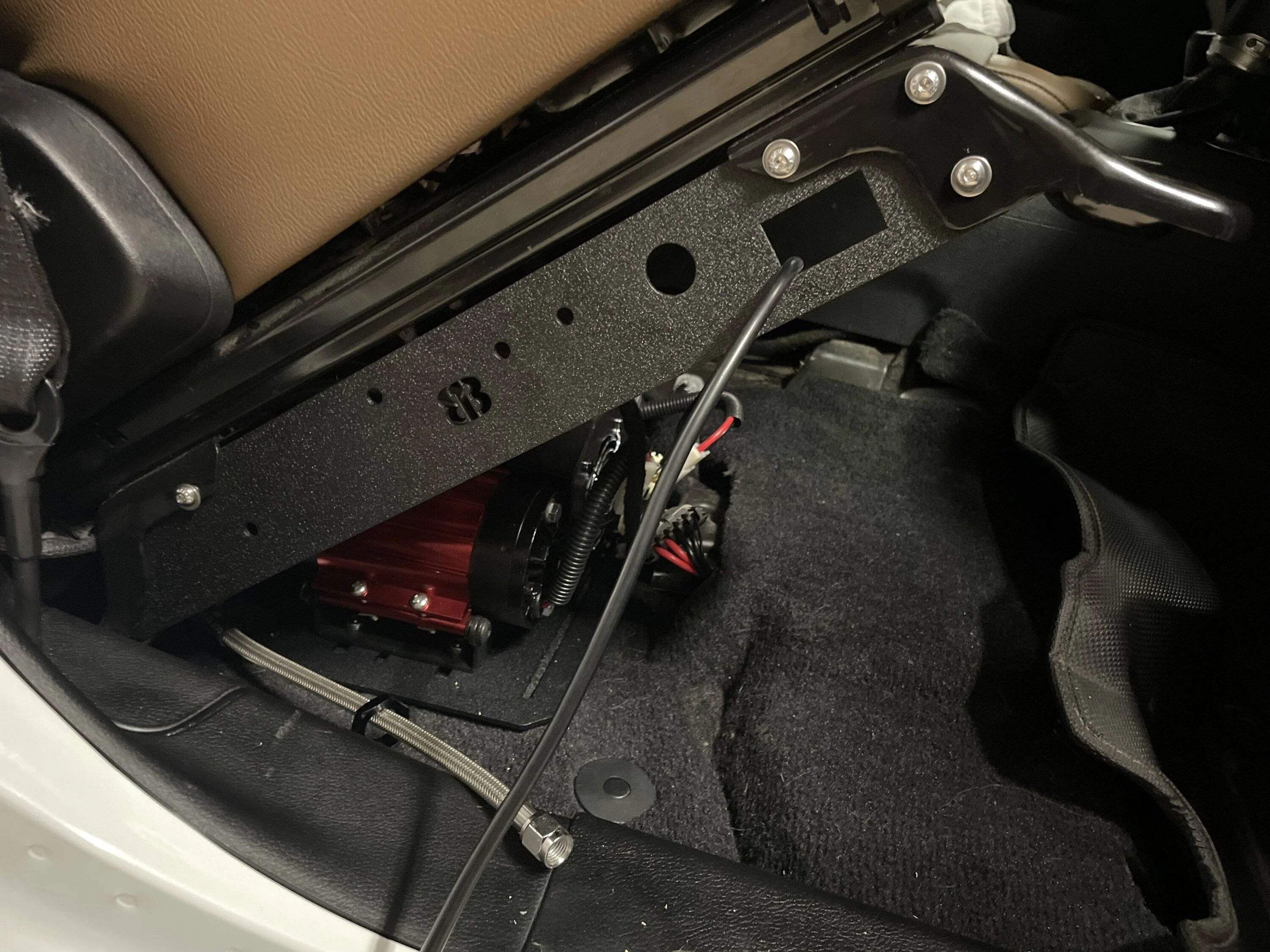

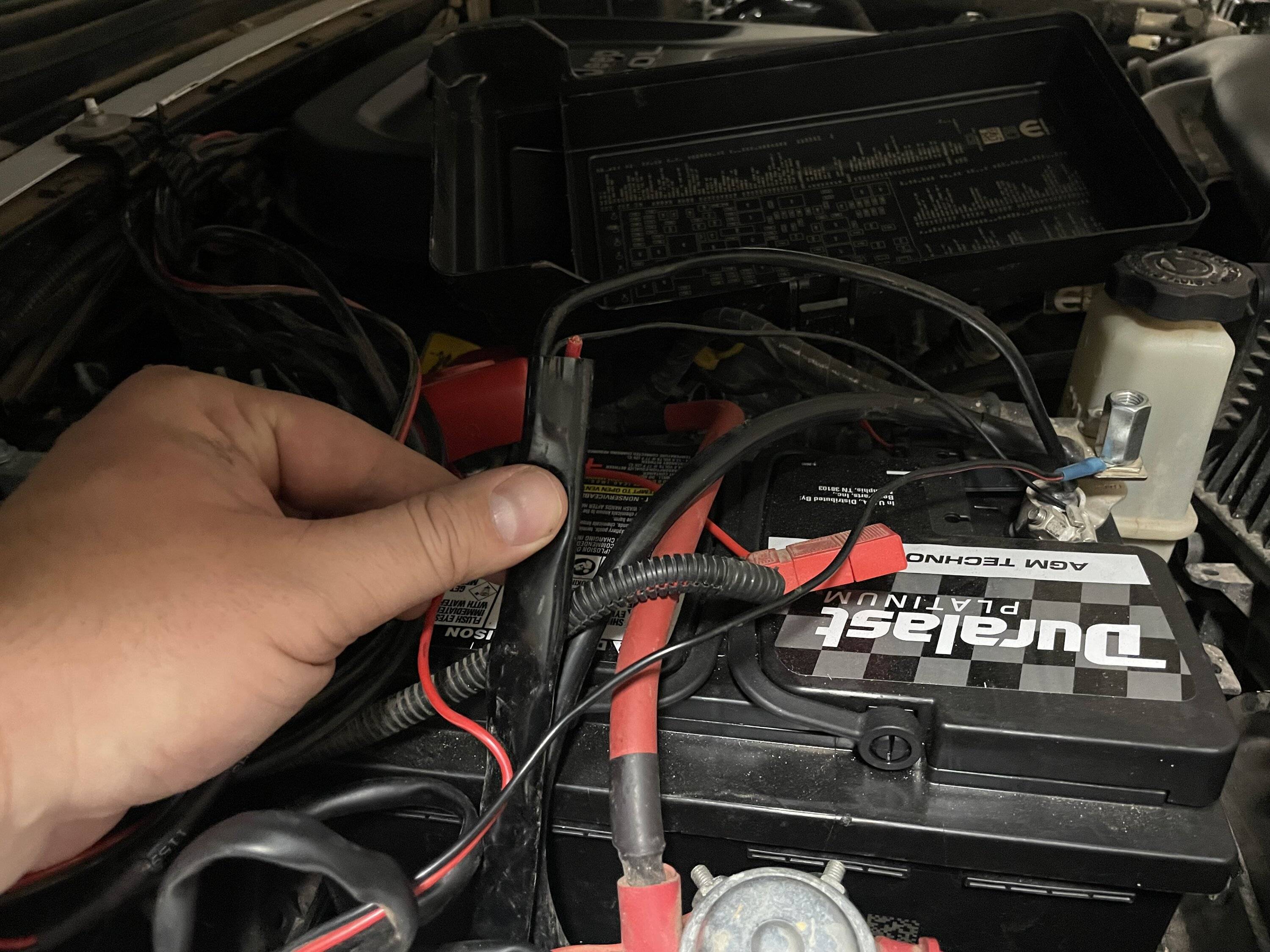

Pulled the inner to run it, and it’s just long enough to make passenger seat to battery. I chopped the fuses because I’m not running straight to the battery, but they only add about 8” with the included wire.

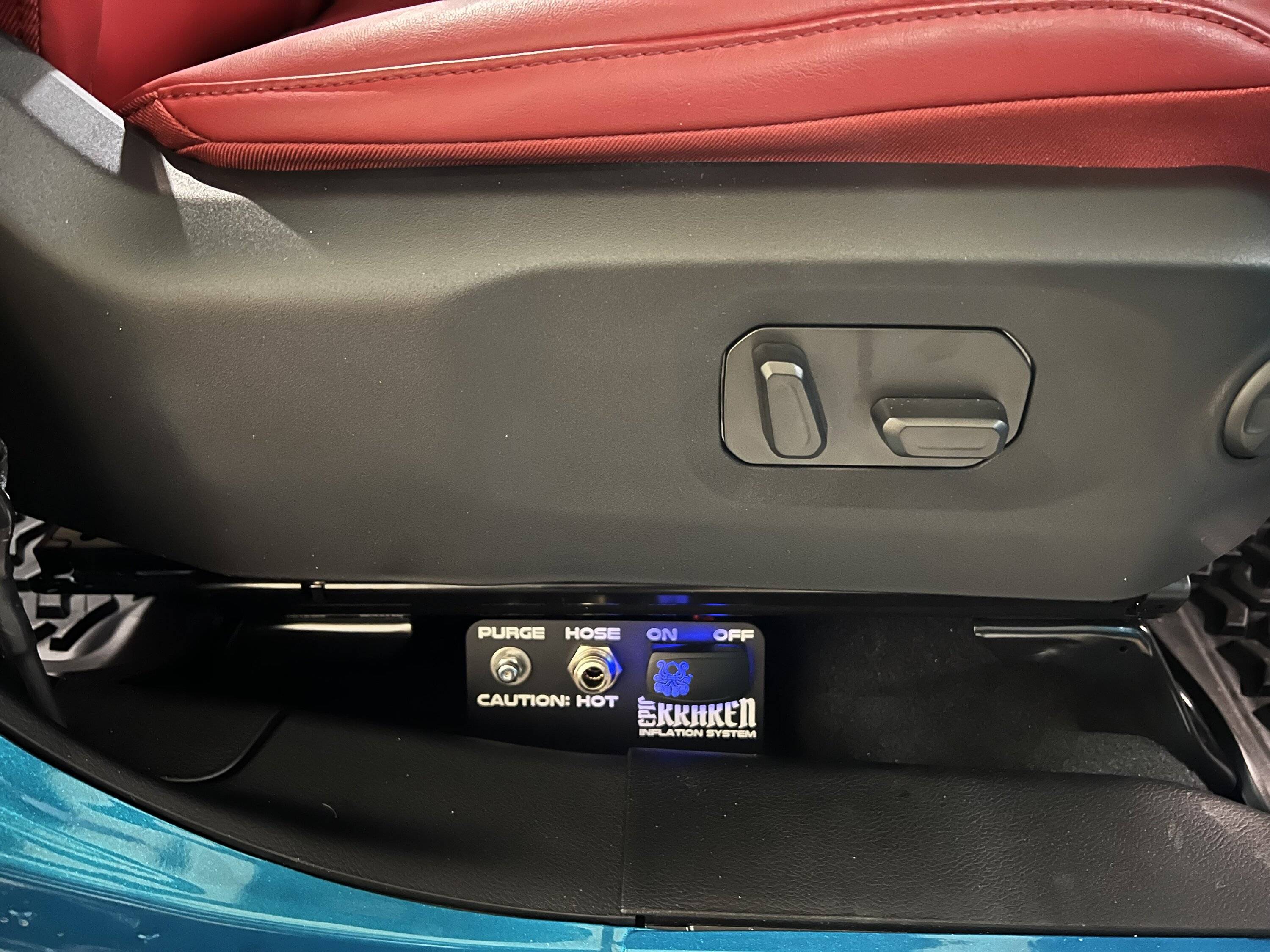

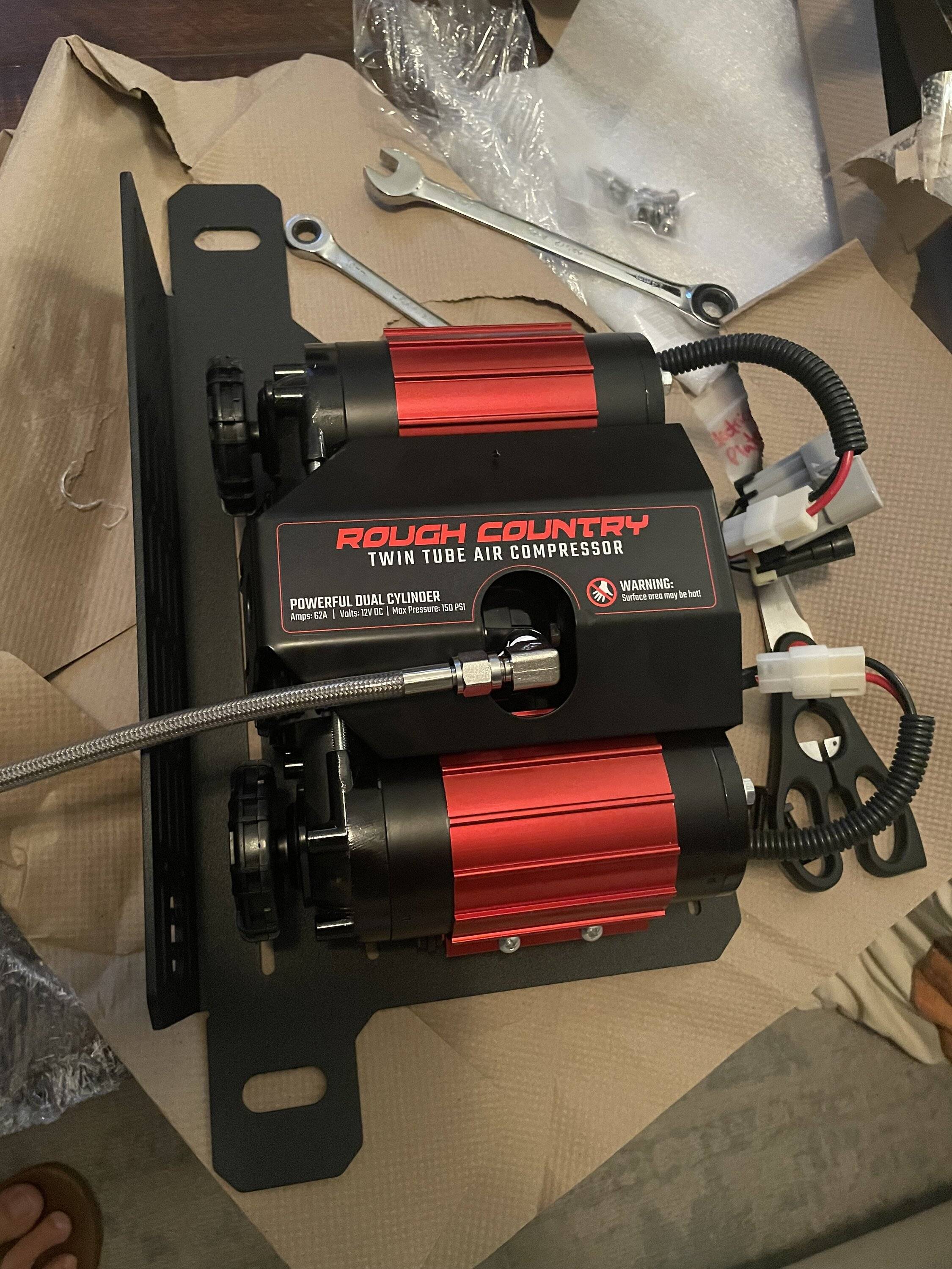

Got mine installed today. Few minor differences. I used the Epic Kraken underseat mount. Not my first choice, but it seems like the only interior mount that fits the new '24's interior. Like GatorB8 said, the included M6 bolts were too long, 30mm. I got some 16mm ones at Home Depot.
The Kraken plate did not exactly fit the RC compressor. Holes were precision drilled, no slack available. One dimension was about 1mm off, the other amount 3mm. A step bit and die grinder made quick work of that.
One thing did not fit was the switch. That I was surprised about. I thought all those switches were the same dimension, I got them with my ARB lockers back in the day. The Kraken cover fits fine, but the switch didn't fit in the hole. Again a few minutes with a file took care of that. Compressor installed.
Jeep Wrangler JL Rough Country Compressor IMG_8540

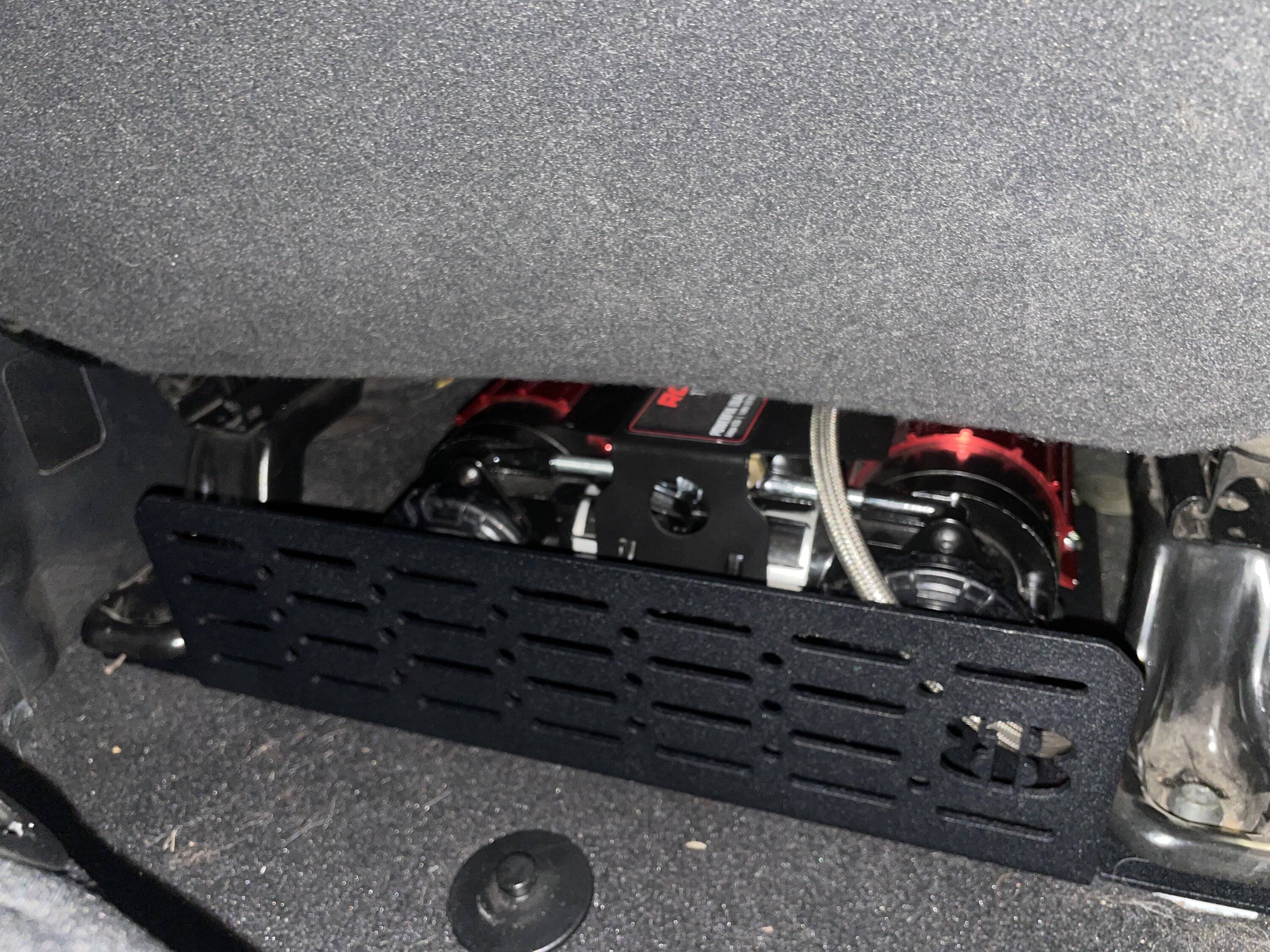

Fit it under the seat. Tight fit. There is a bar in the center of the seat frame that bumps into it when the seat is fully back.
Jeep Wrangler JL Rough Country Compressor IMG_8543

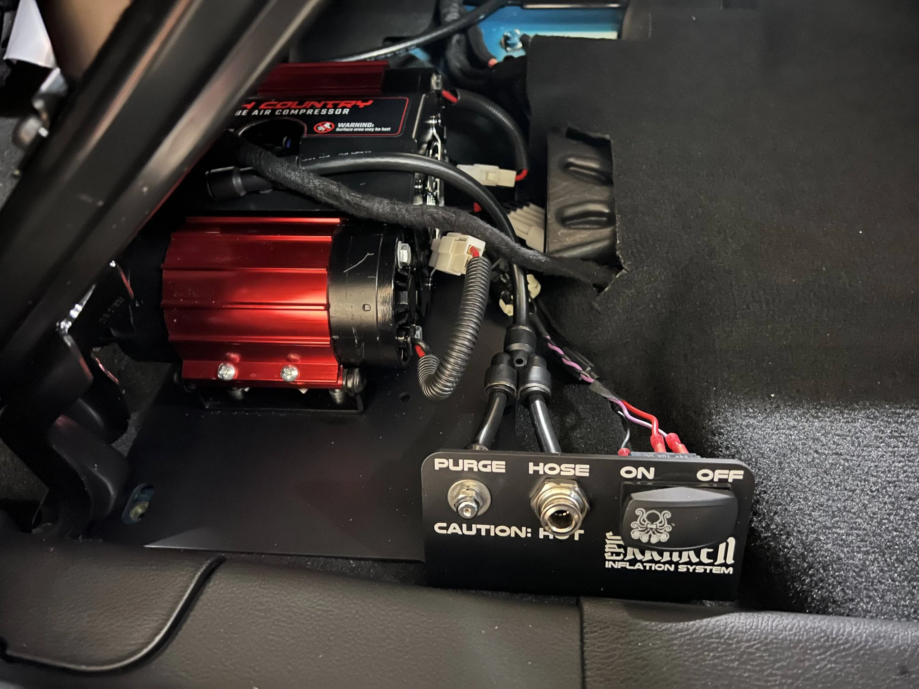

Seat installed. Not liking the blue light, that is going. Luckily they installed a 5 amp fuse on the power line to turn it off.
Jeep Wrangler JL Rough Country Compressor IMG_8547
The power line just fits, with about 6 inches to spare on my 392. With my old 3.6 it probably wouldn't have made it to the battery and would have to be extended. It was much simpler to deal with than the ARB harness I installed in my '18, only a power harness and a switch. Didn't have to deal with the wiring for the solenoids.

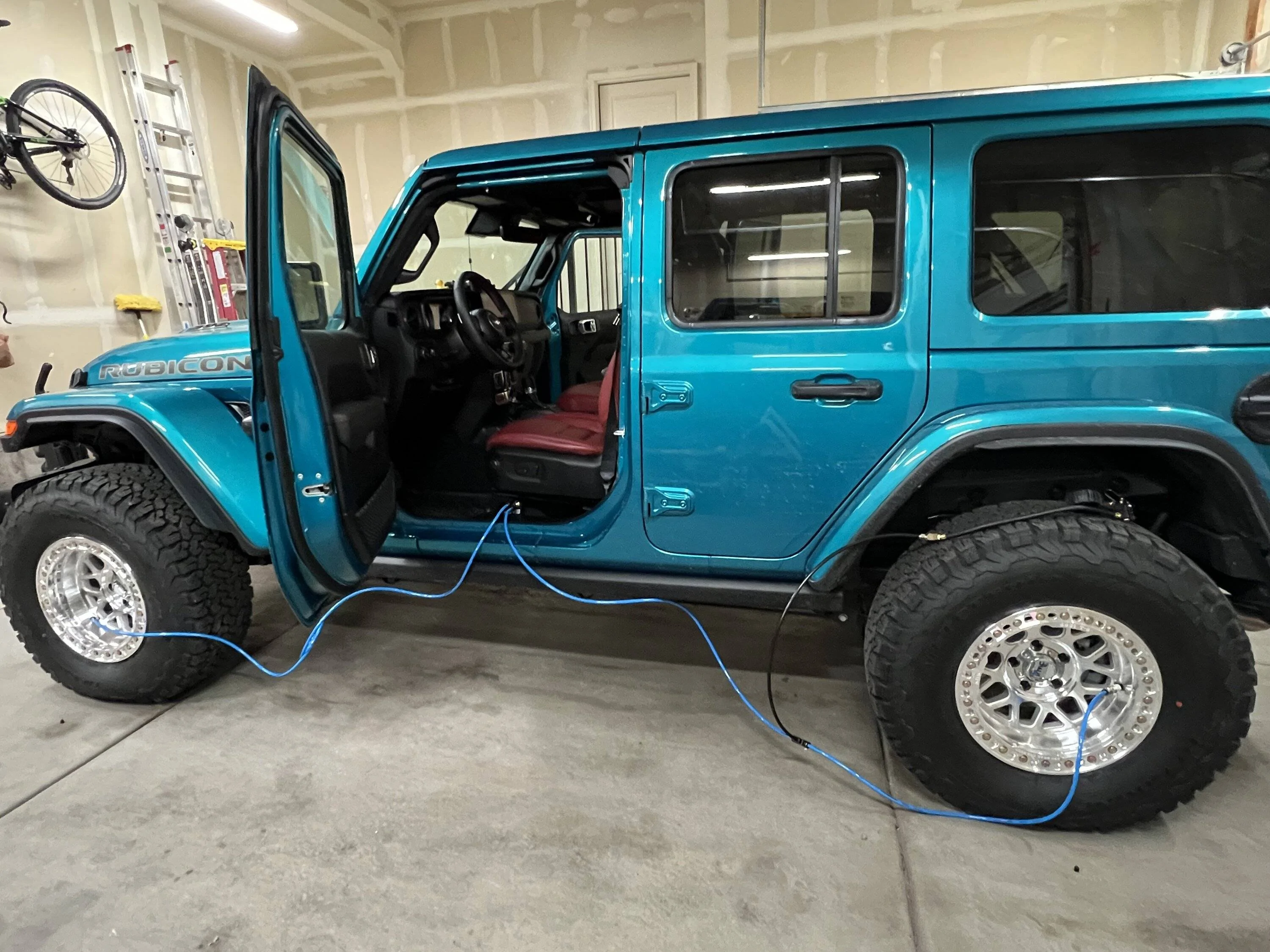

Takes 7.5 minutes to air up the stock 35" BFG ATKOs. I aired them down to 12 psi (they had a good bulge) and up to 32 psi. Not the fastest, but respectable. I also spliced in an air gauge to watch the tires air up and down in real time.

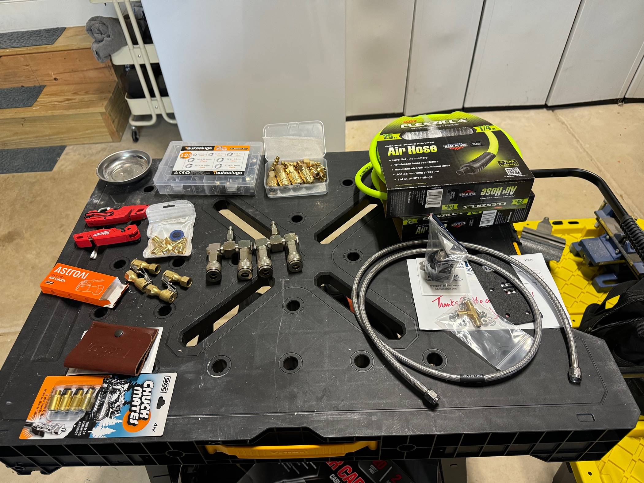

Tonight’s project:

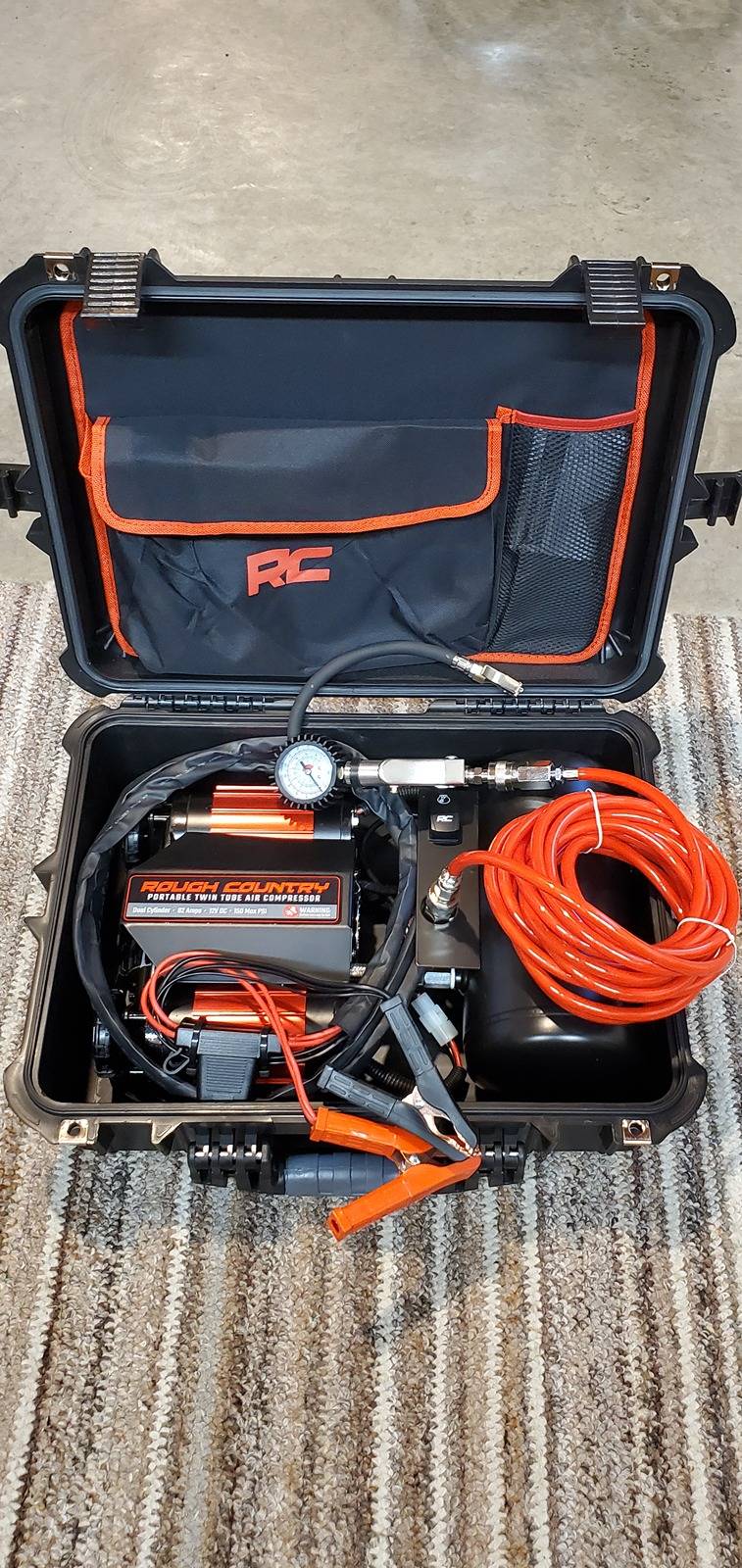

I bought a RC portable twin compressor a couple months ago when I couldn't find a mount for my twin ARB that suited me for our '24 Rubicon. I've since mounted the ARB with a Grimm mount and now have no use for the RC portable compressor. It's never been used and I need to list it in the marketplace on here and try to sell it. It does look pretty nice.

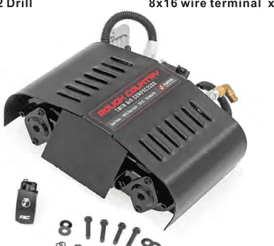

Stumbled across something interesting when checking the wiring diagram on RC's site (I swapped to an ARB switch to get rid of the always lit LED). They've completely revised the twin compressor to look nothing like the ARB. The bones may be similar, but who knows now:
