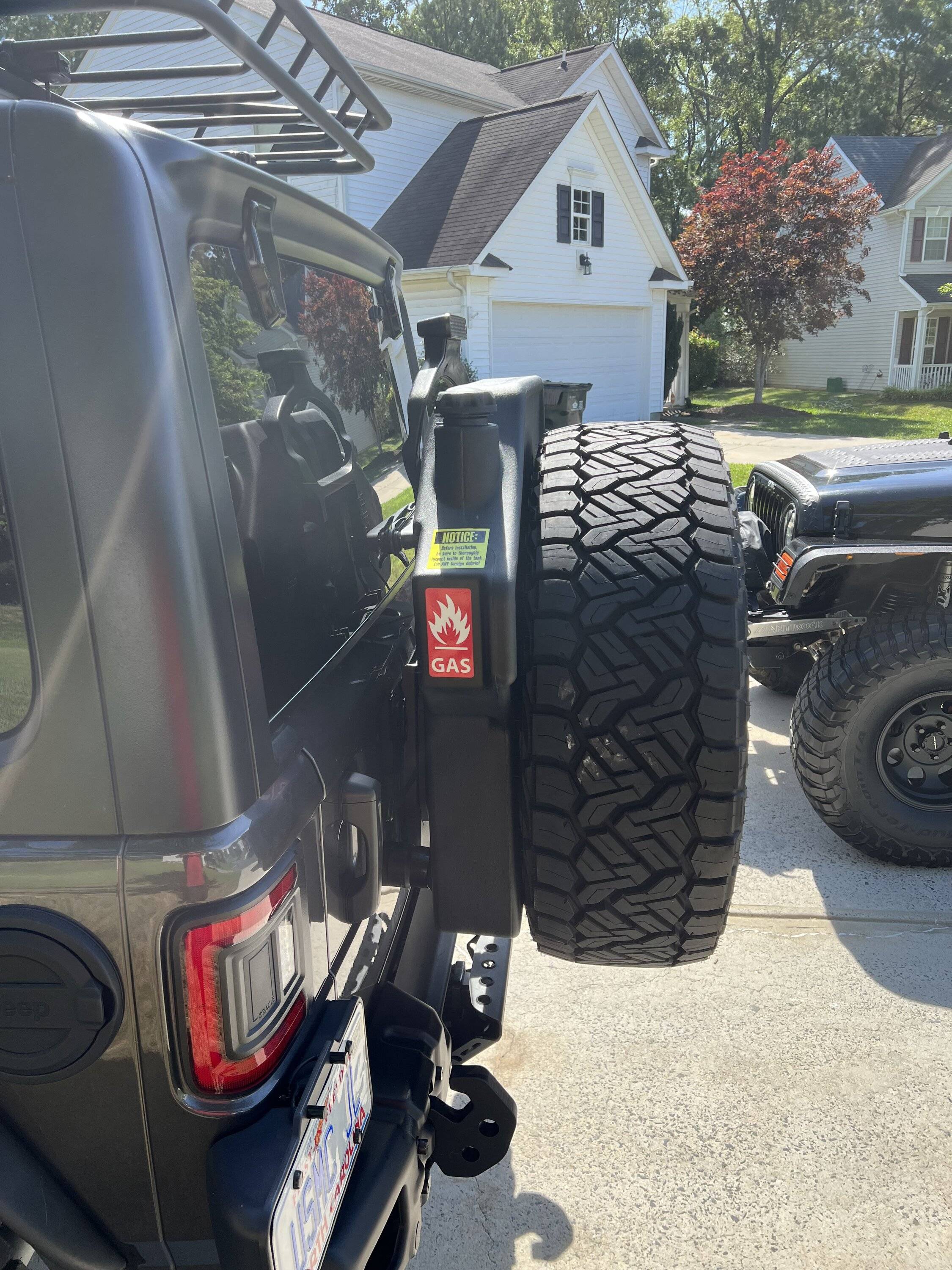

I have this on my 2 dr with stock carrier and reinforced tailgate. No sagging and 35’s. if you want to keep your rear camera they have a kit too.

This interests me. Are you running stock or heavy duty OEM hinge? Have you run around much loaded with fuel? That’s quite a bit of weight to add to my already stock OEM hinge as I have 315 tire and a somewhat heavy door table already stressing it.

Man, that would make me nervous after adding in 100 pounds for the full tank (~66 pounds for the 12 gallons of gas) plus pushing the weight of the spare out that far. Those hinges had better be incredibly strong.

Yepper me too, 100 lbs. So far so good around town for awhile now testing. Heading out to white rim so I’ll check back then. Tailgate reinforced and a 35” tire. Pretty solid right now. ??‍♂

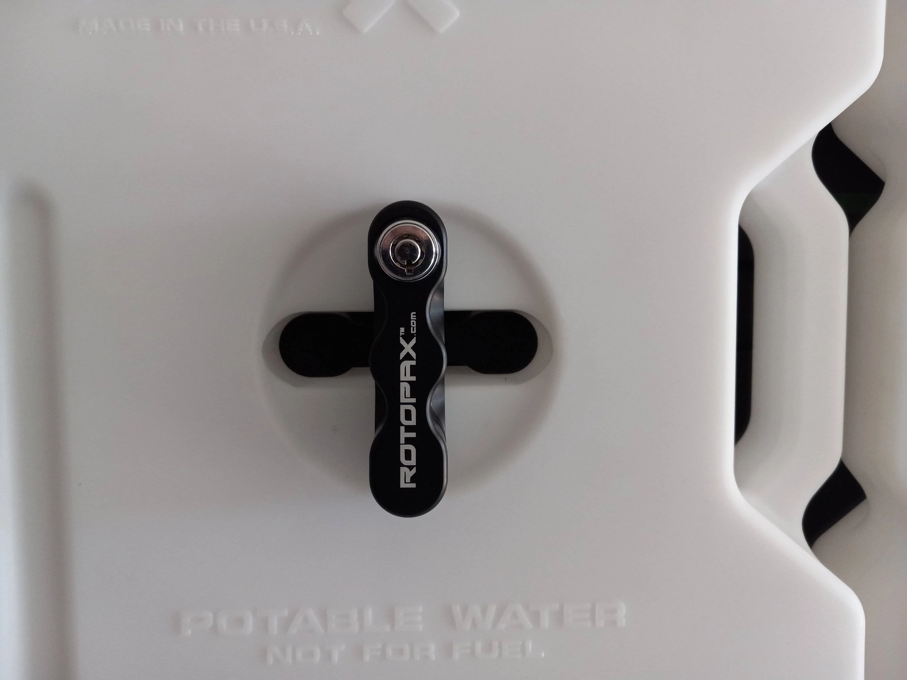

With the RotoPax locking mounts getting the cans and rack off the JL would take a bit more time than a thief would want to spend. There's that and the fact they need to be carrying some tools or be prepared to damage the rack, the cans and the JL trying to pry the assembly off.

Michael, do you notice more road noise with paxs installed?

Not really, Mark.
It sounds a bit different with them installed but the wind noise is not louder nor is it obnoxious.
