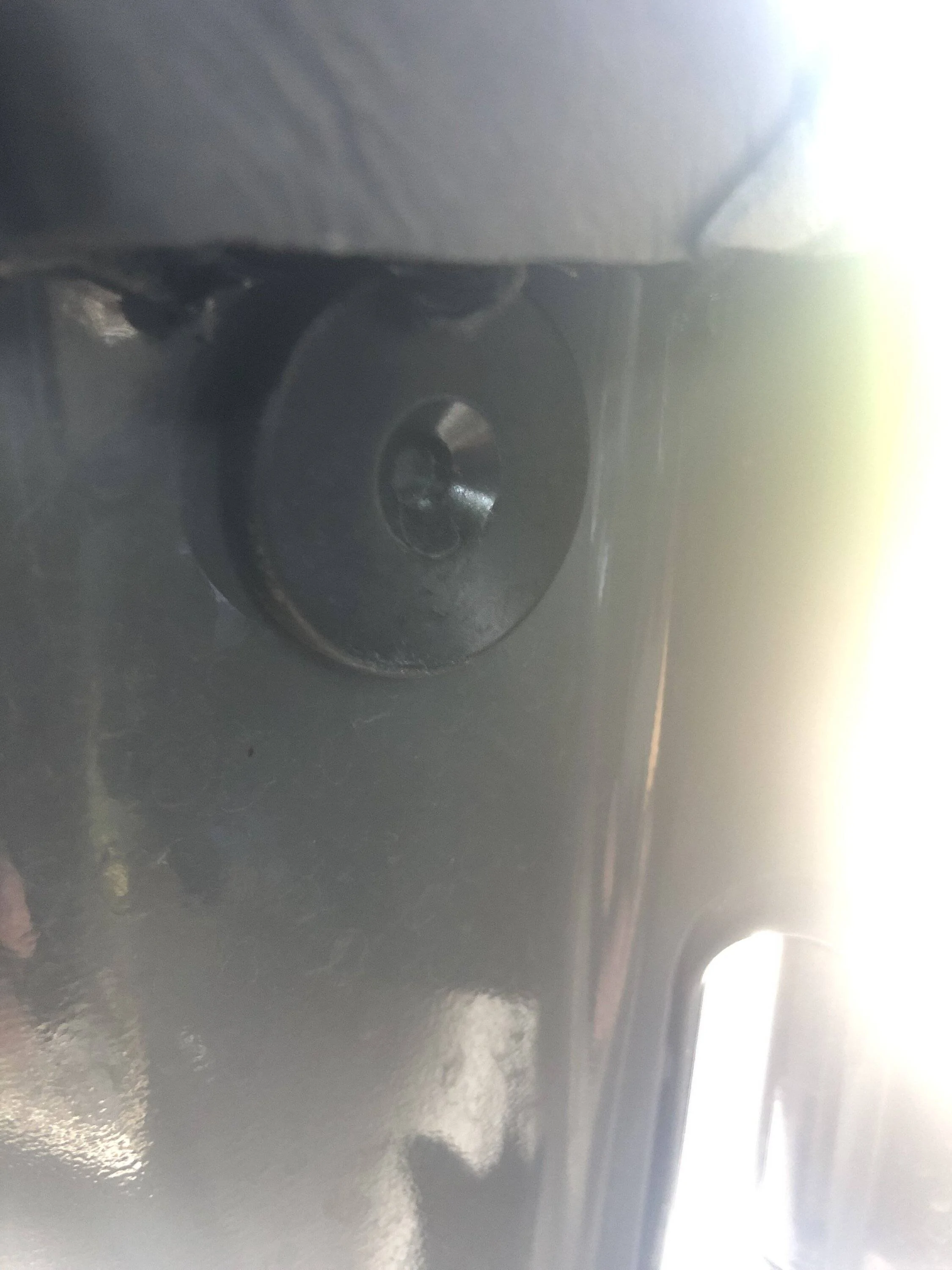

The magnets I linked don’t come with adhesive. I used a screw. I moved the original smaller RSE magnet too many times and the double sided adhesive failed. Of course I found the original magnet after purchasing the newer magnets. You could use some strong 3m double sided tape if you don’t want to drill.

The steps are fixed for now, i’m going to outline the location of the magnet and use the magnets I purchased from your link when they come in.

Fun fact. The doors on a Jeep JL are aluminum which makes attaching a magnet without a screw or some sort of adhesive problematic.
edit: @Nuke_392 beat me to it
Very true, that’s why I bought the magnets with screws

That is a fun fact. Magnet st8cks to the latch beneath the aluminum door skin. Ask me how I know. Lost a few on the trail and now have magnets on my pillars. Pro tip. Lol
