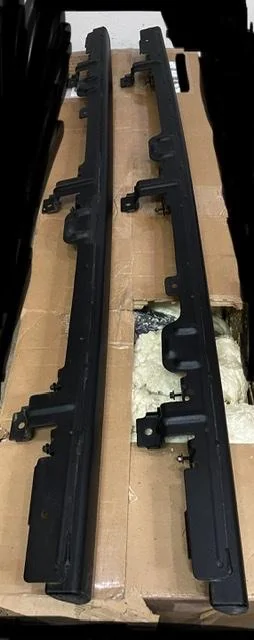

Be careful if removing bolts from the frame to install sliders. I have heard many stories that the forward bolts have a tendency to break off that will require major work to fix. I took mine to the dealer so if they broke them they would have to fix.
Thanks. If I heat up the bolts with a propane torch will that soften the loc-tite?

I just ordered a 2020 Willis version (2 door manual). It comes standard with rock rails, but my wife, who is short, wants nerf bars with steps. I don’t think I need the rails since almost all of my off-road driving will be forest trails - no rocky terrain around here. Are the rock rails just bolted on and easy to remove, or are they welded or otherwise attached?
I believe there are 3 bolts on each one, simple removal. Be careful, even the stock ones are heavy.
I just did this yesterday. I heated up the front bolts with a torch for 5 minutes before trying to get them off. Then I worked them a little back and forth before really wrenching hard. They still may a couple of noises that scared me, but they came off. One of the back ones also made some racket so I heated that one up too. I think the problem with the ones that broke off was that they were cross threaded by the factory. I love the look and not having to drill.
