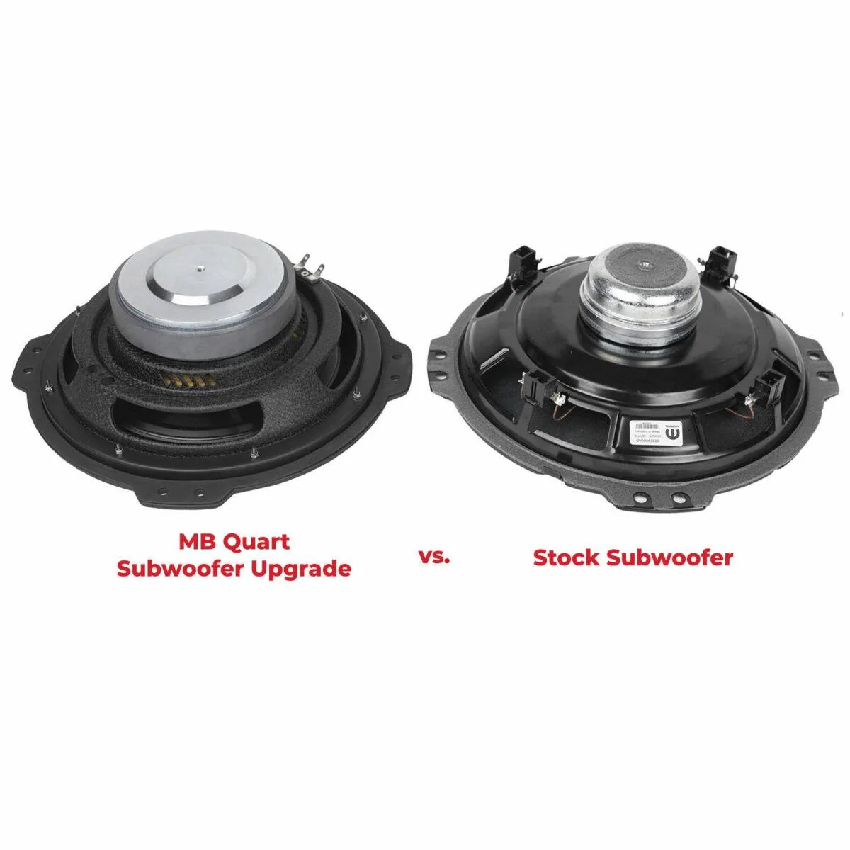

More OEM amplifier information for reference
I've also noticed the 2-door's magnet is significantly larger than the 4-door, and looks closer to something aftermarket sized. I would bet it's rating is more than 200W.

4-Door:
Jeep Wrangler JL Rewiring stock Alpine sub MB-Quart-JL-Sub-MBQJL-SUBR-1-6-e1673972010598

As another option. The MBQ system uses a combination of their similar powersports amps. The Alpine replacement sub is powered with the NA2-400.1
https://mbquart.com/shop/marine/marine-amplifiers/na2-400-1-nautic-400-watt-amplifier/

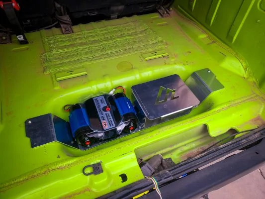

Sorry to keep spamming this thread, but I thought of something else that could hurt the 2-door JL's subwoofer performance vs. the original JK design: the cubby is stamped metal in the JK, while the JL is a plastic tub. In the first video above (@13:25), there's reference to the foam padding on the underside of the enclosure and how important connection between the enclosure & body is... which the JL doesn't really get.
JK - continuous metal body:
Jeep Wrangler JL Rewiring stock Alpine sub Jeep-JK-Cargo-Compressor-Mount-1-533x400
JL with cubby removed to show (lack of) structure
Jeep Wrangler JL Rewiring stock Alpine sub cecc1fa4-1532-426f-b38f-7c3a75a479f3-jpe
JL foam padding (with my added sound deadening). The foam is apparently designed to compress against the body for a more rigid connection.
Jeep Wrangler JL Rewiring stock Alpine sub pxl_20230820_224841325-
