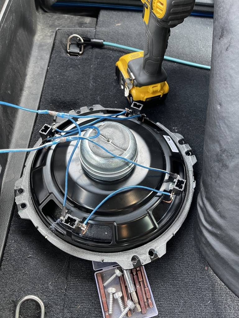

In my quest to get a sub to work with the MB Quart stage 6 this is the solution that I have found until Quart releases their own drop in sub for JLU's. The sub is 4 voice coils with 2 ohm impedance to each coil. I have been using it this way with a Quart 400.1 amp for about three months and I am not easy on it. The picture shows how you would wire it or you could use the factory plug but I cut that up when I tried out a JL 10TW-3.

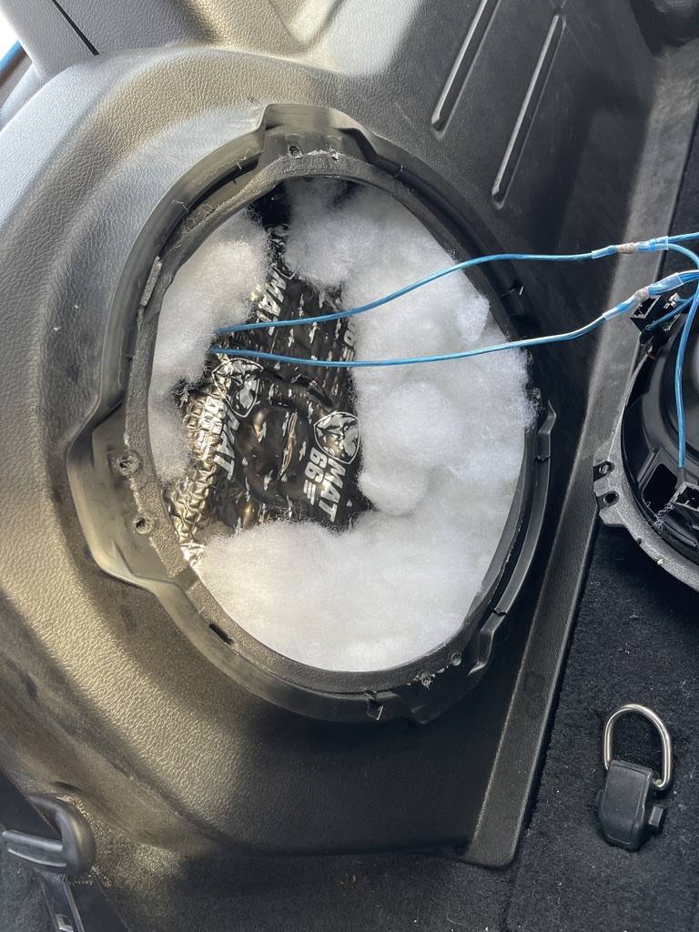

Any noticeable change with the mat and poly in the enclosure?

It seems a little "tighter" that my wife's stock Alpine in her JL. I also have the bass knob wired in so I can move it up with the old classic rock that I like. The bass rolloff on older stuff us significant.
