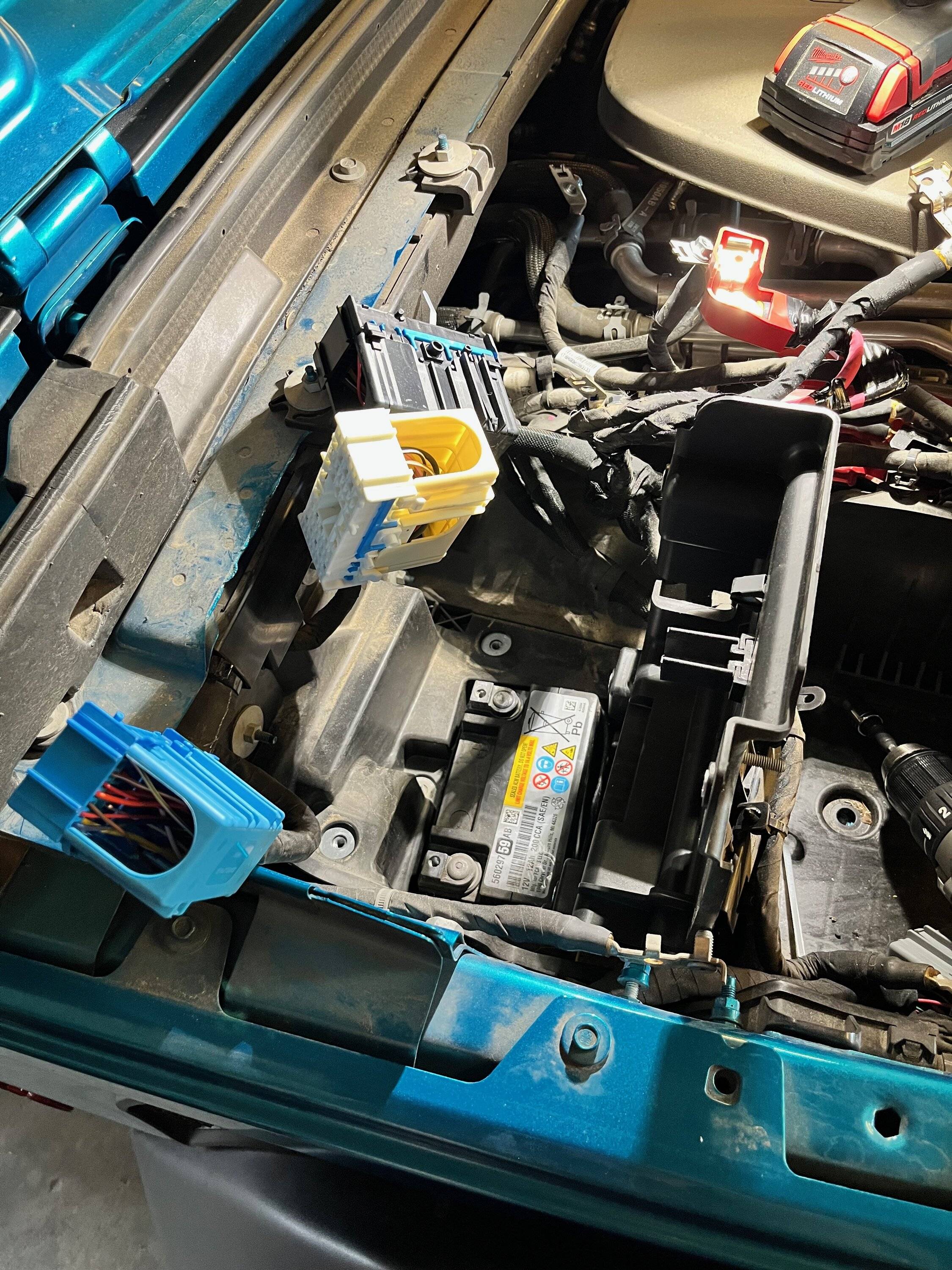

Yesterday I replaced the accessory battery (some call it ESS or auxiliary battery) and wow that really had me cursing the Jeep engineers. My Jeep has 26K miles on it and is 4 years old, and it's frustrating they buried a part that needs to be replaced that often so far down.
To get at it you have to
  1. remove the main battery
  2. remove all connections to the fuse box (between 6-8 depending on your options)
  3. remove the fuse box itself and remove 4 large plugs from the bottom
  4. remove the fuse box tray
  5. unscrew several ground wires from the side of the engine bay
All together it took me about 2.5 hours.
EDIT: don't do it this way, you are supposed to go through the fender well which I didn't know.
The whole impetus for putting an accessory battery there in the first place, in the already packed wrangler engine bay, to support a hacky workaround way of improving gas mileage that unnecessarily wears down parts that when disposed will cause more environmental harm than simply burning a tiny bit more fuel, made this task extra frustrating.
To add a little more background on my decision to replace the battery, I had already replaced my main battery about a year prior, and occasionally my Jeep would randomly not start after it had been sitting for a while. The main better tested good on the multimeter. When I pulled out the accessory battery I confirmed it was bad.
Here is a picture looking at the accessory battery with everything in the way taken out:

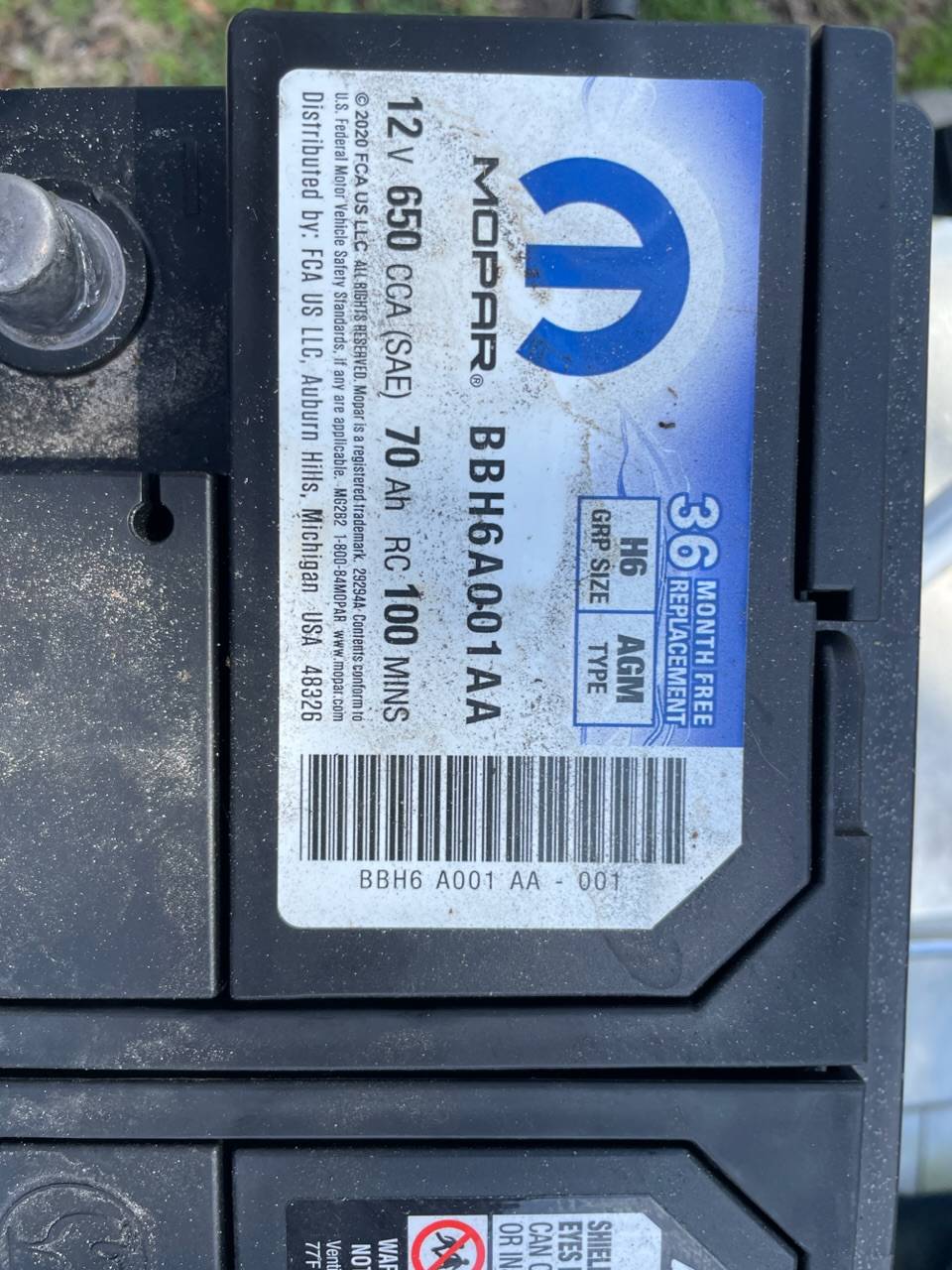

Same same. Removed the fuse, segregated the auxiliary battery at the negative cable. Replaced the H6 Mopar battery with a bigger, stronger H7.
edit: blurry photos show 650cca and 850cca
