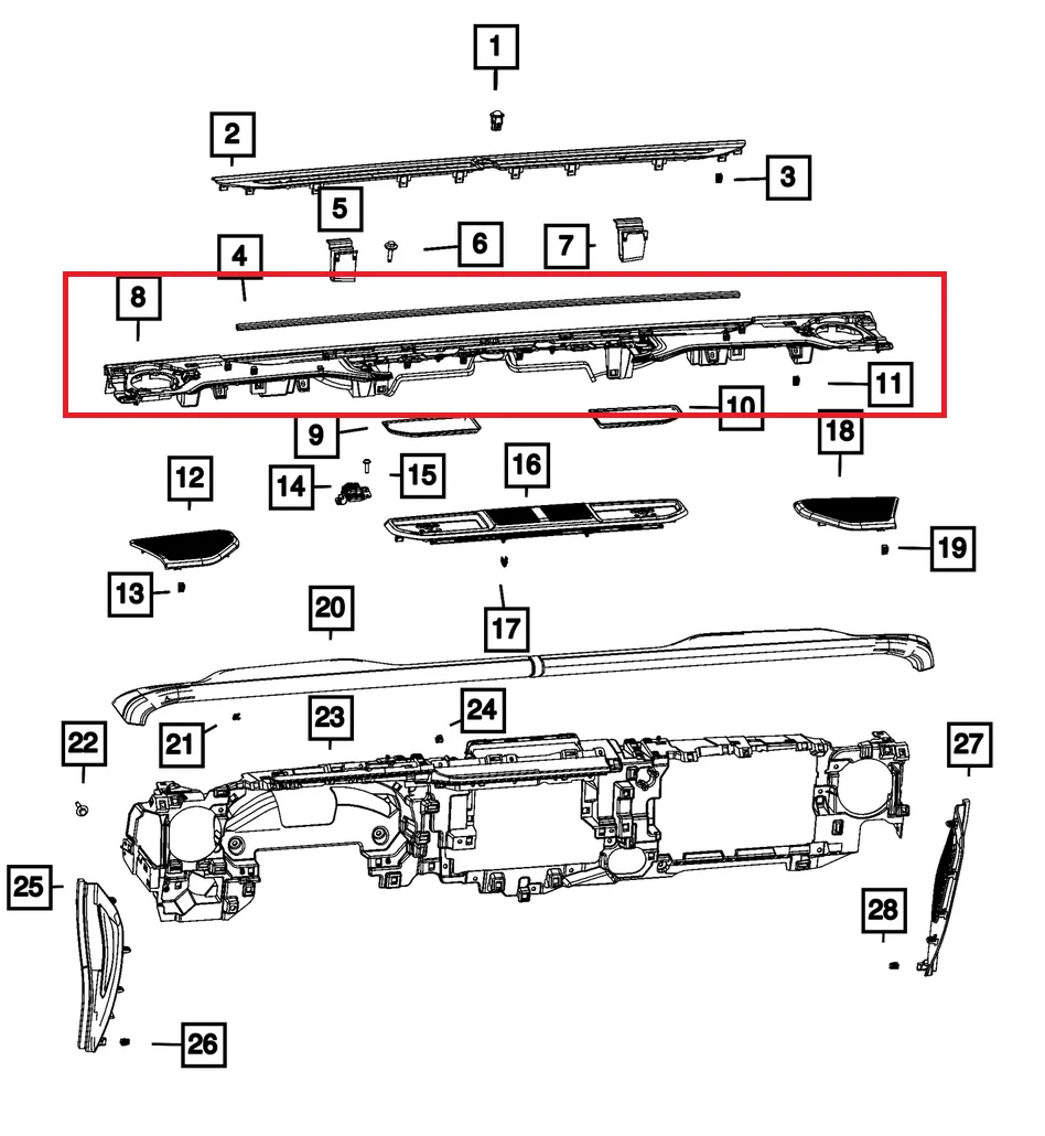

Long story short, I scratched up my defroster duct while removing that front upper edge trim on the dashboard and would like to replace it. I found the part online at a reasonable price (https://store.mopar.com/oem-parts/mopar-defroster-duct-7fs65tx7ac), but when checking with one of the dealers in the area, they wanted ~$1800 total in parts and labor to replace this trim. The service personnel stated that it would require the removal of the entire dashboard assembly, which really surprised me since it looks like it should be just 6-8 bolts to remove once you take the tweeters and the little tray piece out, but please correct me if I'm wrong.

I tried searching on this part and it seems most topics were about redirecting the defroster ducting to make it more effective. Has anyone replaced this part themselves and can confirm the dealer is overestimating the labor/cost involved? I would definitely replace it myself if it's as straightforward as it looks in the exploded diagram.

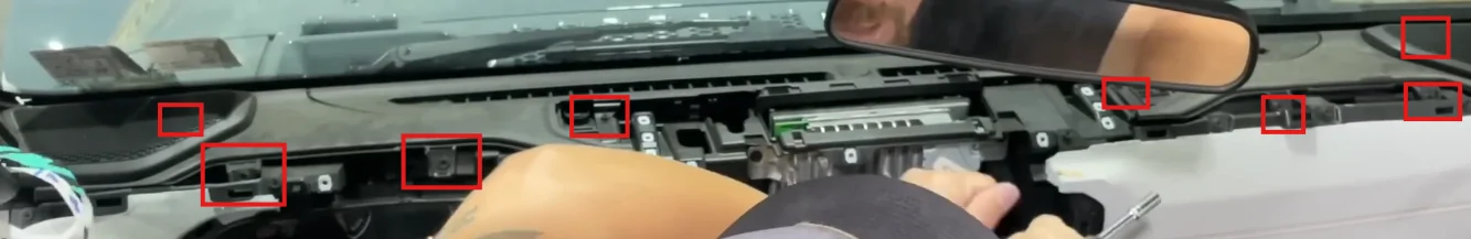

Hey @Balibe , thanks for the heads up. This video did really help with showing where the front portion of this panel mounts. I wish I can get some better photos of this panel and see if there's any bolt/screw/clip mounting spots towards the front where it sits against the windshield. I went ahead and marked the back mounting areas for future reference:

@RubyRuin ..... if you locations are correct, looks like you only need to remove the first two steps to the dash panel. No need to pull the unconnect display and the rest of the dash.
You will need to remove the dash speakers, they are easy as I replaced mine. Look at the link below from Audio Uprising for this removal (may be able to find a video online). I did this upgrade and it was easy and only took one beer to complete ;)
