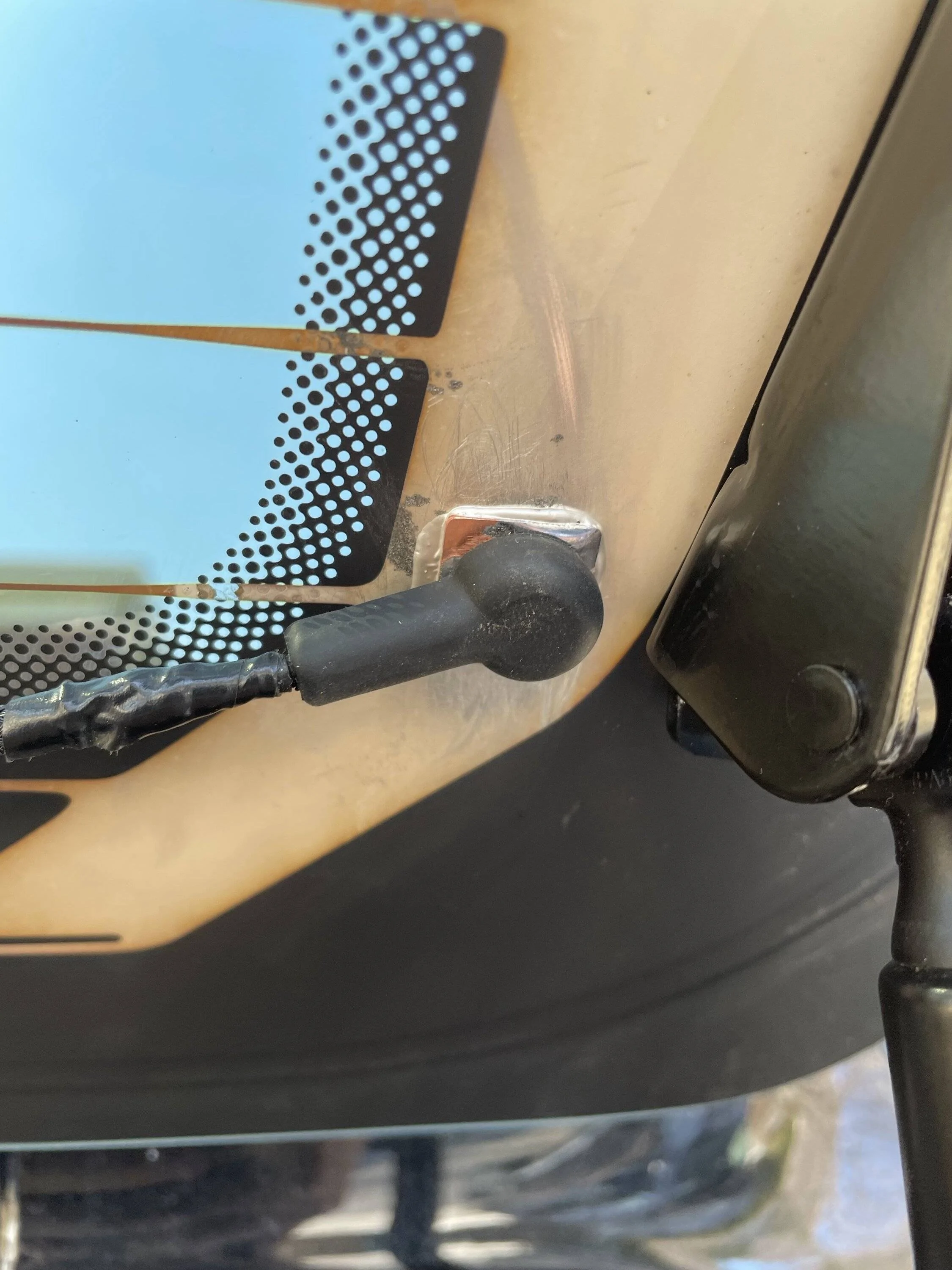

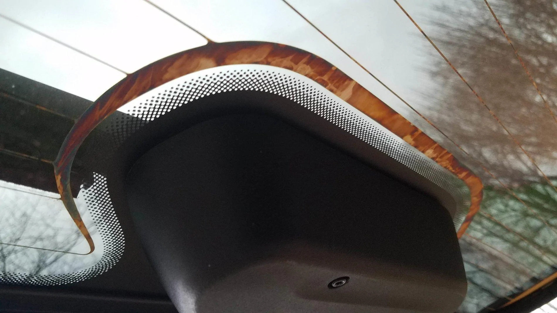

So I have been reading other folks' experiences with the rear defroster. It seems the most common issue is the connection becoming unsoldered. For me, the issue is what appears to be scorch marks. It appears around the entire perimeter and on the smaller wires.
Jeep Wrangler JL Rear Defroster Scorching... 20200111_164456
When I asked the dealer he said that was normal...hahaha... I guess for a jeep. So is this what precedes either the disconnection or as I have also seen here, the exploding rear window?

I don't thick that is scorched. It appears to be oxidized, which is normal.

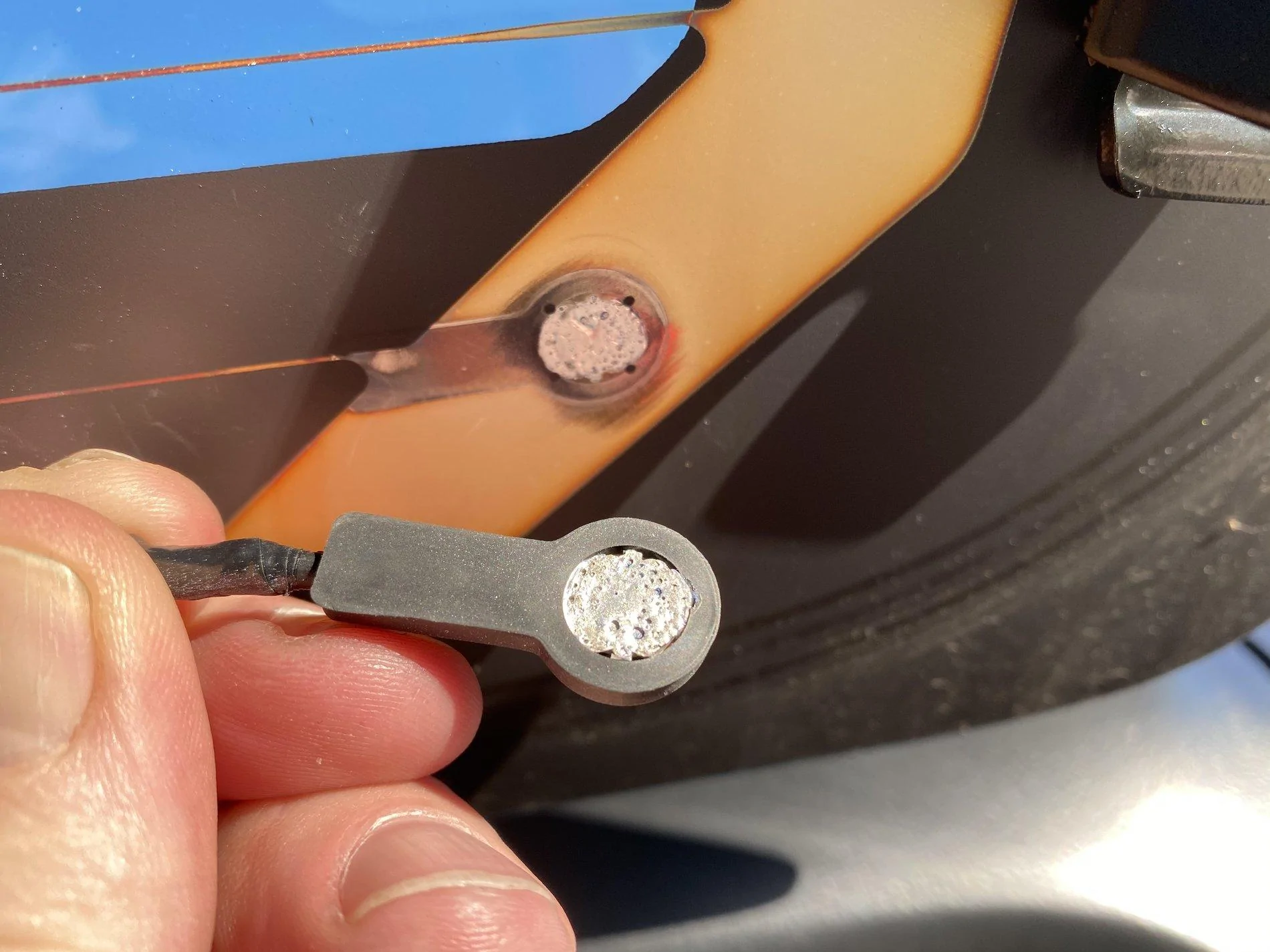

I have a 2018 JL with 12k miles that has the connector solder joint broken off the window on the rear defroster connector. This break appears to be a manufacturing defect as a cold solder joint. This should be under the warranty IMHO. We’ll see...

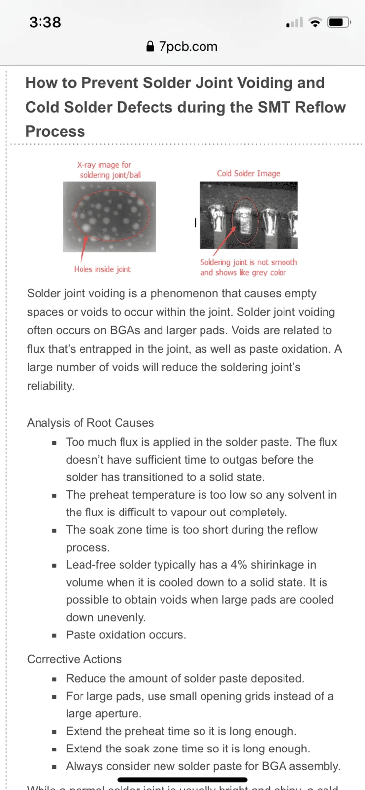

There are multiple YouTube videos of a fix. See photo and screenshot of explanation for cold solder joint below:

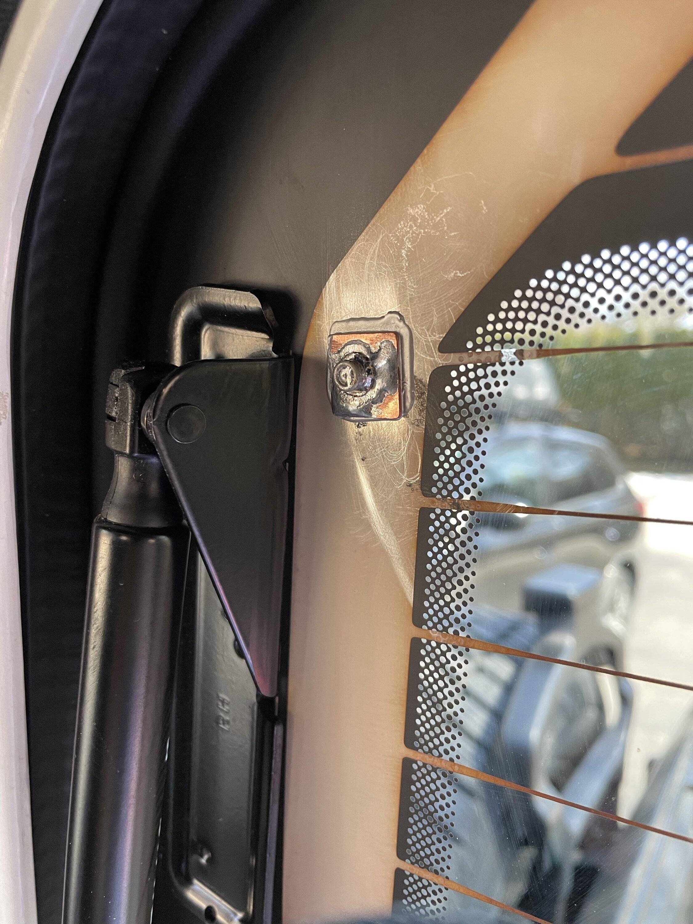

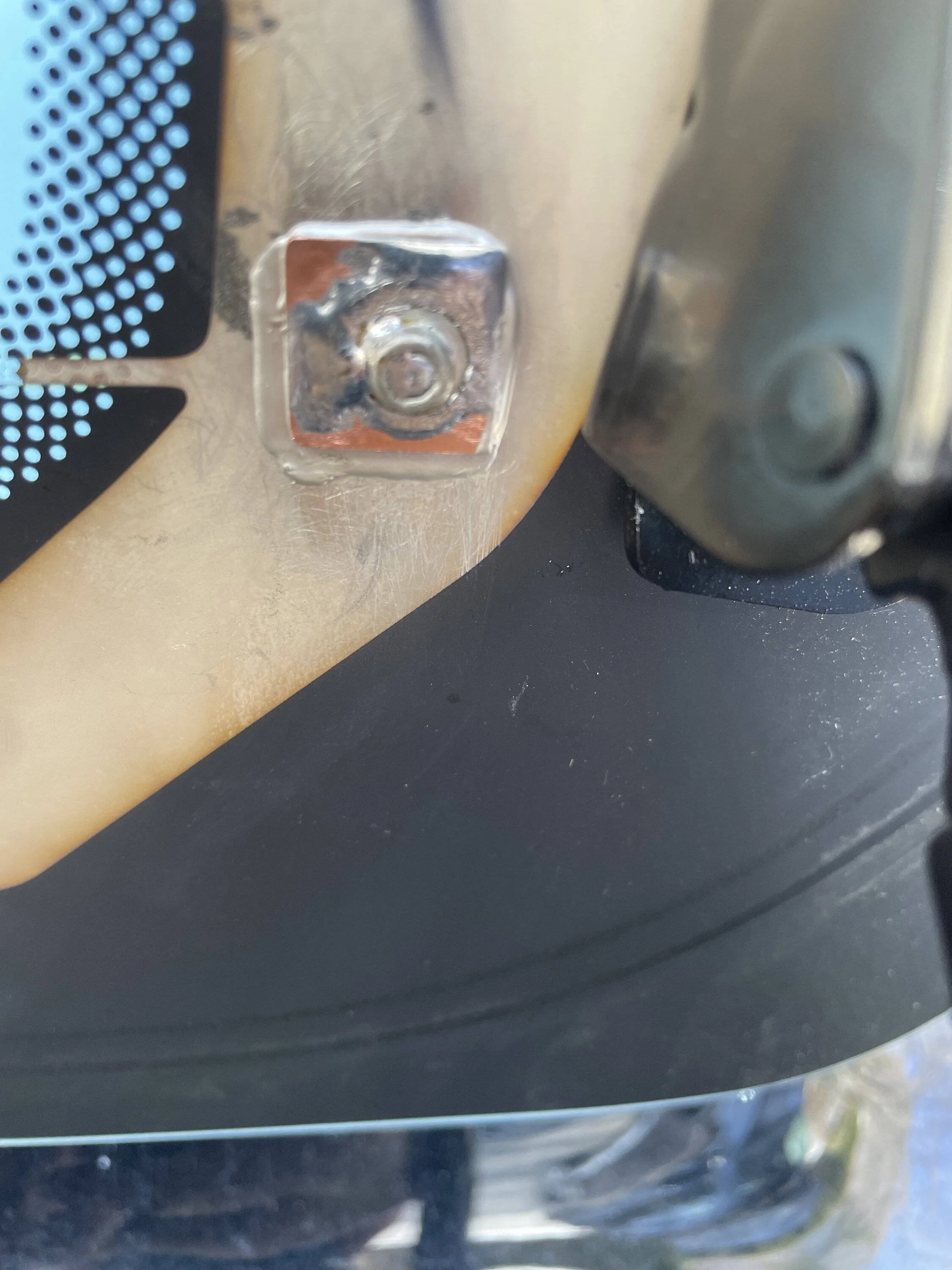

This how I fixed mine: lots of solder onto a copper heat sink, heatsink glued with Permatex. Bigger electrical path/surface, bigger glued surface = higher sheering resistance. Some used a penny instead of a heatsink.
