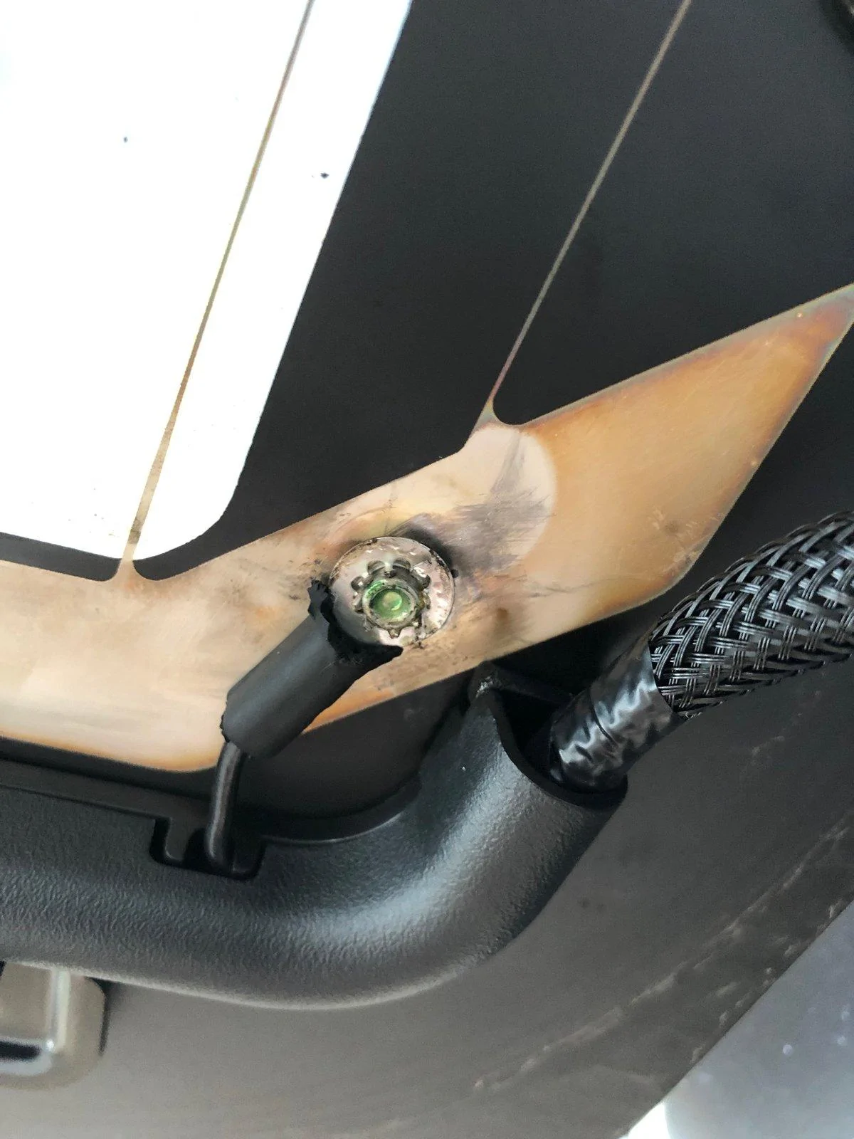

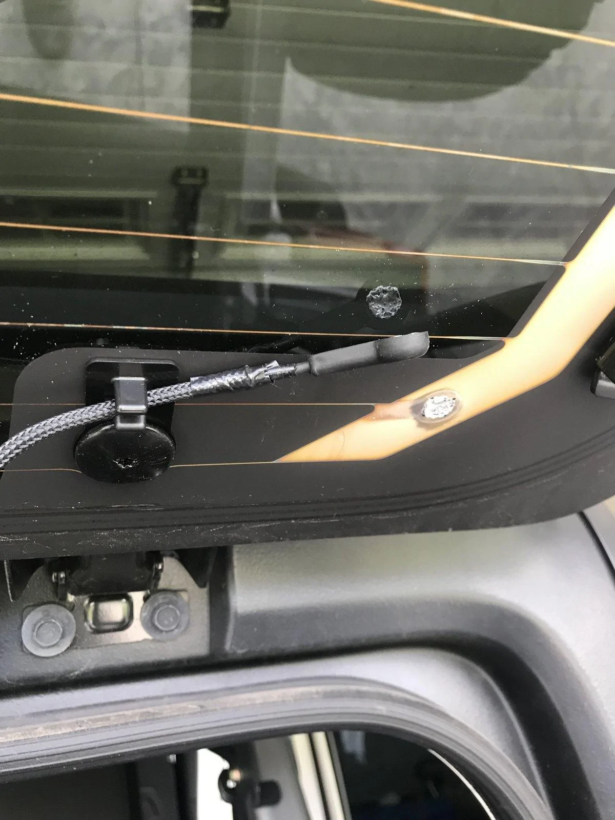

I landed in the same boat. Here's how the dealer fixed mine. After I get back from Colorado I'm going to have to have a chat with service manager, because this looks terrible (my wife took it in so I didn't see it until it was done). Not an acceptable repair for a brand new JLUR.
I would love to see what @JeepCares has to say about this repair? Any idea if we are going to get a TSB issued so techs at the dealers don't just handyman this stuff?
Does it work? To be honest that looks like a solid repair and one that might not come loose like the previous ones. Looks aside, I would be happy with a more solid approach than a simple re solder or windshield replacement.
tied
Feb 26, 2018
Tulsa, OK
2021 JL Sahara 4xe
Yes it works. I'm trying to decide if I'm ok with it due to the failure of even the replacement windows. I hate that the quality is so bad I have to live with "fixes" like this on such an expensive vehicle. I understand if it's 10 years old, no warranty, etc, etc on my JK, but not on the brand new Rubicon. Already had to have rear seat latch replaced (which involves disassembly of the rear seat). That was also super annoying.

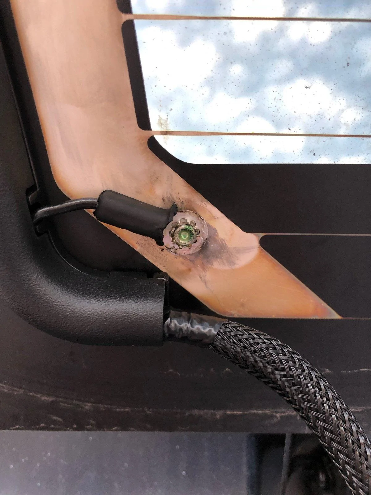

Just noticed mine came off too... I guess my list of issues has gotten large enough that I’ll finally take it in.
- drivers door makes cracking/popping sound when opening/closing
- clutch pedal squeaks and doesn’t move smoothly
- defrost connector fell off
- one more I’m forgetting...

Hi Sklosinski,
We deeply regret to hear about your experience. There was a Technical Service Bulletin (08-037-19) that appears to address concerns similar to the rear window defroster troubles that you are having with your vehicle. To ensure this TSB applies, we would like to get you into the dealer to have a qualified technician review the details of the TSB and specifics of your vehicle. Once reviewed, the technician can then perform the repair procedure that best matches the symptoms and diagnosis of your vehicle. If you need any additional assistance while working with your dealer to reach a resolution, please send our team a private message!

A revised "information only" TSB was just issued covering 2017-2019 JL's ("Rear Window Defroster Inoperable"), TSB 08-037-19, "...inspecting and possibly repairing the terminal of the rear defroster circuit".
