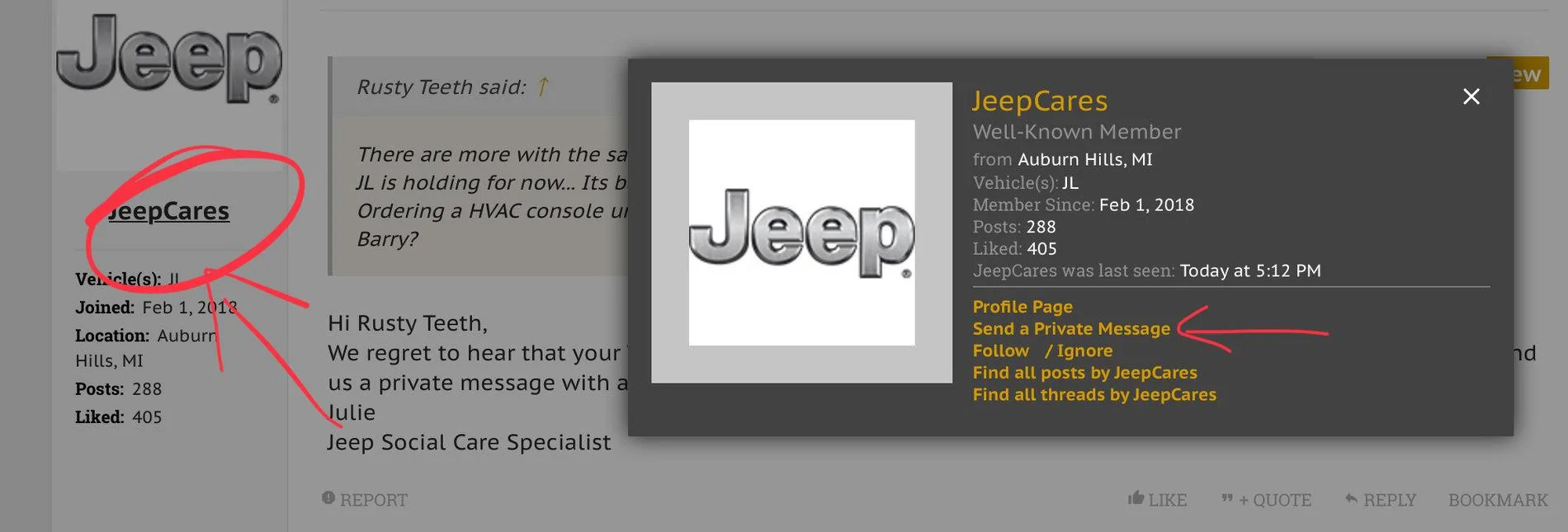

Click or tap on the name of the recipient to the left of a message (under their avatar photo). That will bring up an interface where you can do so.
See screenshot.
Oh ok, thank you!!!

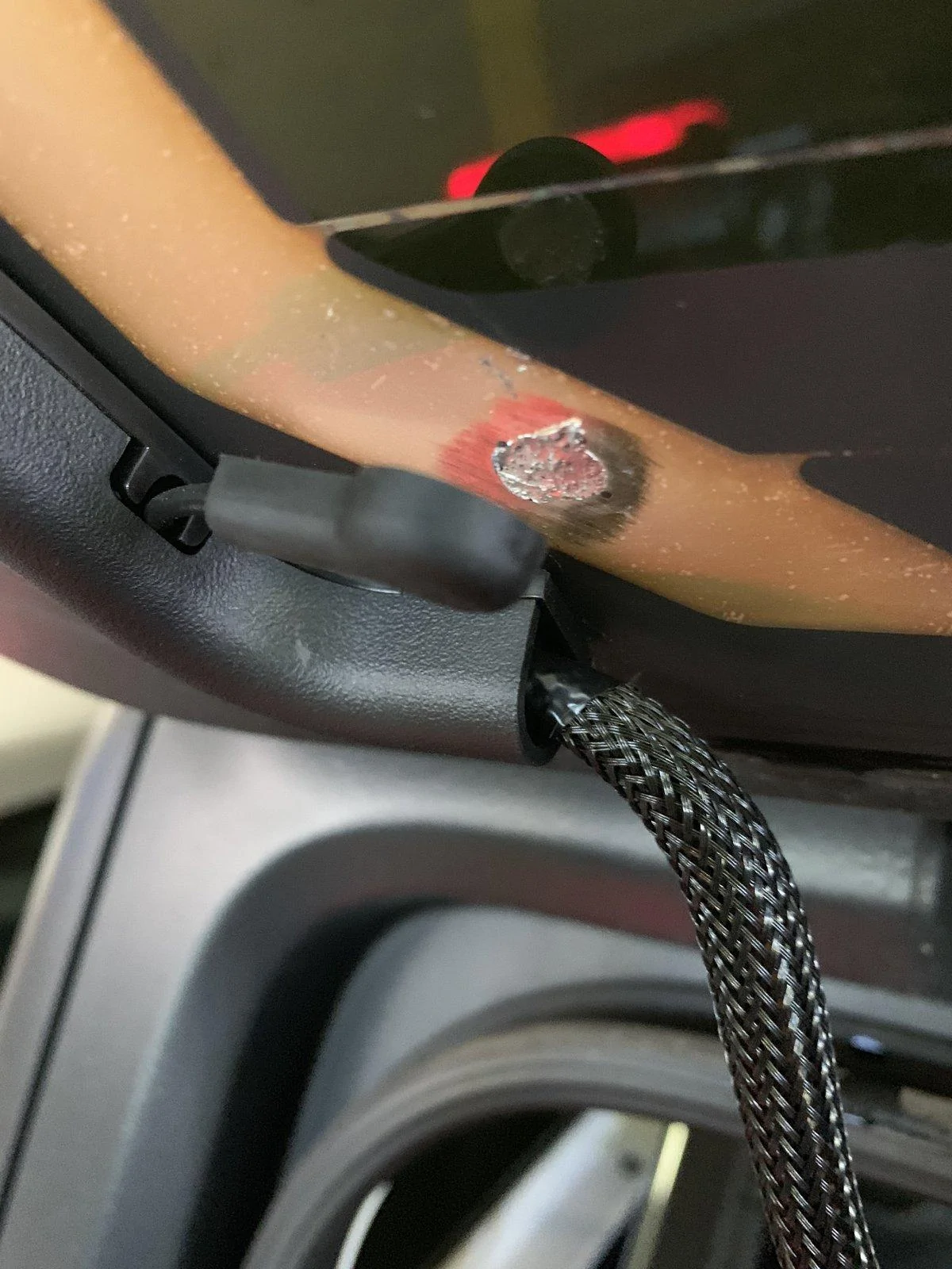

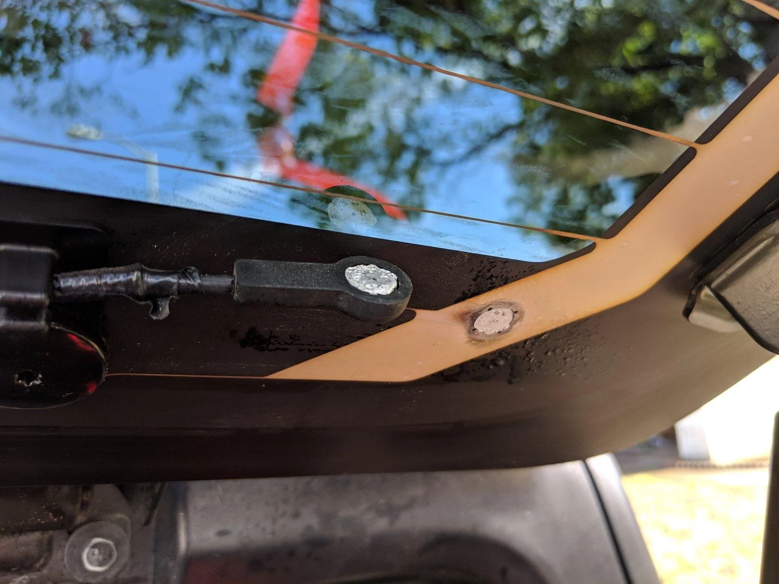

Everyone better check their connections and get it repaired early before Jeep runs out of rear glass and you are left without rear defrost for the entire winter.
What is the fix for this? Can Jeep repair the solder joint or does the glass need replacement?

Add me to the list... mine popped off last week. I have an appointment at the dealership on Friday and @JeepCares notified.

Only fifteen minutes at the service dept., they've ordered a new rear window. They mentioned conductive epoxy as an option but feel a new window is the way to go.

They will replace the window and not solder the connection. They didn't even try to fix it, they looked at it and just ordered new glass.

Just had my window replaced today. Took about 1 hour for the install. Doesn't look like they've made a change, so hopefully it lasts this time.

I had mine replaced under warranty, after install they noticed a huge scratch across the whole glass so they ordered another rear window. The scratched window was in for a few days and the defrost worked great. Now I got a perfect new rear window and the defrost works so little I question if it is even working at all. I drive home 20 minutes in the snow and the defrost lines barely had melted anything.

Oh man that sucks. Hopefully the dealer will order you a new rear window and not chalk it up to being a “Jeep thing”.
