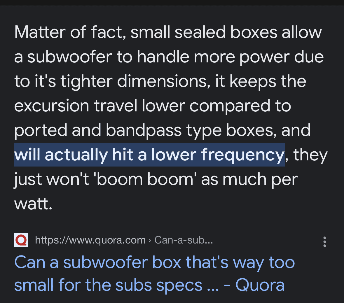

@lashlee and @Terpsmandan :
A quick Google search recommends using a more powerful amp in a smaller sealed box. Maybe a 600 watt amp coupled with the 400 watt TW3 is what’s needed? What say you?
