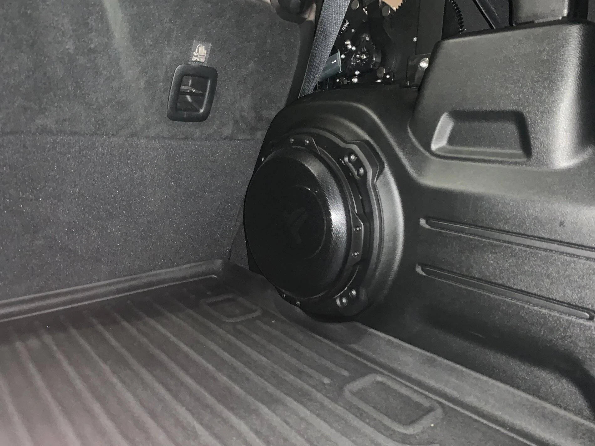

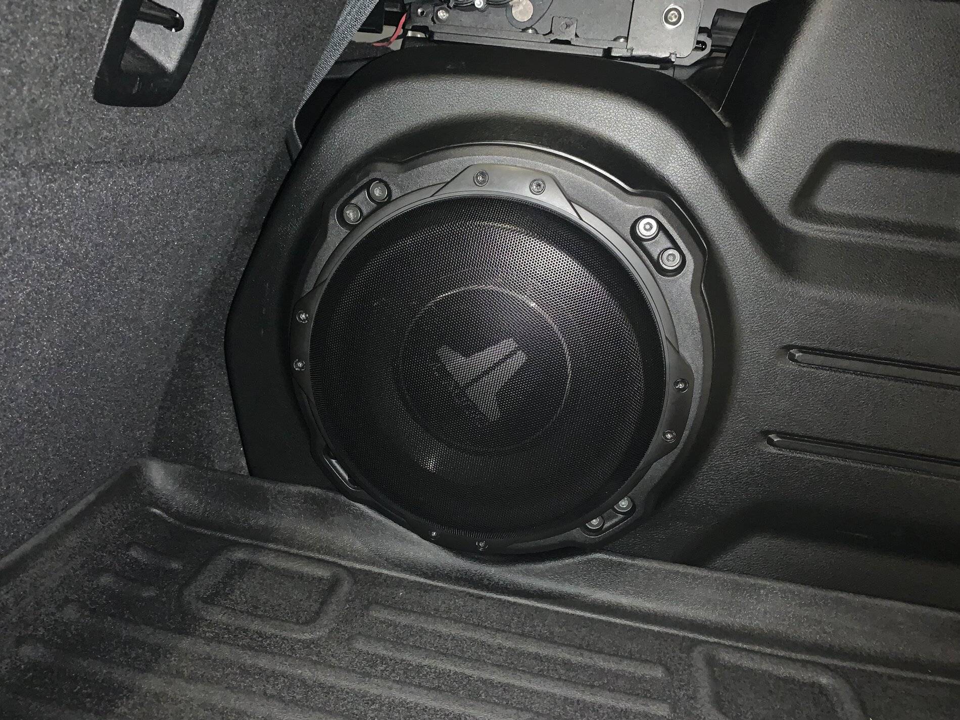

I actually used the old baffle. I just turned the sub a bit and drilled and mounted the JL to it. I don’t care about the logo and it made things easy. I sat around trying to figure out the best option without going crazy on the fabrication of a new baffle and so far this is working out fine.
How is this holding up? I was wanting to do this same 10 TW3 sub but my local car audio shop said it would not hold up in the factory enclosure.

Fine so far. Not sure what they mean about not holding up? The enclosure itself or the mounting method? Either way I have had no problems.

The outside Alpine trim piece with the screws comes off easy and it is what I reused with the JL sub. The Alpine woofer is attached to the enclosure with front facing screws and a center/rear attached machine screw. I removed those and chucked the Alpine. I then attached the JL sub trim ring to the original Alpine trim ring, the installed everything back into the enclosure

At first I was unsure. but it has broken in a bit and I think it sounds really good! I used sound deadening material on the inside which made it more dense and less plasticky. Overall I think much better especially when paired with the proper amp.
