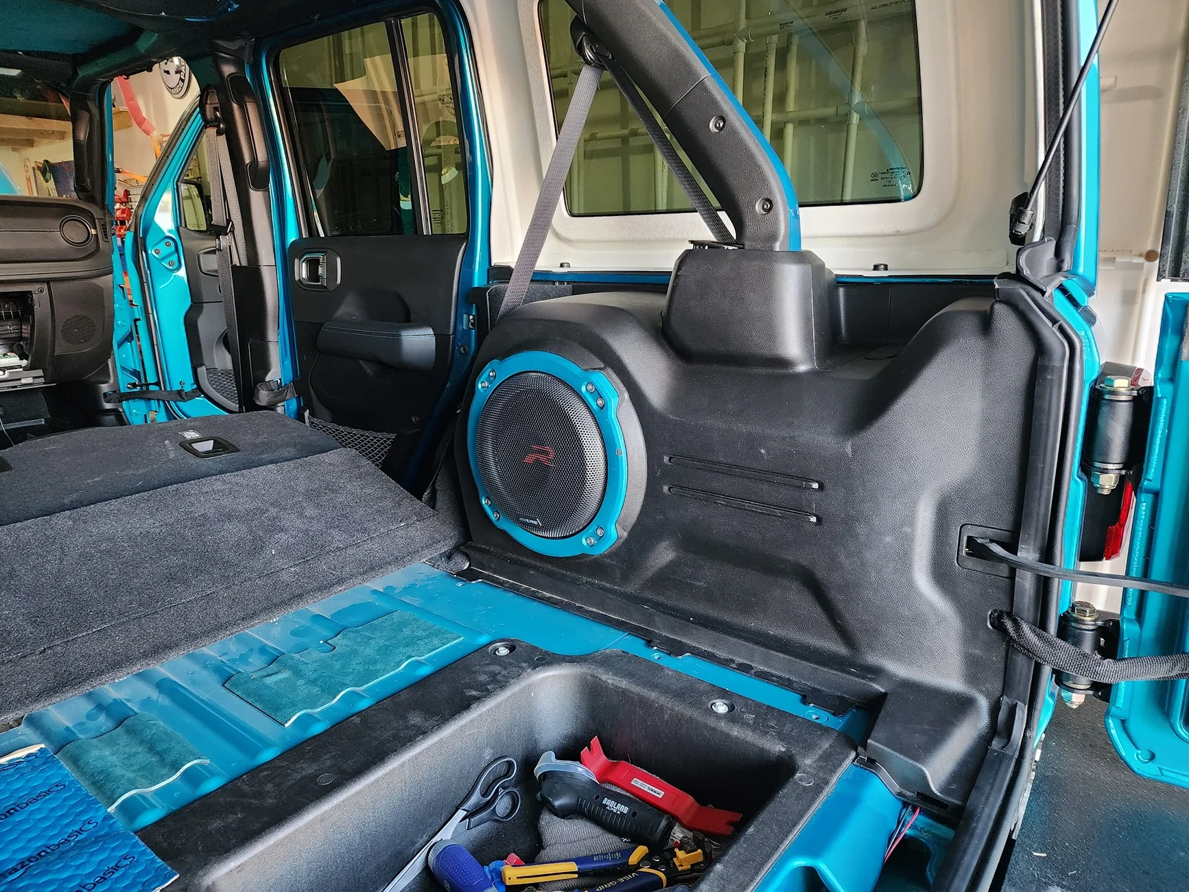

Factory Alpine system here with amp and sub. I have the ap4 ch42 interface. It sounds so much better than the factory sub. Im using an alpine rs-w10d4 sub that mounts in the factory location. Theres a ton of sound deadener on the back of the panel and also on the body behind it. Its been one of my favorite mods so far. Im waiting on alpine to send me the harness to amp the speakers too and theyre also sending me some tweeters so that should really wake things up even more.

Was that sub a direct fit in the factory location, or did you need an adapter ring?

I am honestly not 100% sure as the guys at Alpine took care of me on that part. I know that it has a different grill than factory and that part is kte-rs10g. I am going to be pulling the speaker trim though to touch up the paint ive got on it and can confirm if its got an adapter ring or anything.

Do you have a picture you can share?
