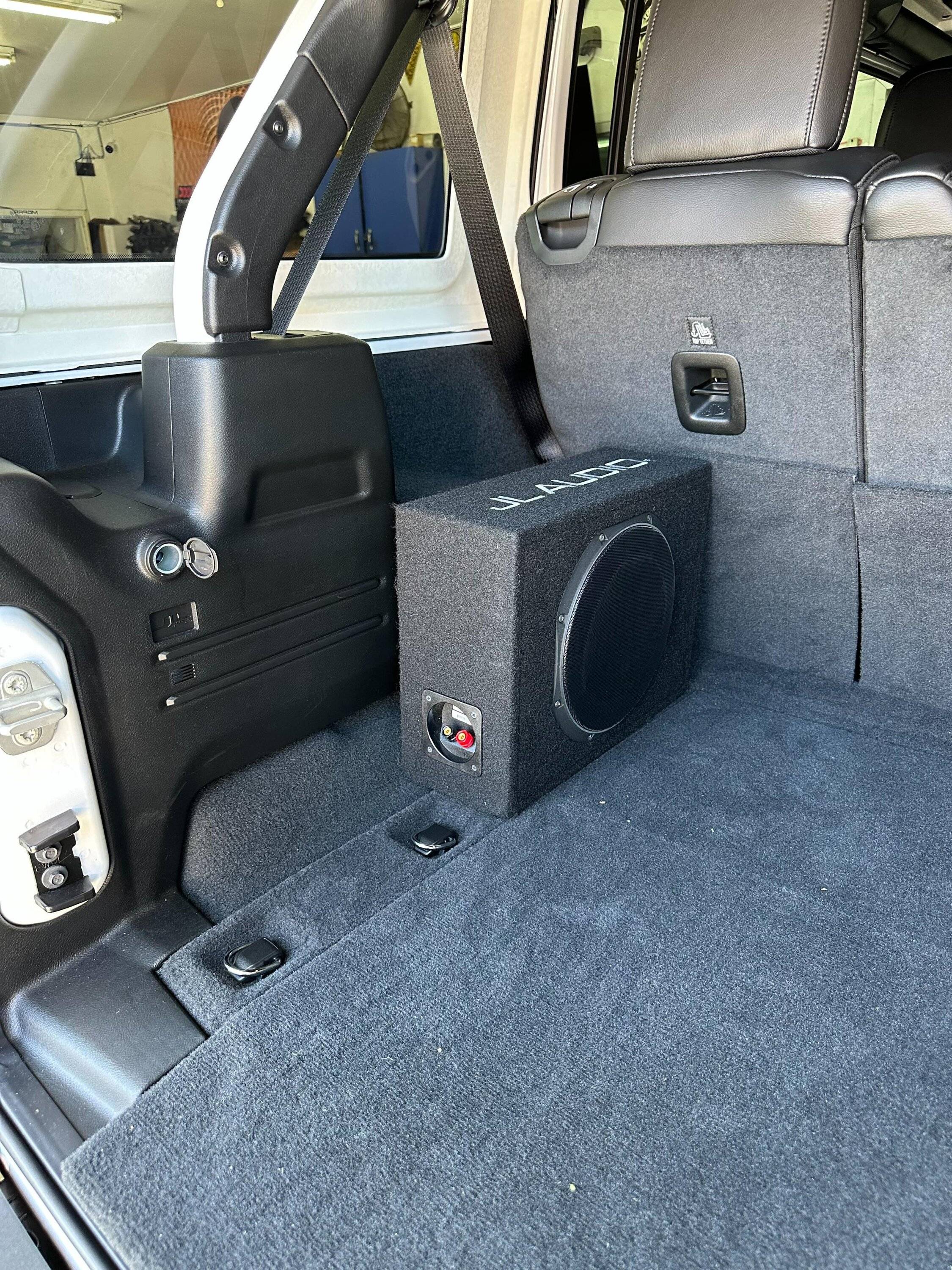

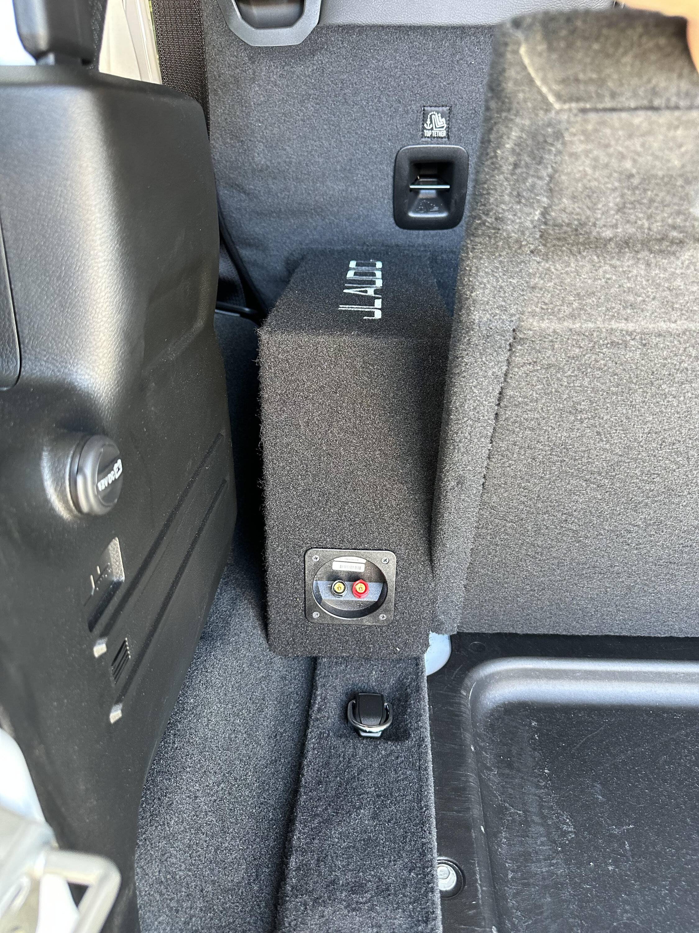

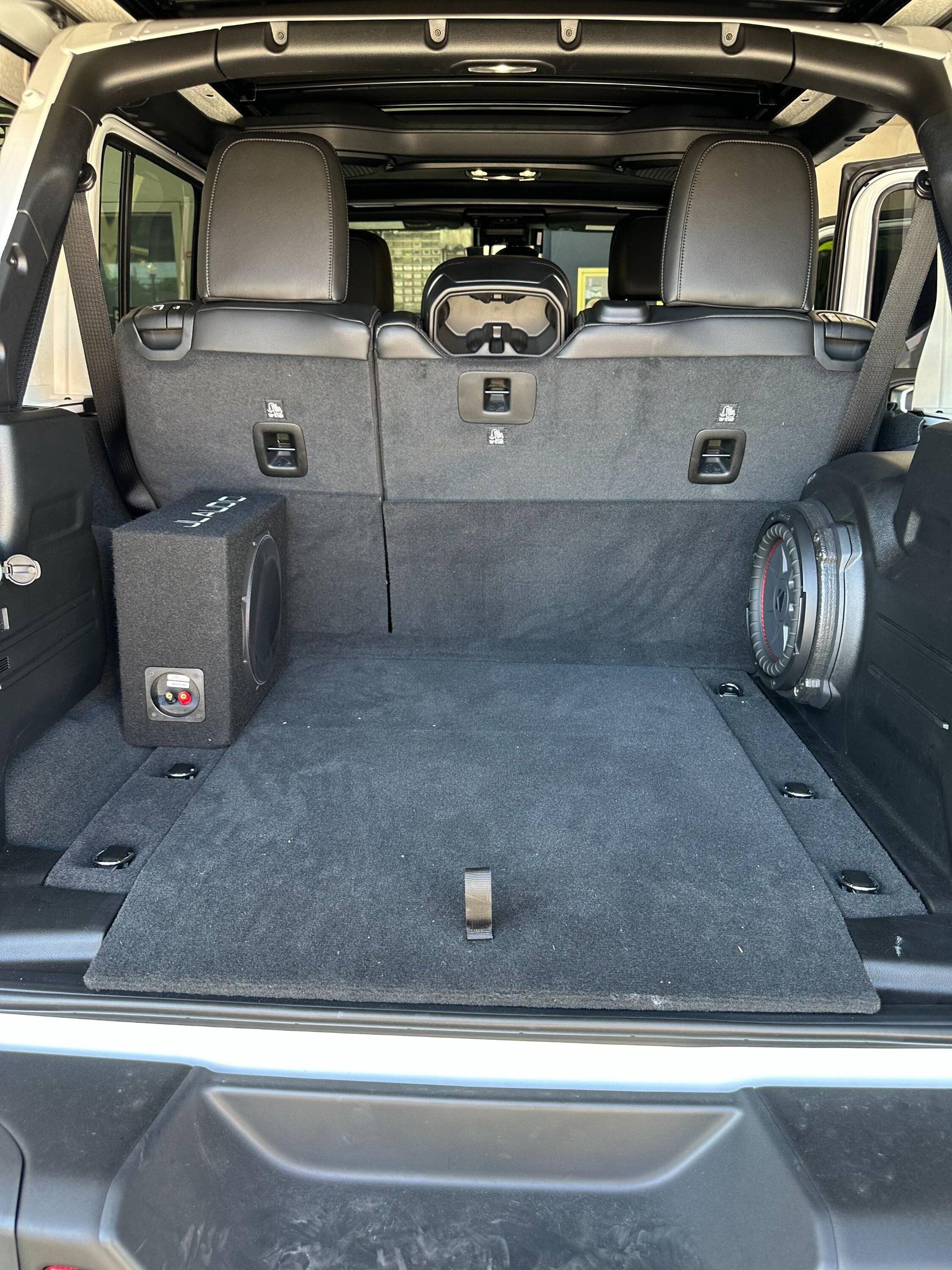

Well I had the BRP ring and Kicker 48CWRT104 and ran it for a few weeks. After breaking it in, the pros were greater range and punchier bass. The con was it just wasn't as clean as I would've liked for an aftermarket sub. I suspect in part this was due to the sub suffering from the design of the oem box, as well as overall lack of rigidity. I even had the shop add material to reinforce the back of the box.
I ended up ordering a prefab JL 2 ohm sub (JL Audio CS110LG-TW1-2) thinking I could stuff it underneath one of the rear seats, but it was just a touch too big. Luckily it fits in the trunk and just allows for the under compartment to open, albeit with a little rub. As you can see the box is tiny, but the sub is the 2 ohm version of the one that comes in the JL Jeep Stealthbox. Sensitivity is lower than the kicker, but I'm not a huge basshead and was able to just turn the AmpPro sub level higher to compensate for lower output. Overall, I am extremely pleased with the sound quality and range. There is no distortion at any volume level.
Wish I would've just started here from the beginning as it is less than half the price of a stealthbox ($400 vs $950) and just $150-200 more than the BRP Ring + Sub.
The simpler solution that seems to be very well received is the MB Quart oem subwoofer upgrade. Despite not having heard it in person, that is the other option I would recommend.
