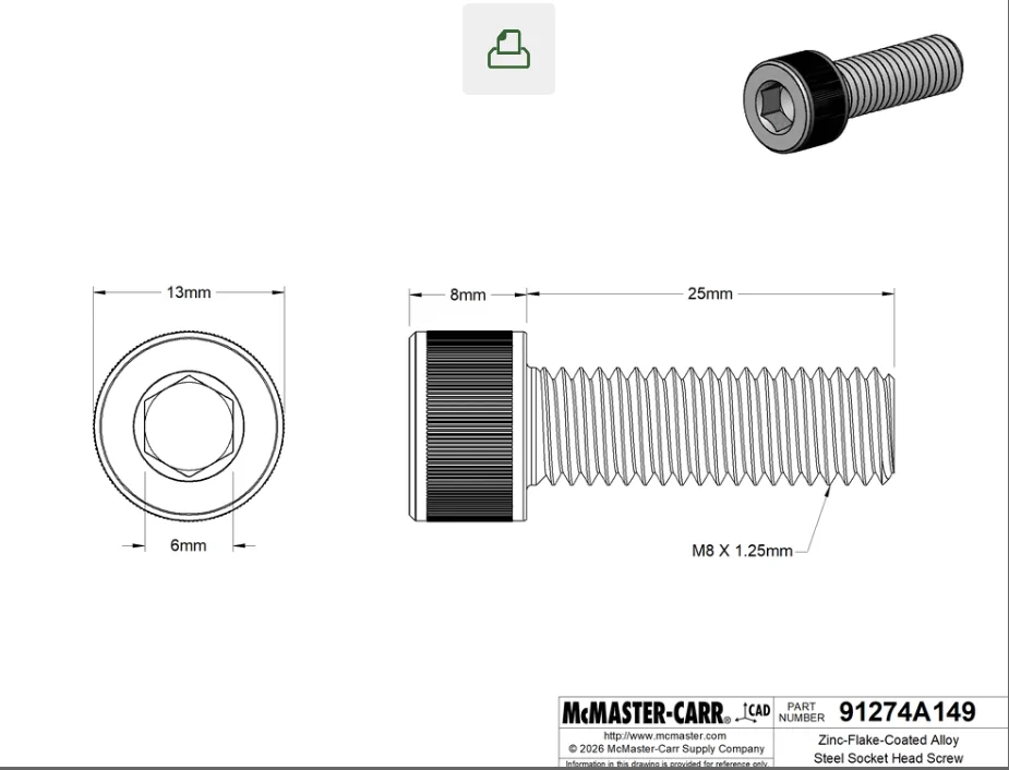

Went to local Ace hardware store and bought grade 12.9 socket head capscrews and matching split washers, torqued to what Jeep said, iirc 25 ft/lbs..
I ended up ordering this Zinc-Flake-Coated Alloy Steel Socket Head Screw, M8 x 1.25 mm Thread Size, 25 mm Long | McMaster-Carr
I chose the Zinc-Flake based on this : Zinc-Flake-Coated Alloy Steel—The coating is tested to extreme standards, including at least 700 hours of salt spray resistance, to hold up in wet and outdoor environments.
Measured the AEV bolts with my digital caliper and it matches the specs on McMaster site.
shipping more than item cost :headbang:

Clicked your link and it wants me to login to see the fasteners you linked. Specs look perfect except hoping those are grade 12.9.
Edit: McMaster is my goto online fastener place. I also removed the stock gaskets and used RTV instead as I don't run ground clearance robbing diff skids and let the axle and cover do the sliding as needed. Using RTV ensures that the cover and axle are held tightly together ( no little gap like with gasket) such that rocks hopefully can't grab the edge and loosen bolts.
strange, I can see it without logging in. yah they are 12.9
Fastener Strength Grade/Class
Class 12.9
