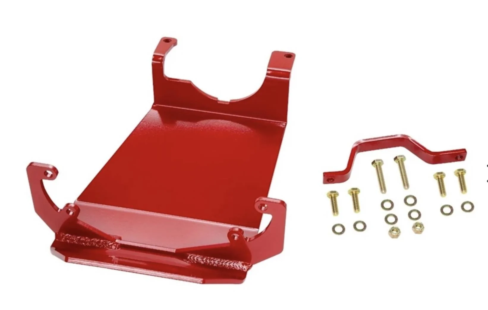

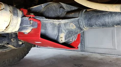

I have Rancho front and rear. About $150 each. Very happy with them.
  • ENGINEERED TO LAST -- Features 0.25-in. high-strength, low-alloy steel construction for long-lasting strength

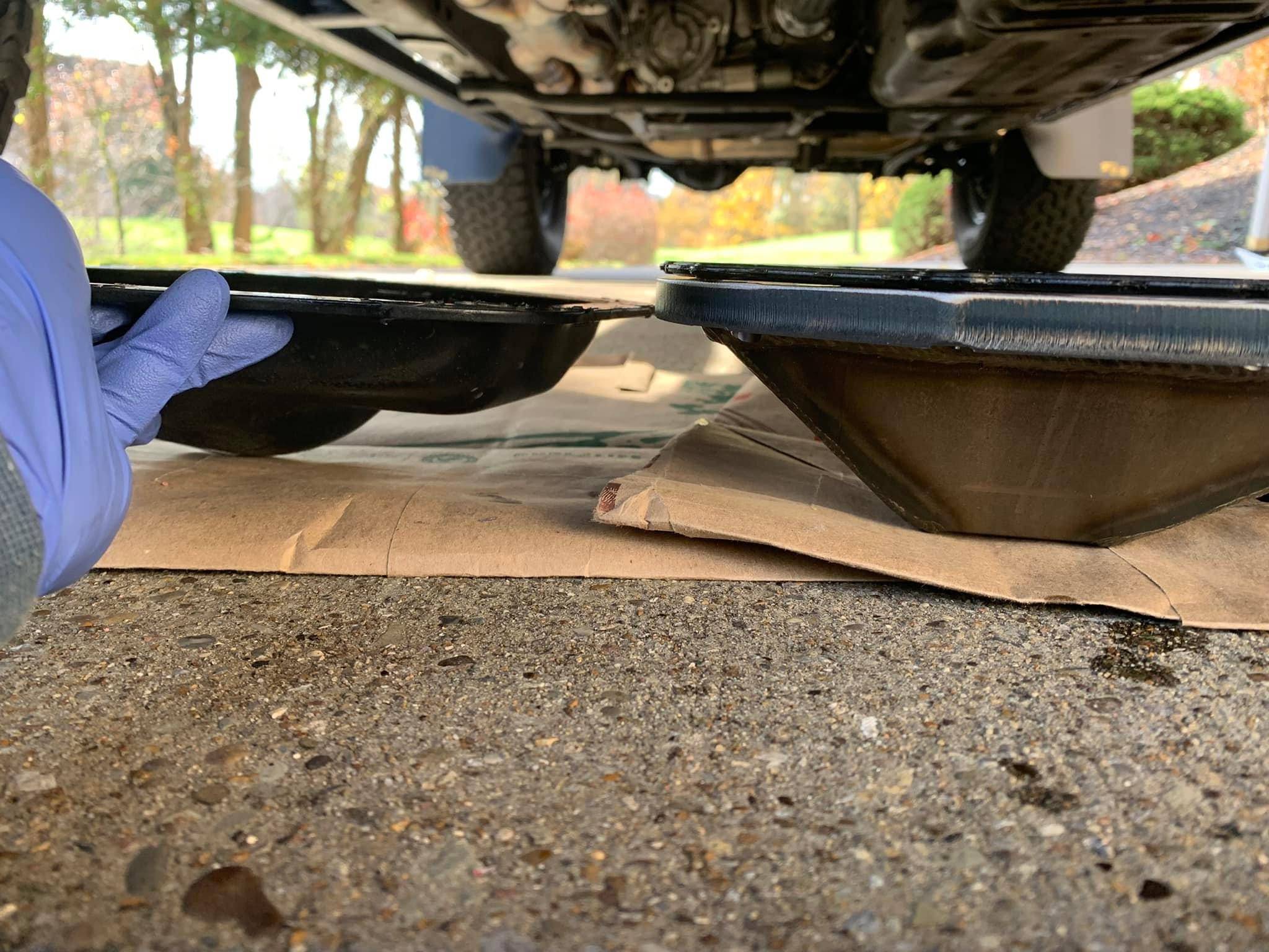

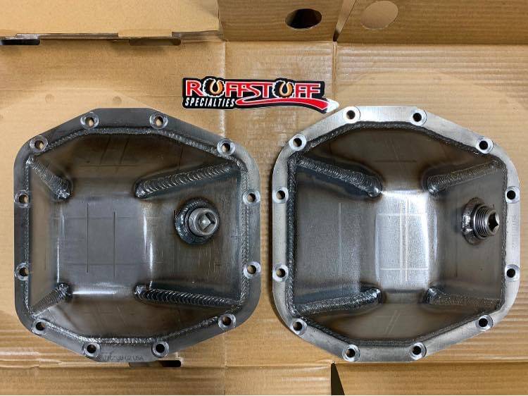

Got these real beef at much cheaper cost, 3/8" (.375") plate steel cap is bent 8 ways and welded to a 1/2" ring, making it virtually indestructible. No need for expensive skids, and these diff covers also serve as axle truss to some extend in terms of making it stronger.
