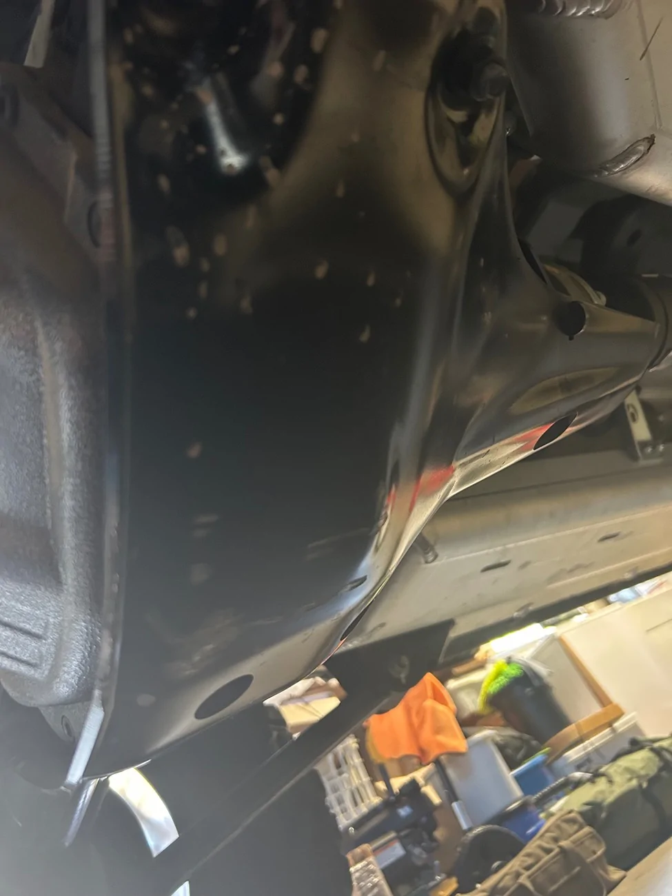

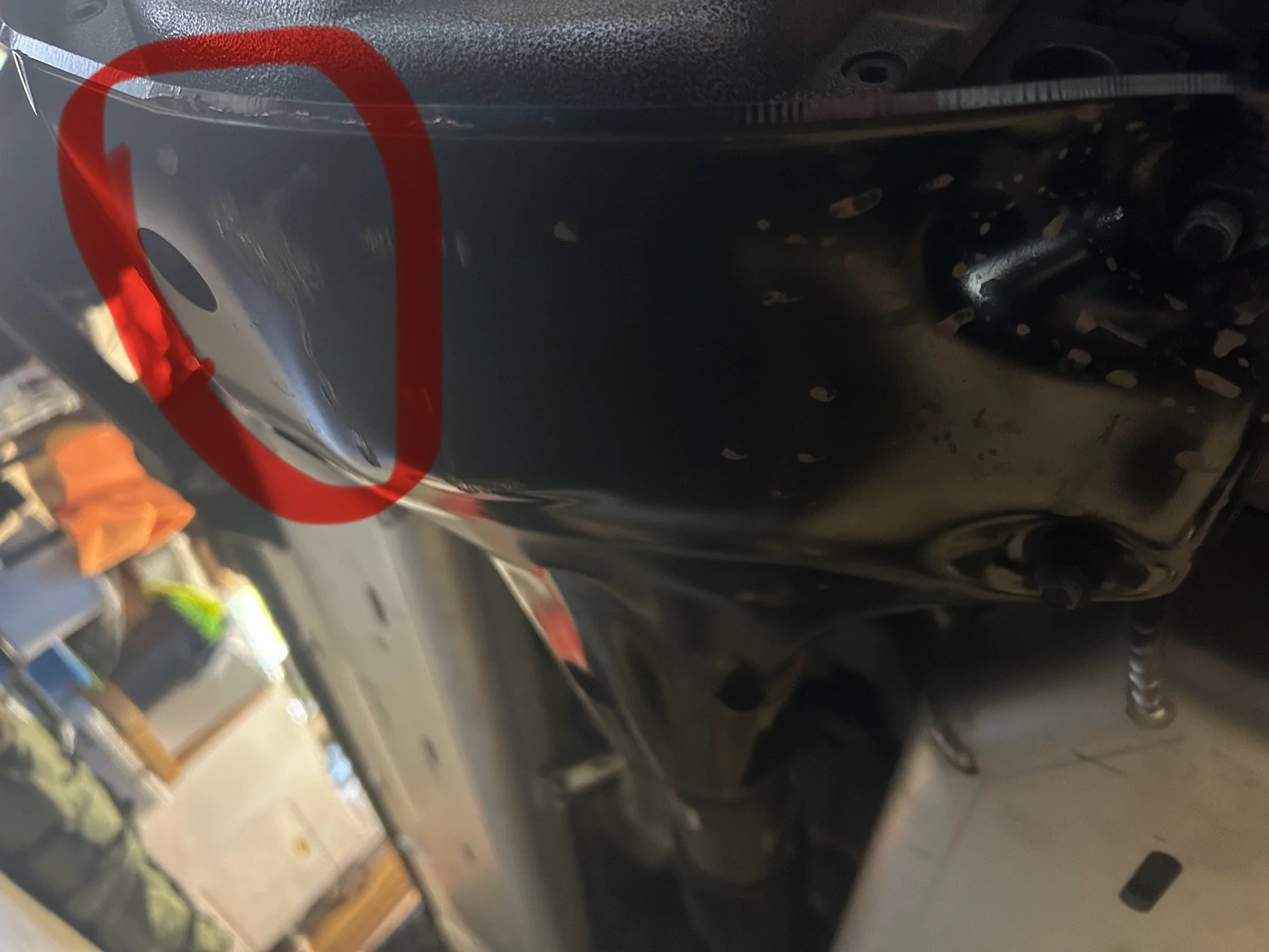

I’ve had the AEV rear differential skid and have taken some hits at Big Bear. Left a dent and some scrape marks but it did its job and protected the differential.
couple of pictures: I’ve circled the dent. Can’t see it well in the picture though. I like that it also protects part of the drive shaft. Can remove it to drain diff. fluid. I have a 2021 that has a drain plug.
The AEV front differential cover is unfortunately not compatible with the 392s.

Looks like it did its job. Lots of people arguing that the 4mm stamped steel isn't good for anything, but the actual examples of hits i've seen - including yours - show otherwise. For those of us that aren't intentionally rock sliding with full underbodies, I think this is looking like a good option and offers more protection for the pinion rather than just the underside of the diff alone.
Thanks for the pictures.
