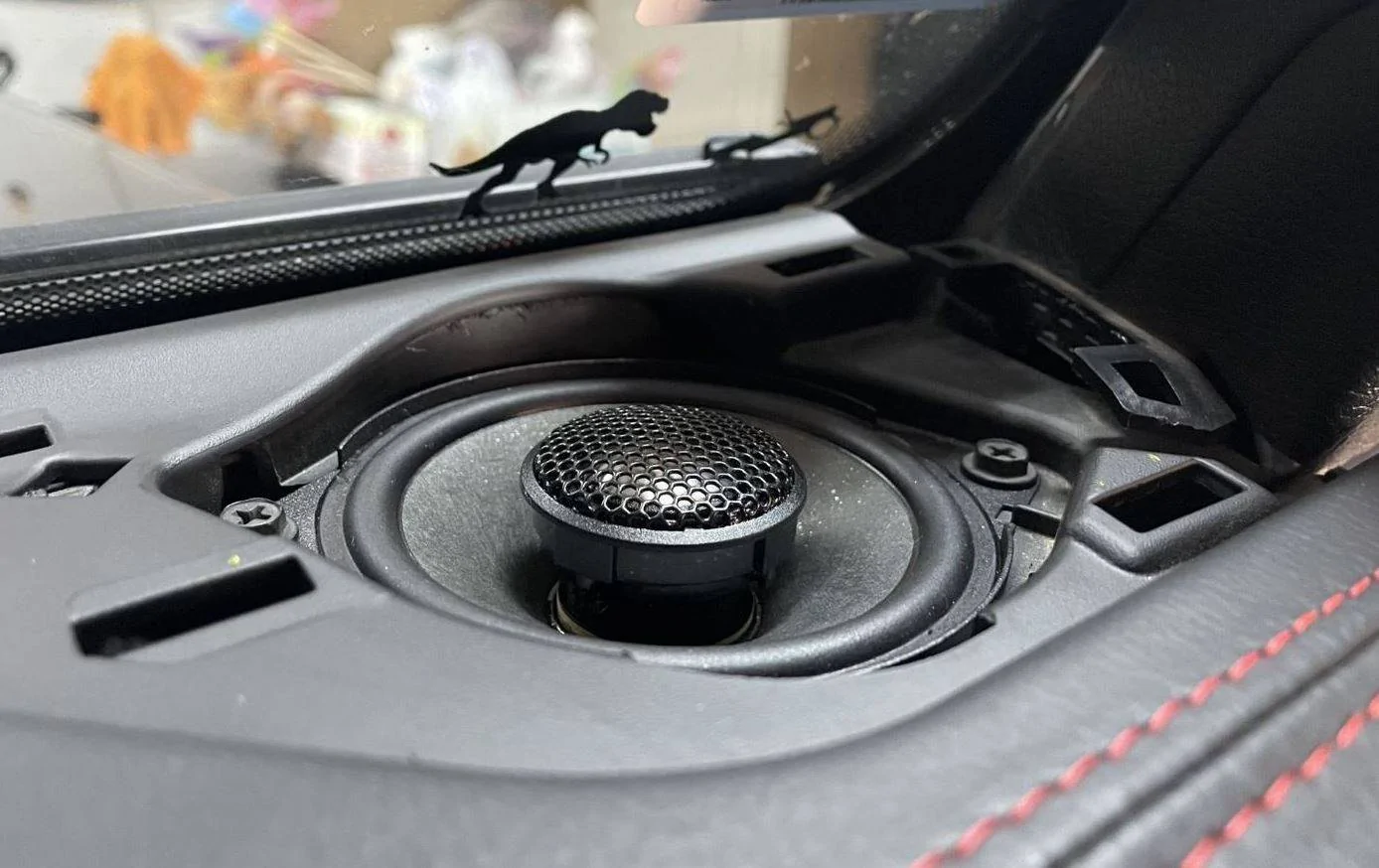

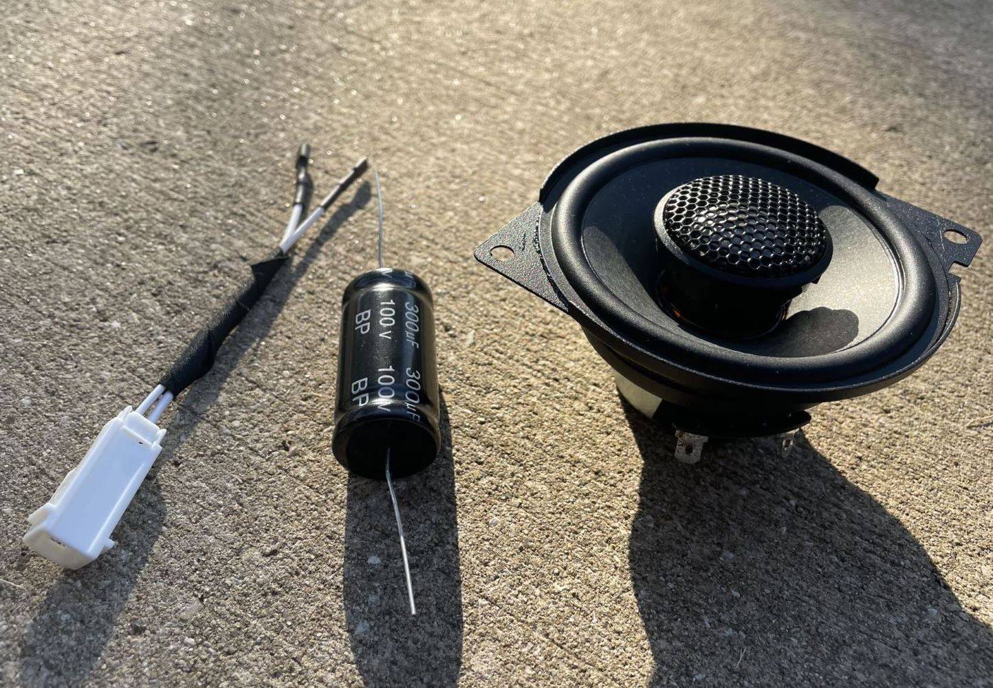

Update to my reply above. Got the two 3.5 inch dash MBQuart speakers installed last night. What an upgrade over factory! They sound so crisp and clean and not that muffled sound from the stock speakers. The capacitor was included. I may upgrade the remaining ones sooner than later.

I have my dash speakers coming today is the capacitor recommended?
You do not need the capacitor. The factory amp crosses the signal over, only higher frequencies are sent to the dash speakers anyway. Assuming you have the alpine factory system.

I do have the alpine and I did use the capacitor. I seen your post after I installed. Does it matter either way?

No it doesn't matter, it just won't do anything.

I installed the capacitors per MBquart's technical support folks. I think they know what they are talking about...
