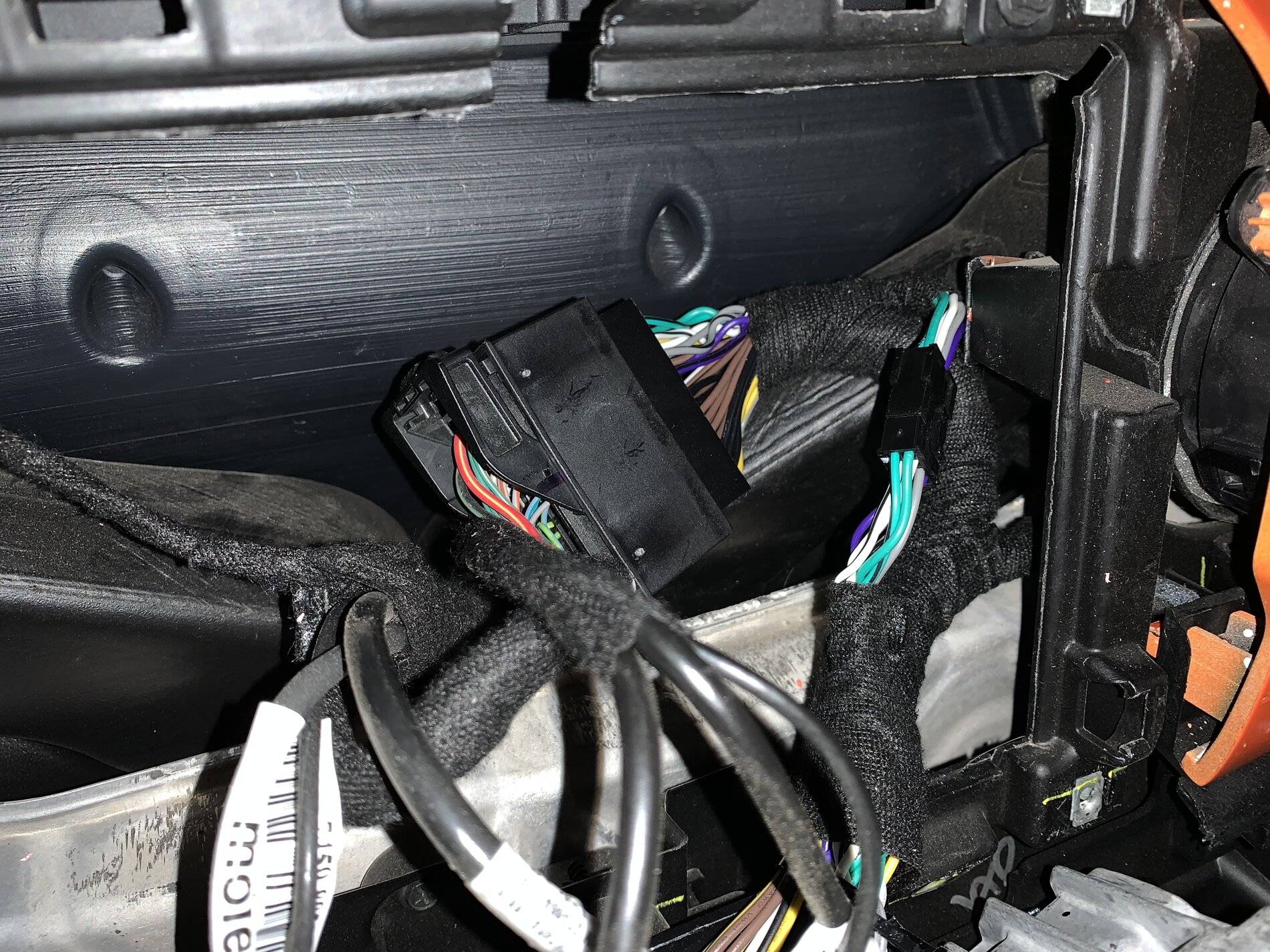

Looking great @Krondor, I am in the middle of my install and holy crap there is a lot to remove. The system is definitely plug and play but you have to remove a lot of screws, trim pieces and the passenger seat. Quick question @Krondor. Where did you mount the ground wire for the three amps? I also bought the subwoofer amp as it was $100 and it mounts and plugs right in with the other wires that are already run in the harness from MB Quart. It will be interesting to see how everything sounds. Another question, if we have the premium alpine system do we plug the two harnesses together when installing the wiring harness for the PAC AMP unit? One has a sticker that says only use in amplified systems. I went ahead and plugged those together before screwing the screen back in (very tight fit with those huge harnesses behind it.)
I should have bought the sub amp.
Again, it looks like you connect that harness if you want to use the factory power. I'm not sure how the factory sub will continue to get power but we will see. If not, I have more storage until I get their sub amp and a suitable replacement sub.

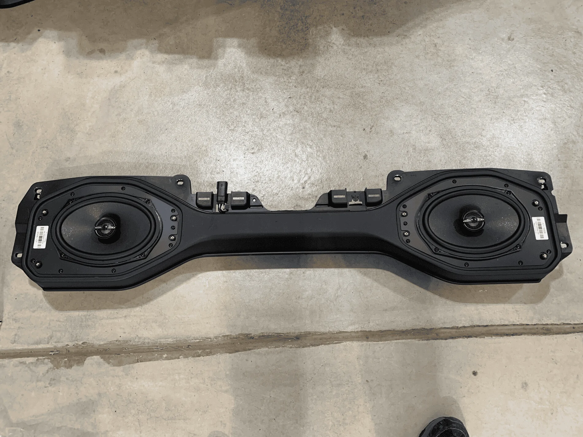

Well, I put the interior back together and plugged everything in after getting the 6x9's done.
Jeep Wrangler JL Adding an Aftermarket Amp(s) 1621204737234
The stereo works.
The sub does not.
800Watts? BS
Volume is no greater than it was before, might even be lower though it does have better range. I'll play with the PAC settings and see if I missed something. But at the moment, I'm feeling like my grand was thrown away. :facepalm:
The PAC would have cost $350? The front pods maybe another $80? At the moment I'm not very impressed. Will see after I update the PAC and click some options.

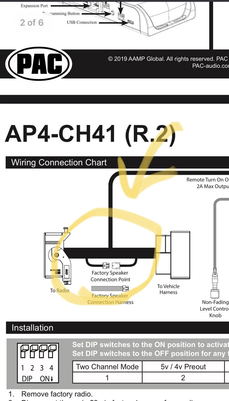

I did plug those two plugs into each other on the PAC wire harness and my factory sub still works. I have the gains up at about 75% and when I run a bass test from YouTube it hits pretty hard. Now I am not super impressed with the sound of music from satellite radio. I literally just finished up the install tonight so I still need to play around a bit. I did order the sub and plan on first connecting it to the alpine sub in the Jeep and see if I need to upgrade that. I feel like the system improved but still needs that solid kick from a sub really round out the system. I am not a bass heavy music person. I’m looking for solid sound that is full of that makes sense. I’m still on the fence if this system was worth the $1000 investment especially with how long the whole install took. I will keep everyone updated. I plan on calling PAC amp about the plugs in the back of the unit and see if they are supposed to be plugged in or stay unplugged. Here is a picture of the plug I am referring to.

Following Jon’s lead.
Let us know how it goes plugging in the switch and turning on the #4 dip switch. I am hoping the sub amp will help the system. So far I have been very under whelmed.
