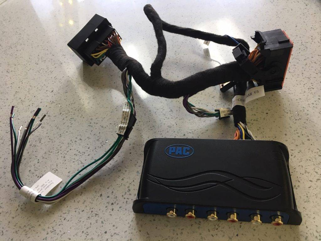

I did plug those two plugs into each other on the PAC wire harness and my factory sub still works. I have the gains up at about 75% and when I run a bass test from YouTube it hits pretty hard. Now I am not super impressed with the sound of music from satellite radio. I literally just finished up the install tonight so I still need to play around a bit. I did order the sub and plan on first connecting it to the alpine sub in the Jeep and see if I need to upgrade that. I feel like the system improved but still needs that solid kick from a sub really round out the system. I am not a bass heavy music person. I’m looking for solid sound that is full of that makes sense. I’m still on the fence if this system was worth the $1000 investment especially with how long the whole install took. I will keep everyone updated. I plan on calling PAC amp about the plugs in the back of the unit and see if they are supposed to be plugged in or stay unplugged. Here is a picture of the plug I am referring to.
Hello! I'm looking at getting this and just was curious. You are running a factory sub with an aftermarket amp with this PAC module? Am I understanding that right?
How is it? Does it work well? Any issues?

Depends on who you talk to really. I used the factory wires instead of running new but the Kicker Key only runs 50 watts RMS per channel. If using anything bigger I would suggest new wiring.

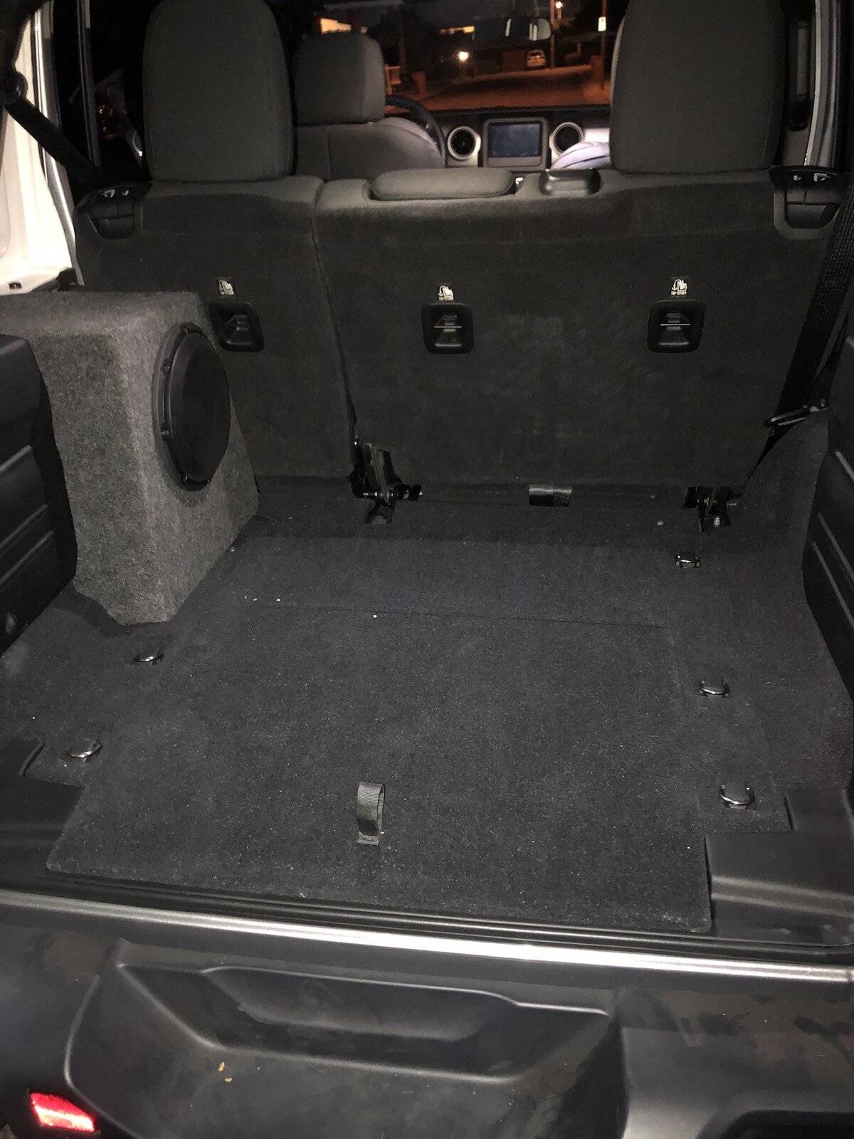

Just traded in my Jeep and will be selling my pac Amppro non-alpine I’ve also got a custom sub box and amp rack for the JLU. I would sell the sub box and amp rack locally in AZ. Willing to ship Pac Amppro.
