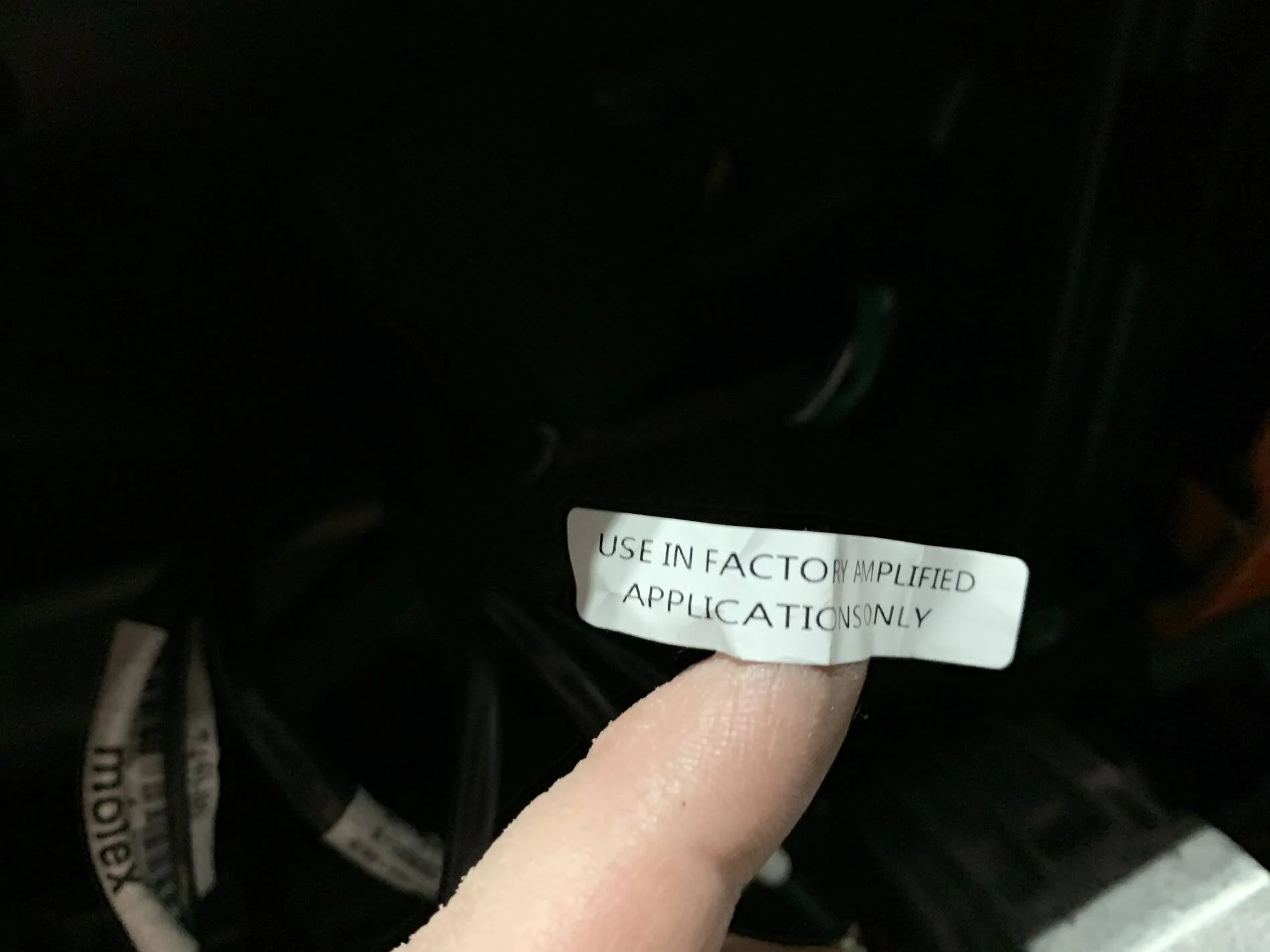

That’s great to hear. I was on the fence about even installing mine if you weren’t able to get it working properly. So did you end up leaving that ‘mystery connector’ on the wire harness connected or disconnected? And what were your final dip switch settings?
Krondor
Jan 23, 2018
49
30,770
212,262
Here, but soon there
2018 Punk'n Jeep Wrangler JLR
I connected it as it powers the stock sub. Now I get the stock sub and amplified speakers.
I'm not sure why it was tapped with this?

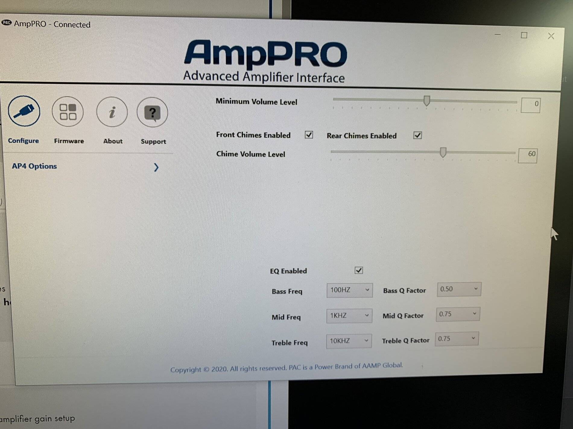

I still need to update the PAC unit software. My experience so far has not been super impressive. The system is louder than the stock system. If you use an aftermarket head unit you will need to purchase the kit for NON-OEM headunits. I can only speak for the OEM head unit kit as far as plug and play goes. Everything is included as far as wiring harnesses and amp wiring power harnesses back to the battery, the RCA cables, amp storage bracket that goes under the passenger seat, etc... the kit comes with two 2 channel amps that power the front and sound bar speakers. There is no amp included for the sub but when you run all of the wires the wires and connections are already included to make adding a sub amp very easy. I preferred the sub amp from my quart and have not received it yet so I cannot give any opinions on the sub connected to the mb quart amp. You do not splice or tap into any existing speaker wires which is great if you want to use them in the future. You will have to extensively modify your soundbar to add the 6x9 speakers. That part cannot be undone without buying a new soundbar. I am still on the fence as far as giving my final opinion of the system because I have not played with it enough and I still need to add the amp for the sub. The install is very involved as far as how much you have to take apart but I feel like any upgrade to the JL speakers would be. The instructions included are pretty clear. I am hoping I can get the PAC unit software updated and the the amp for the sub makes a positive difference. I will be interested to hear what @Krondor has to say as he has been tweaking things today.
