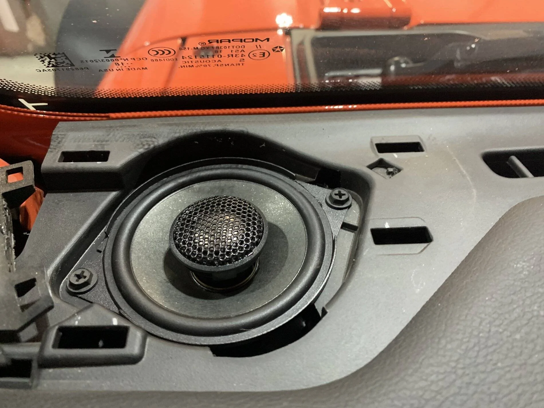

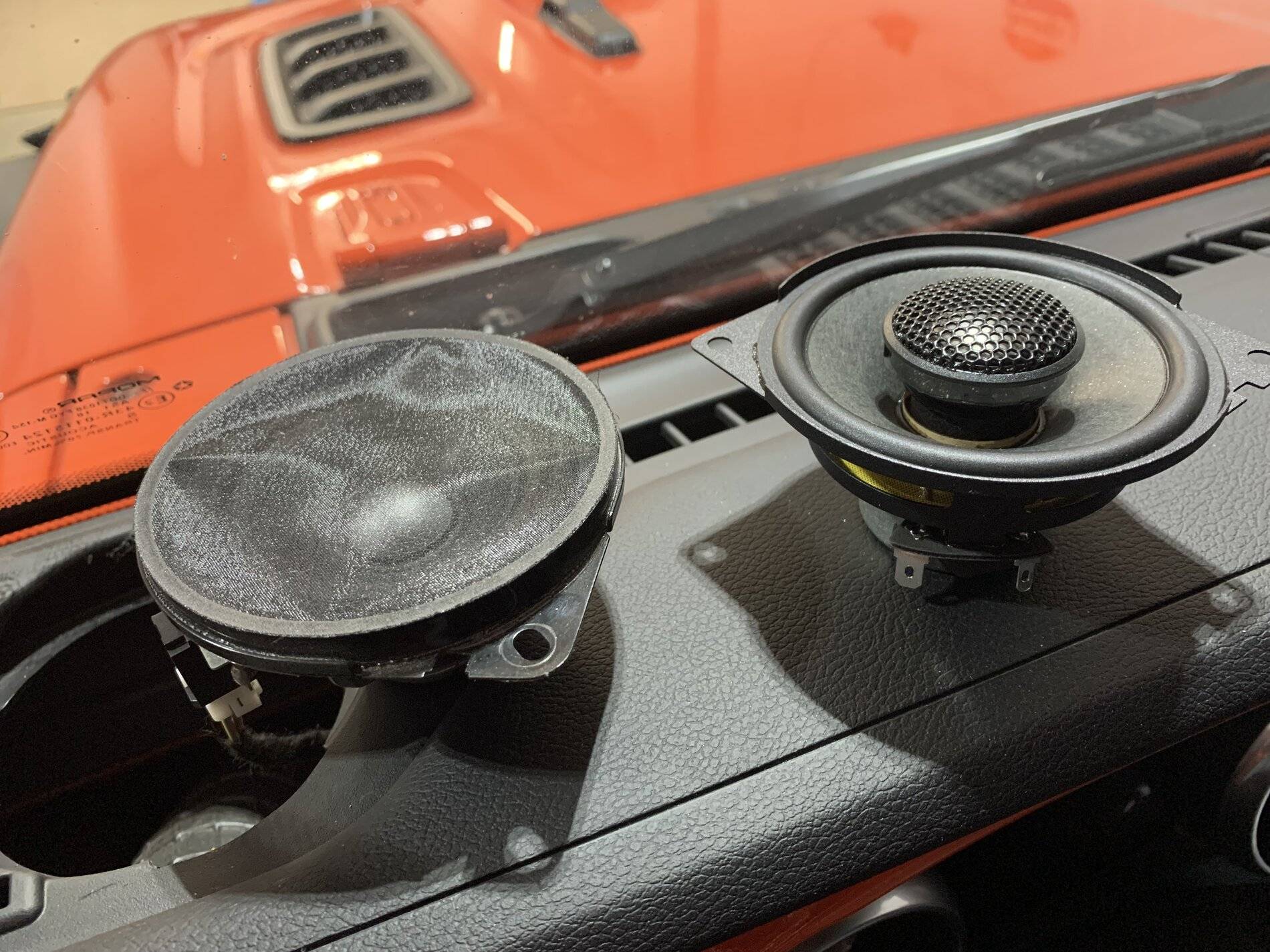

Before I tore out the guts of my Jeep, I just replaced the dash speakers to hear the difference.
Jeep Wrangler JL Adding an Aftermarket Amp(s) CBD5364B-5DAF-40A6-946B-29AF6F0C3305
Jeep Wrangler JL Adding an Aftermarket Amp(s) 14F2D978-D431-4C02-8D4E-04D1697B7758
I like the added details that a real tweet adds to the music.
Nice balance with the new MBQuart.

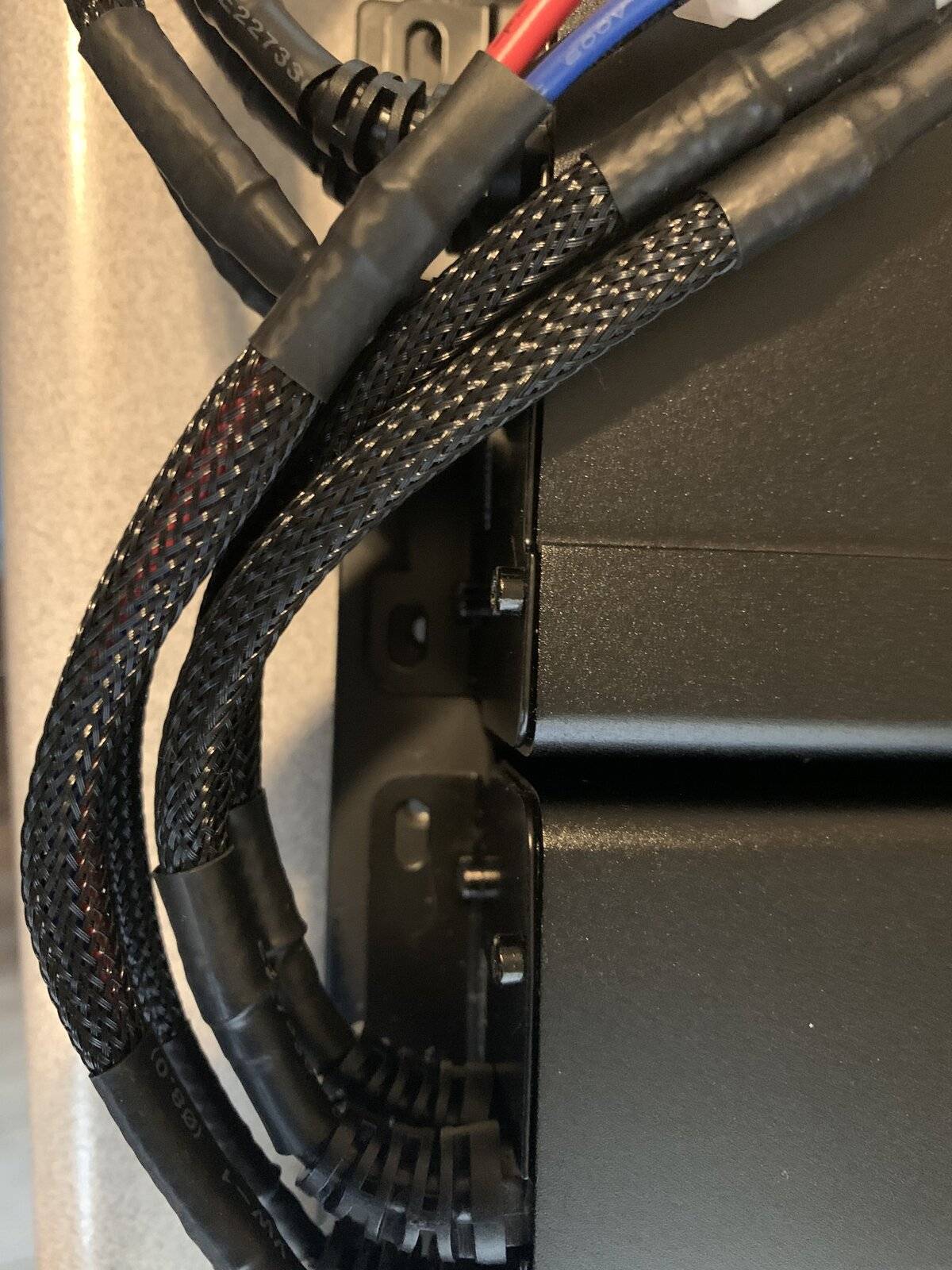

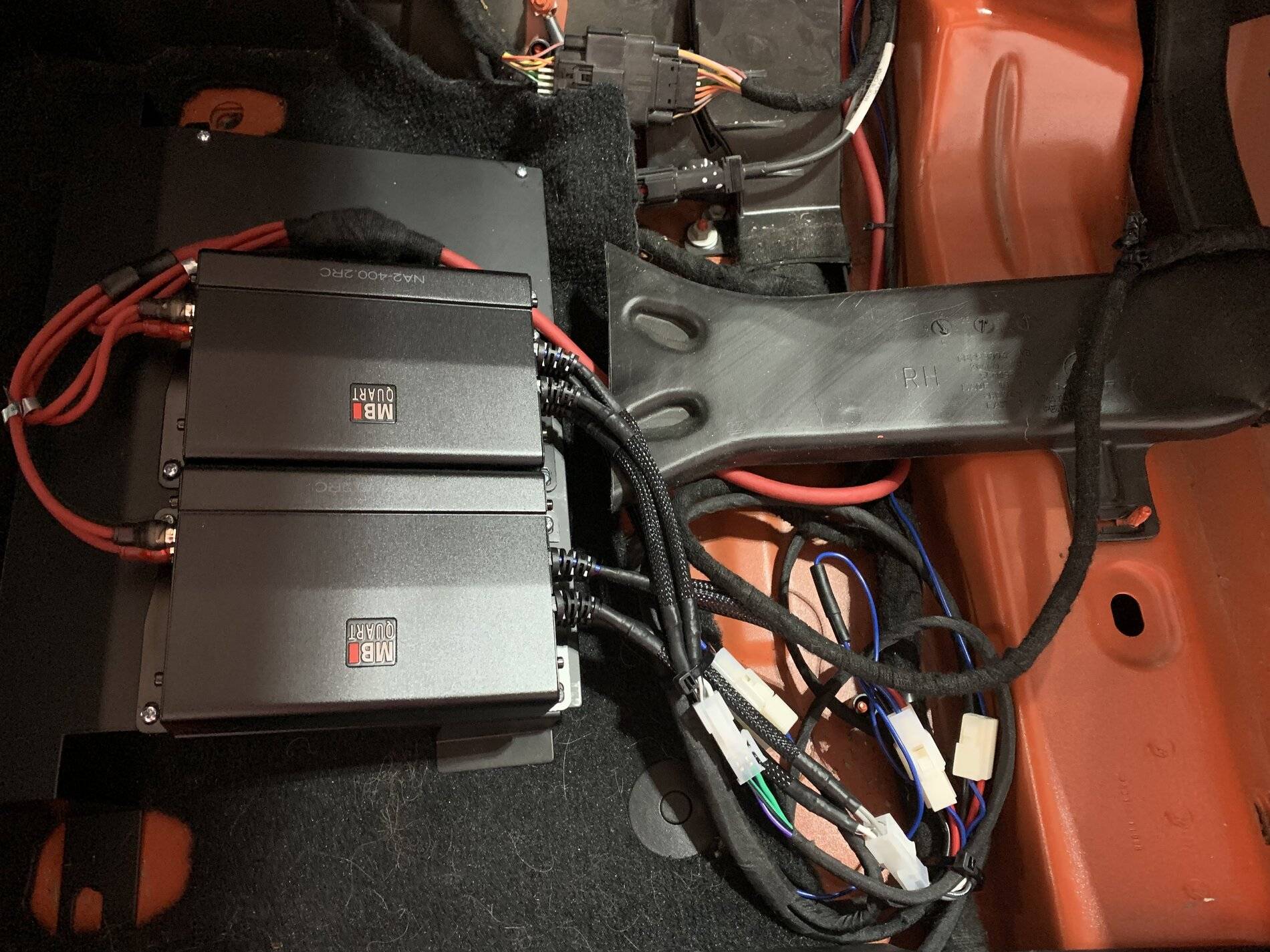

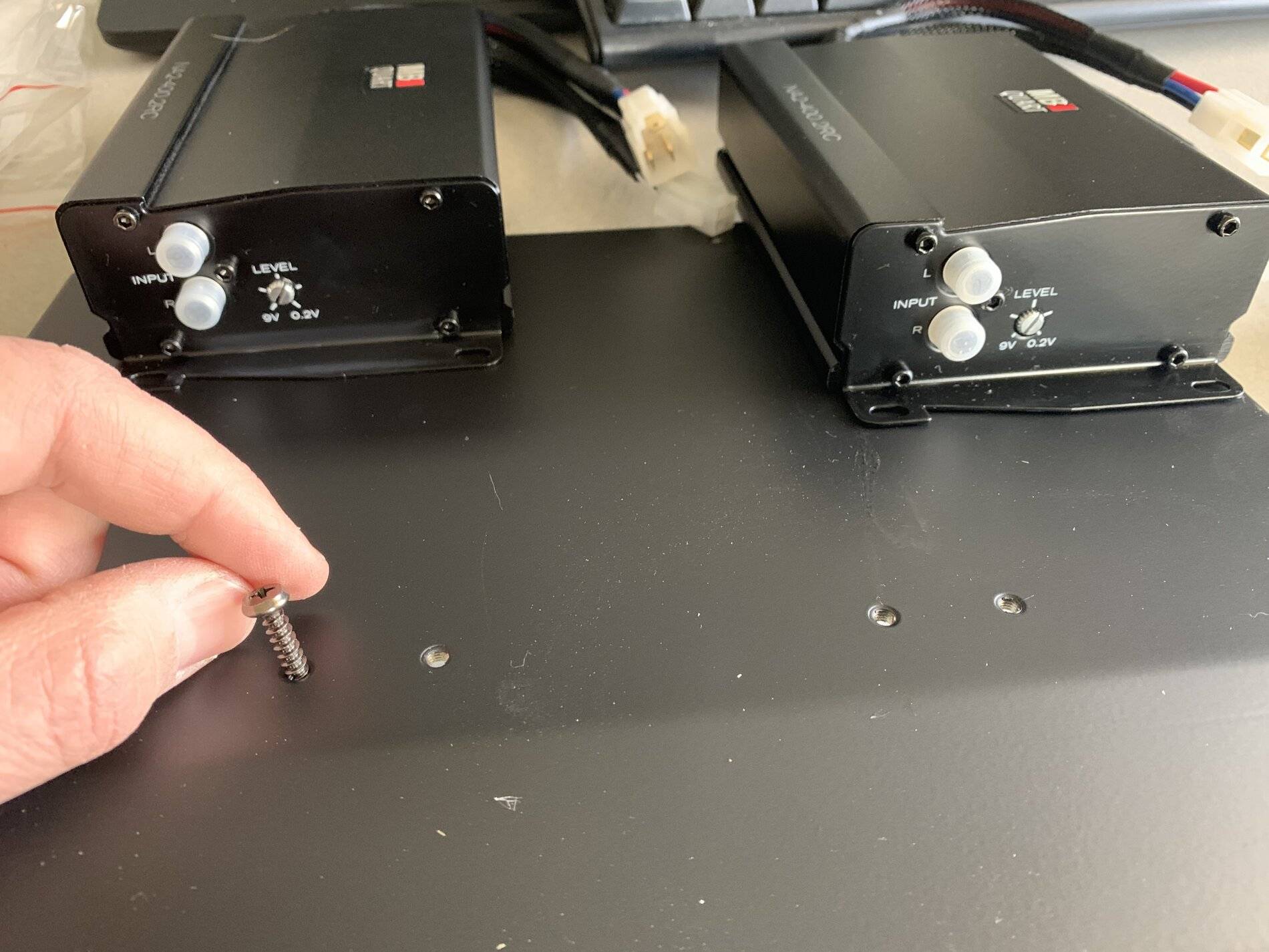

Now for the rest. The amps will need a bit of modification to fit the provided base. The holes are a bit off. Also, get yourself some M4-70 screws as the base takes them and I didn’t want to use the self tapping metal screws provided.
Jeep Wrangler JL Adding an Aftermarket Amp(s) 780D45B3-0040-4687-8662-E7434C26BFCF
Jeep Wrangler JL Adding an Aftermarket Amp(s) D1B7C4B1-C23B-49CF-B1E6-7CDE82EE1255
When mounted on one side, the holes are only "just" off. So Dremel time. Luckily, I have to use it to modify the soundbar anyway.

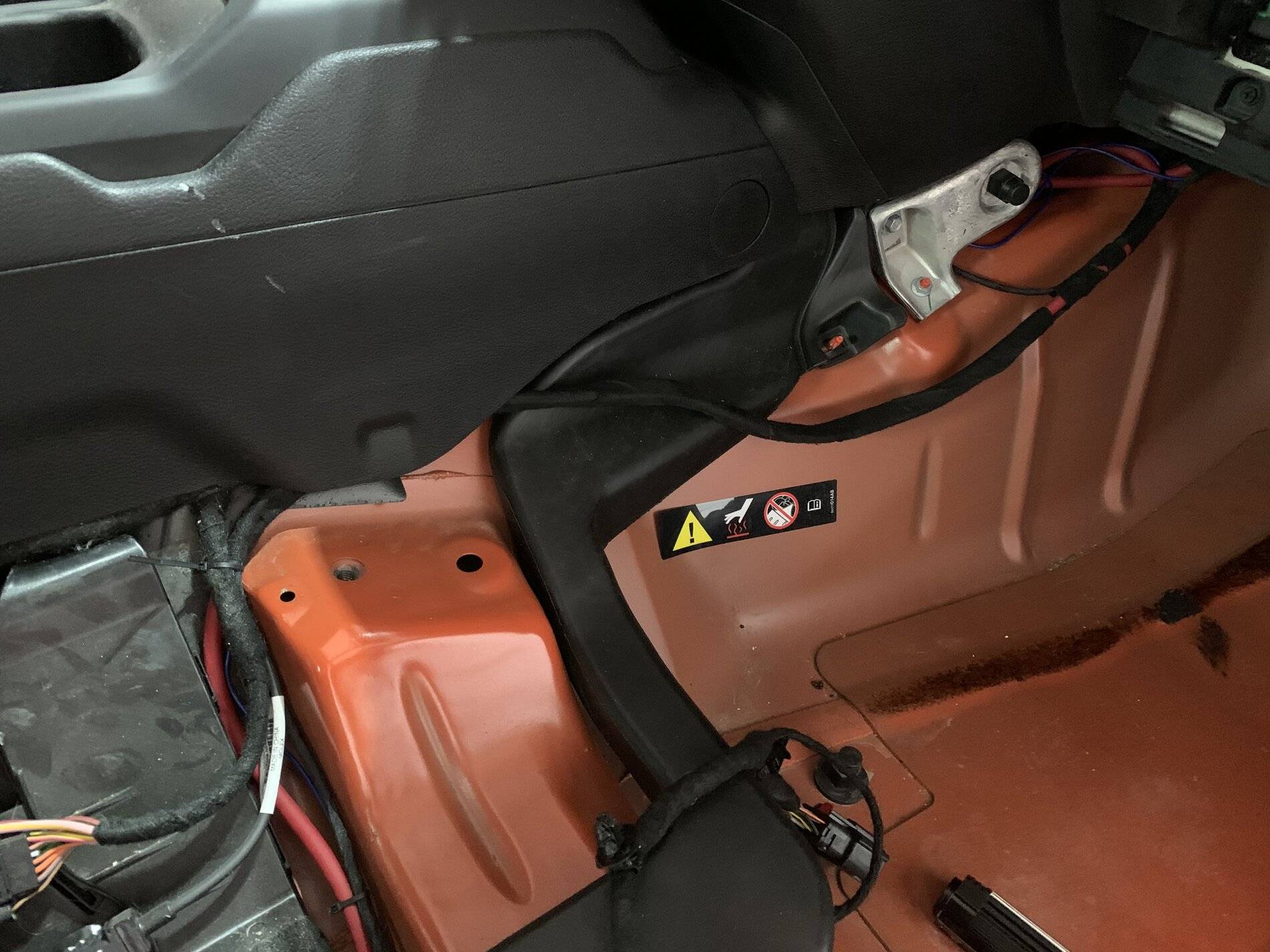

Just to get a feel, I installed just the dash speakers and plugged the battery in for a little listen. Great upgrade in details and not overly bright, which I was worried about. I am really impressed.
Mother's day and work has me a bit behind, but I'll be pulling the interior apart and getting the rest installed this week. The amp rack goes under the passenger from the instructions.

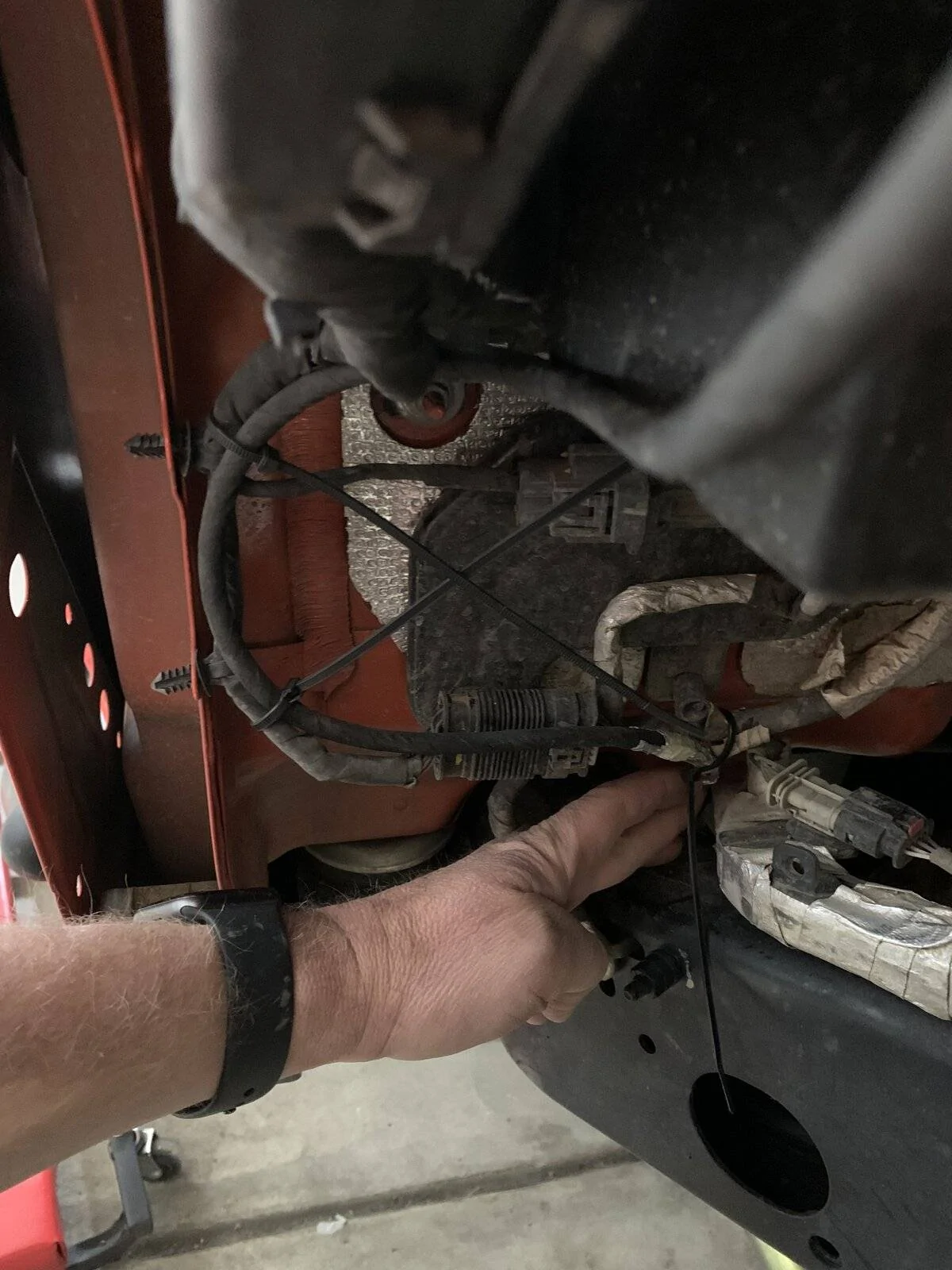

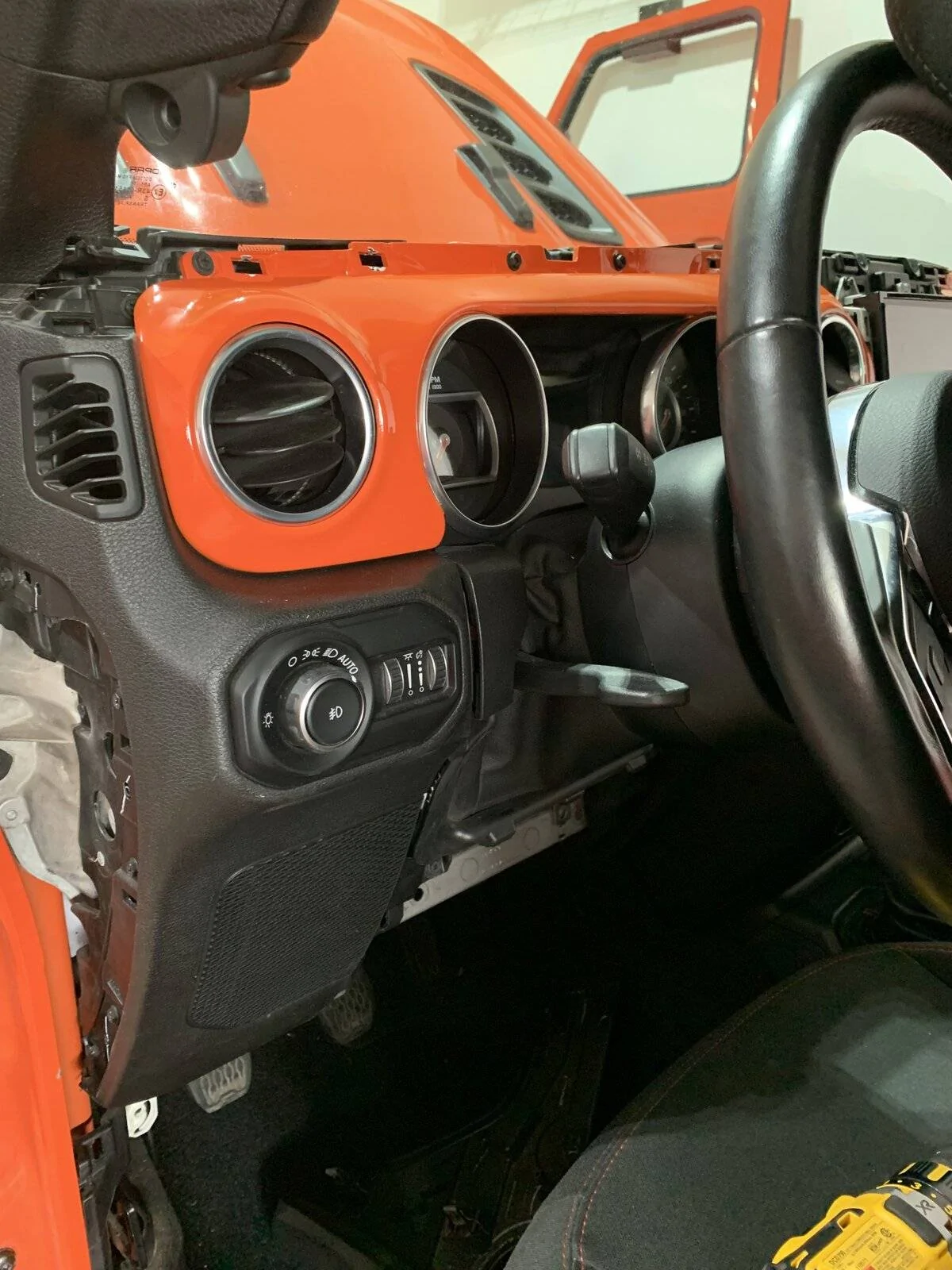

Hopefully I will get time to finish today. The front speakers are in, amp wires were run, and I'm now figuring out how the hell to stuff the added wire harness behind the radio.
Jeep Wrangler JL Adding an Aftermarket Amp(s) B1A54C62-8482-4C5A-BD4C-08446C491AC6
Jeep Wrangler JL Adding an Aftermarket Amp(s) 7E7FBA0B-1BB9-4A9E-9E4A-2E0196E36432

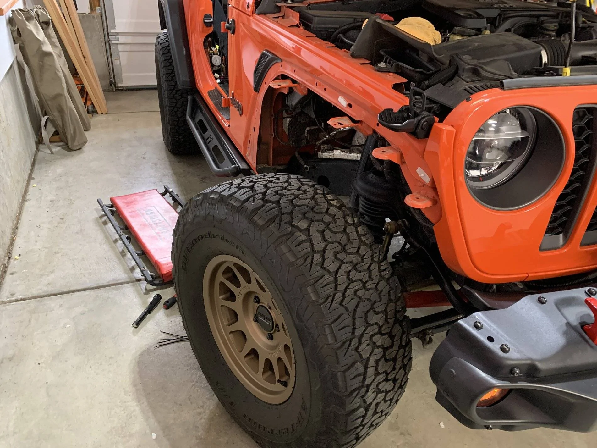

Had to pull my passenger front fender off to make sure the power wire was routed away from the cat, and that was a PITA. New clips on order. :CWL:

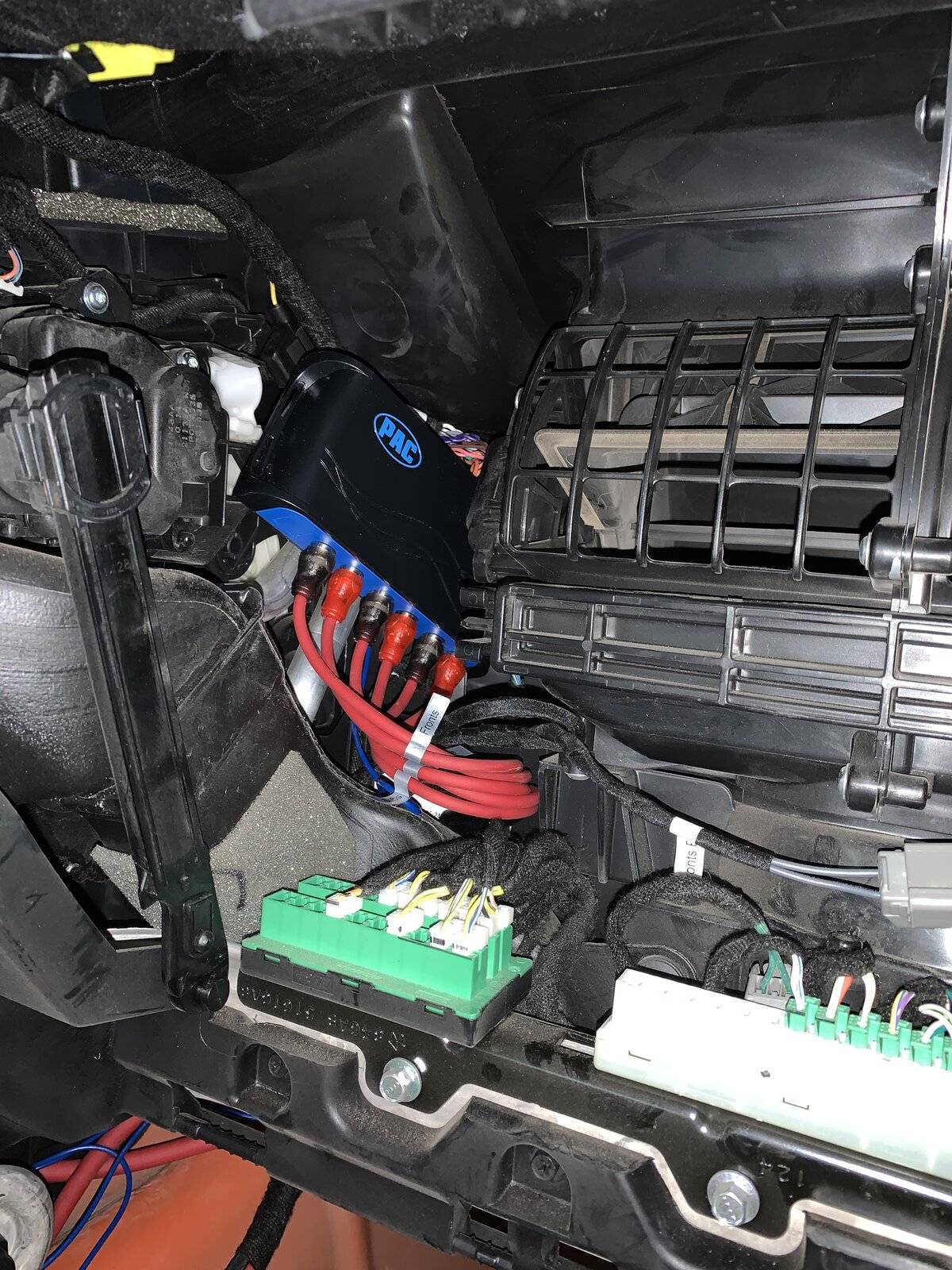

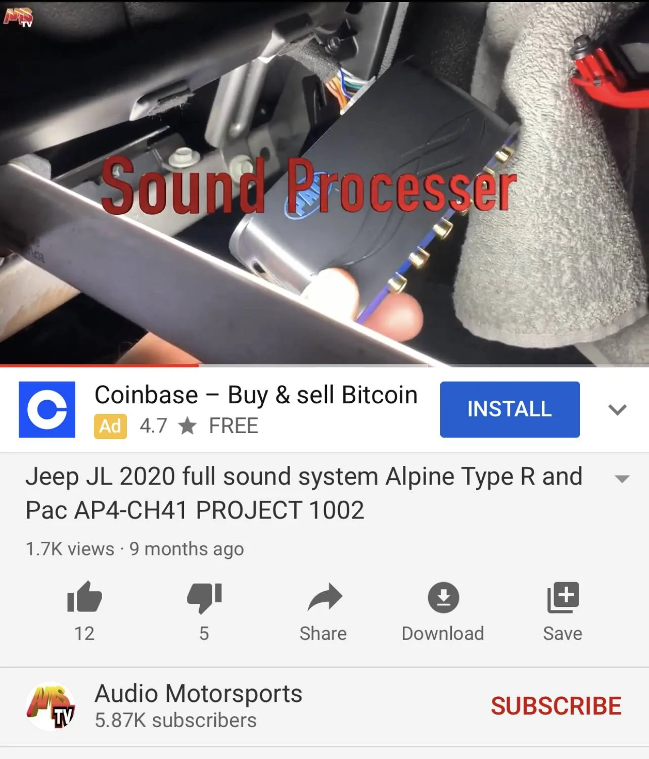

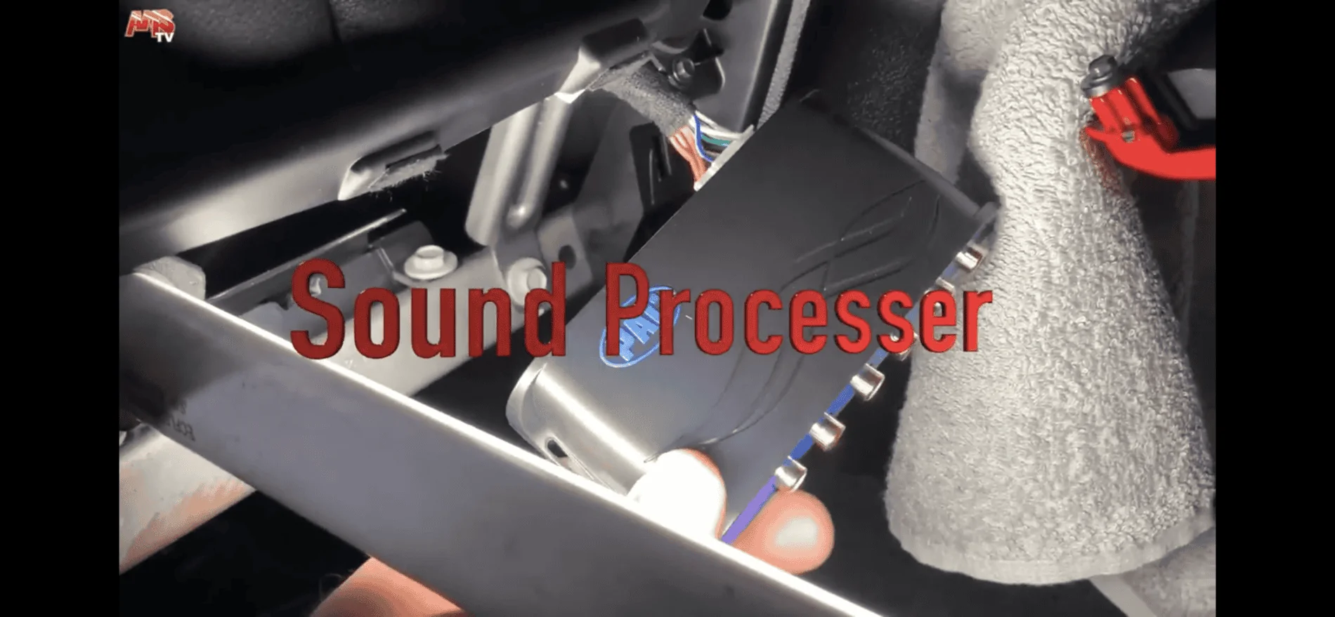

In this YouTube video about installing a PAC amp unit into a 2020 Wrangler they hang the rca plug-in portion down to the left under the dash panels under the steering wheel. I have not opened my box yet so I am not sure how long those wires are. The rest of the video is useless in helping with any other part of the install but that gives you a suggestion on where they ran it. Quick question abou t the amp power wires, why didn’t you run them through the grommet on the right side?I ran my wiring through there when I installed the AUX switches and it was a pain but they went right through with a wire coat hanger. That fender removal does look like a pain.

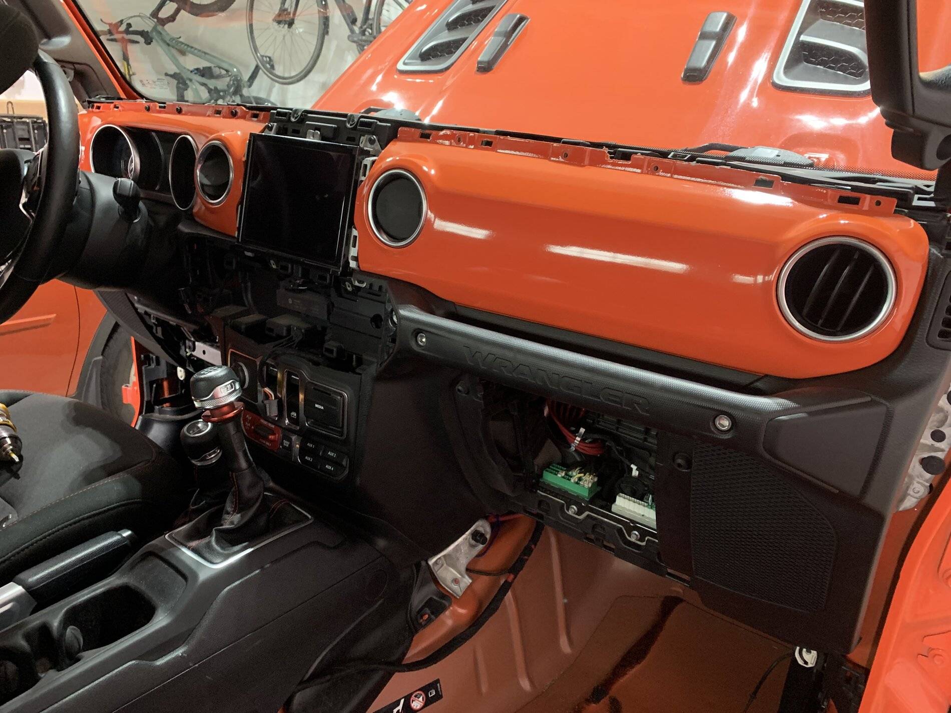

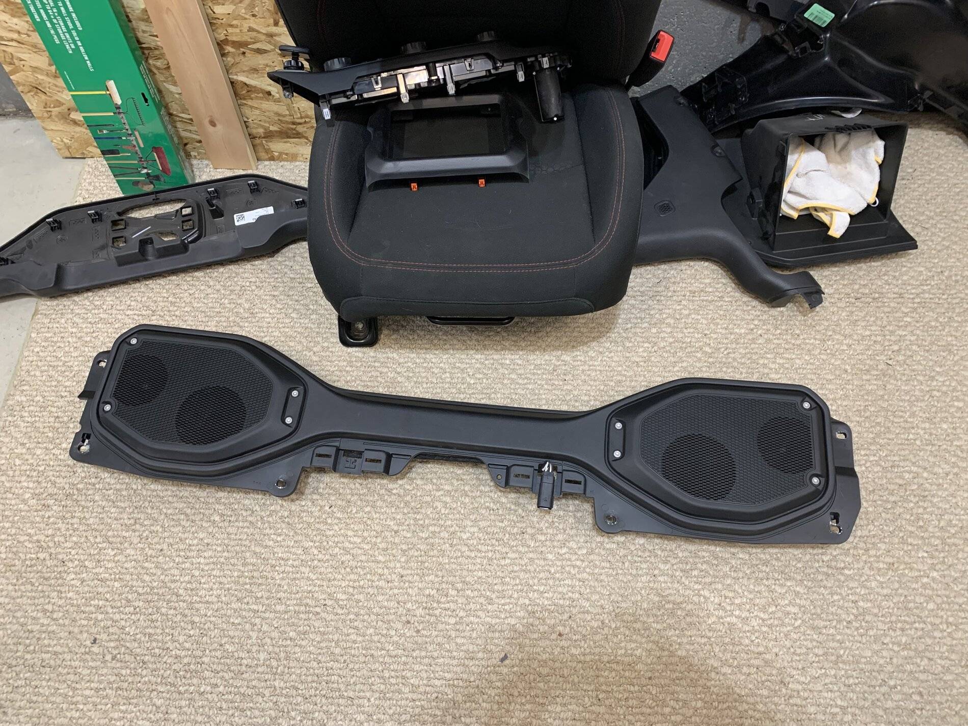

So finally got amps and front speakers tied up.
Now I fit the 6x9’s in this sound bar. Got to put some rubber where the sound bar touches the sport bar to keep it from vibrating while I’m at it.

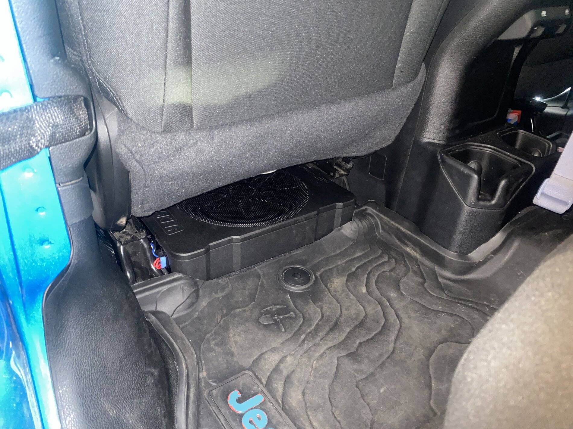

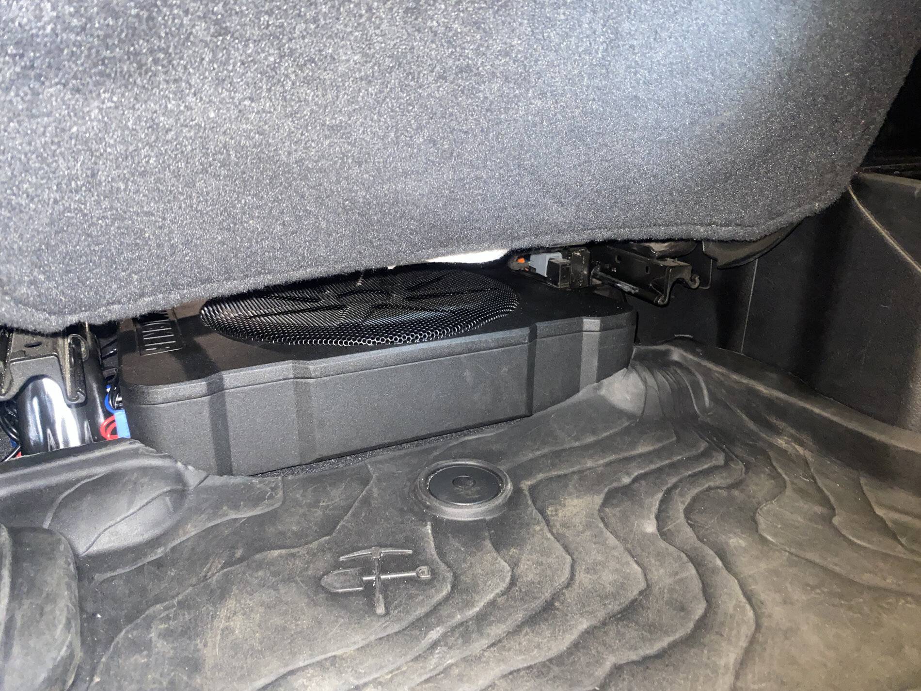

For these mid priced upgrades you guys have going on, If your missing the subwoofer sound and don’t mind an underseat, get the kicker HS10.
It fits under the drivers seat pretty well, and for an underseat preforms great. Filled in a lot of the sound I felt was missing when I replaced the fronts and backs with alpine 6.5 components.

Did you have to remove the seat to get the sub in?
