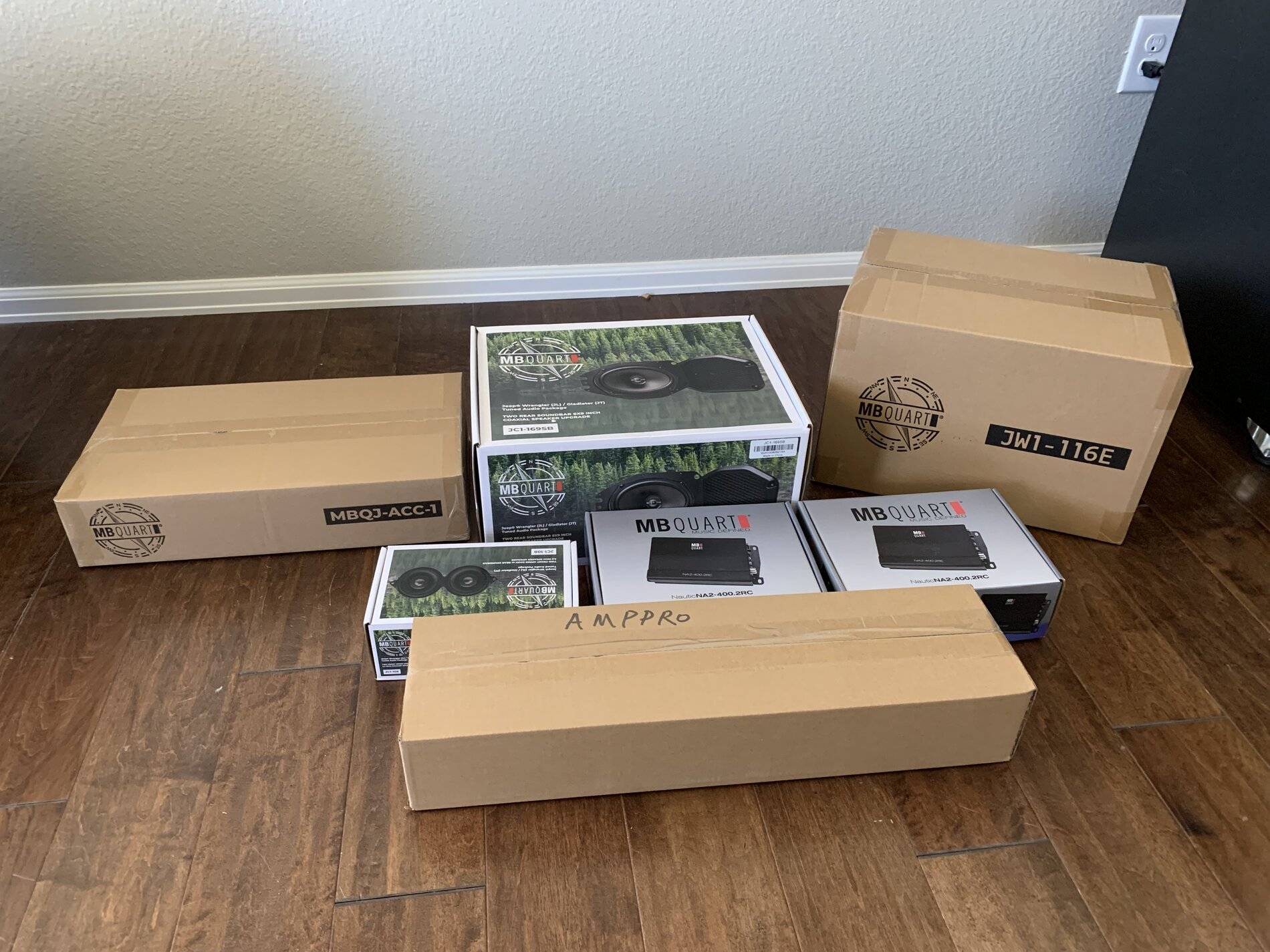

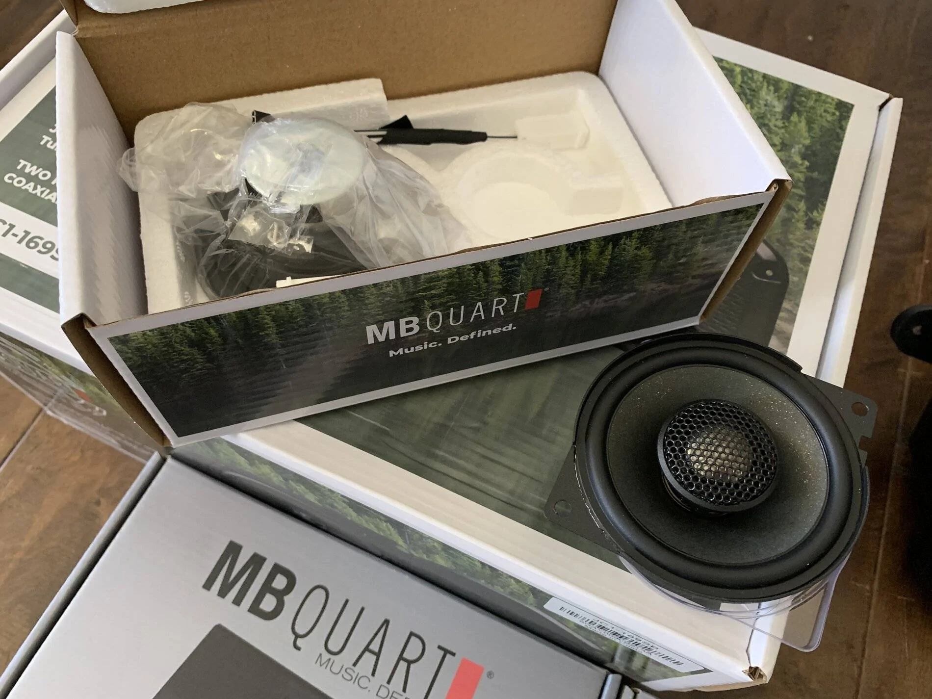

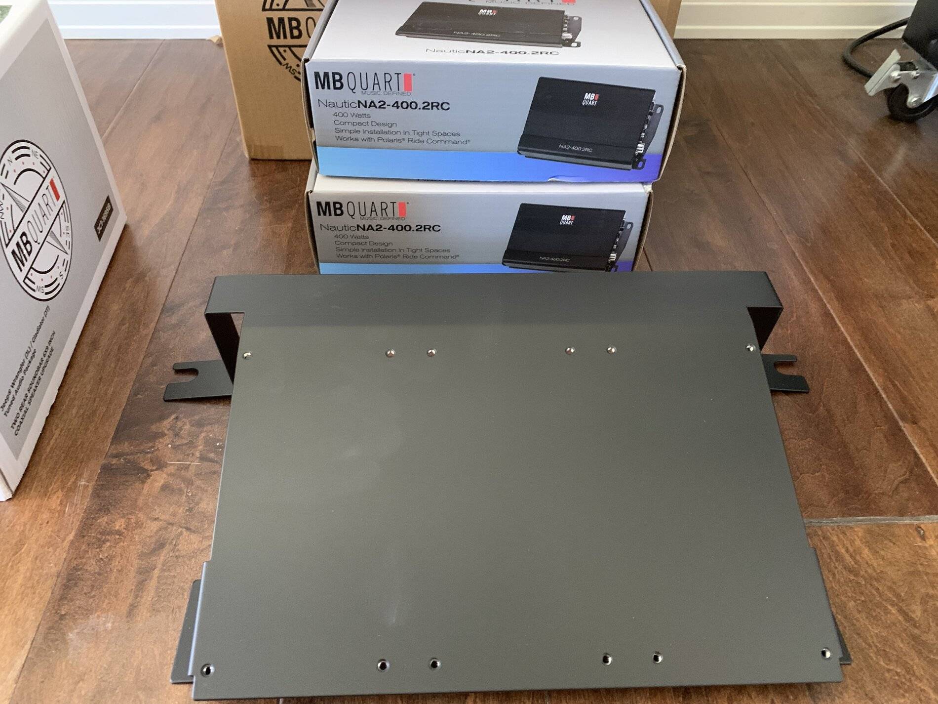

My system arrived already.
Jeep Wrangler JL Adding an Aftermarket Amp(s) 7935D4C5-95B4-40B8-B4A5-7A4367446E73
Looks good so far:
Jeep Wrangler JL Adding an Aftermarket Amp(s) 6CF58BC5-6B08-4764-9C13-0807924E8C0B
Jeep Wrangler JL Adding an Aftermarket Amp(s) 6593E113-D7BF-402B-9952-824F3E5F9818

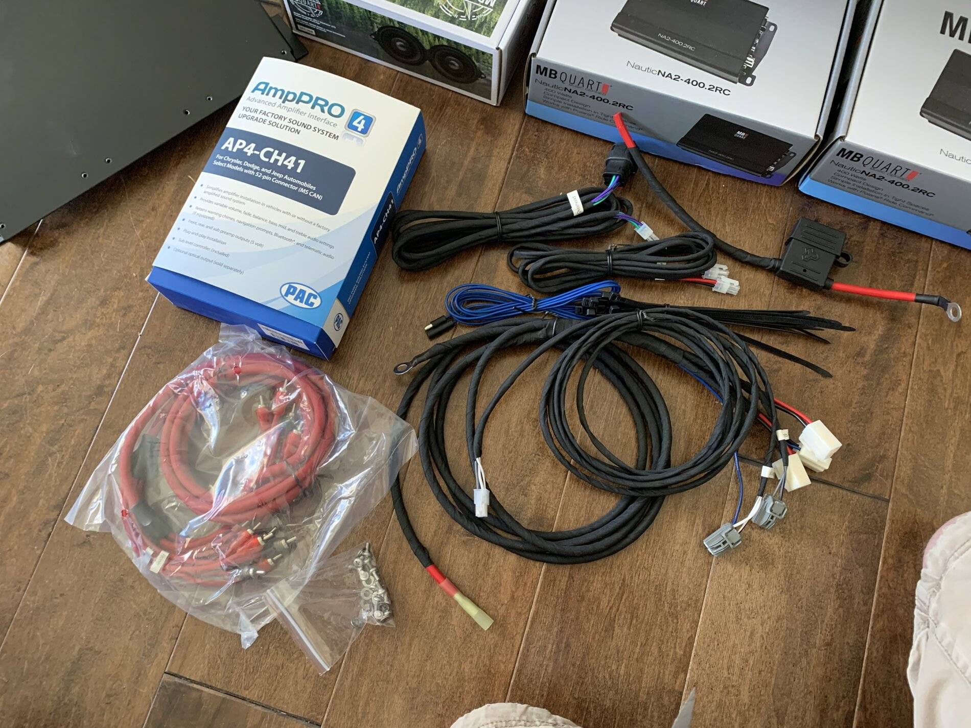

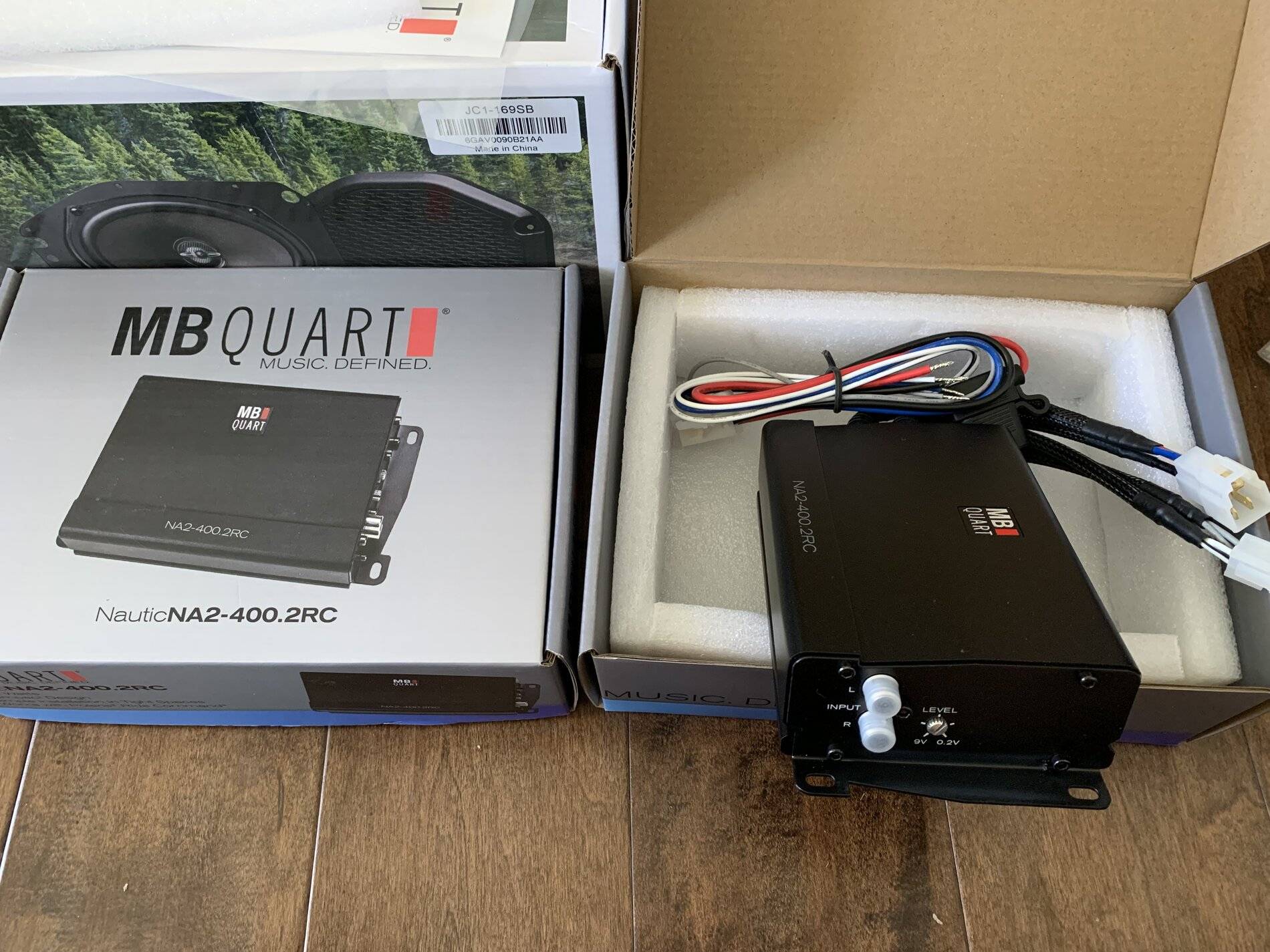

RCA cables and PAC confirmed.
Jeep Wrangler JL Adding an Aftermarket Amp(s) 339A0F16-BB20-4660-9B38-D29B1A90426D
Amps are small but have a bit of heft. Class D, so efficient but maybe not SQ level gear. Will hope for the best.
Jeep Wrangler JL Adding an Aftermarket Amp(s) B5D2E2EC-7976-48BD-B9D6-4D6B19302598
The mount looks good. Will test fit both sides tonight after dismantling the dash.
Jeep Wrangler JL Adding an Aftermarket Amp(s) 6487C344-2950-42F1-AC1C-B99C454B0A6E
Dash speakers look to be quality parts.
Jeep Wrangler JL Adding an Aftermarket Amp(s) 5F88BDE6-D4FB-4B17-8406-A42C8F658106

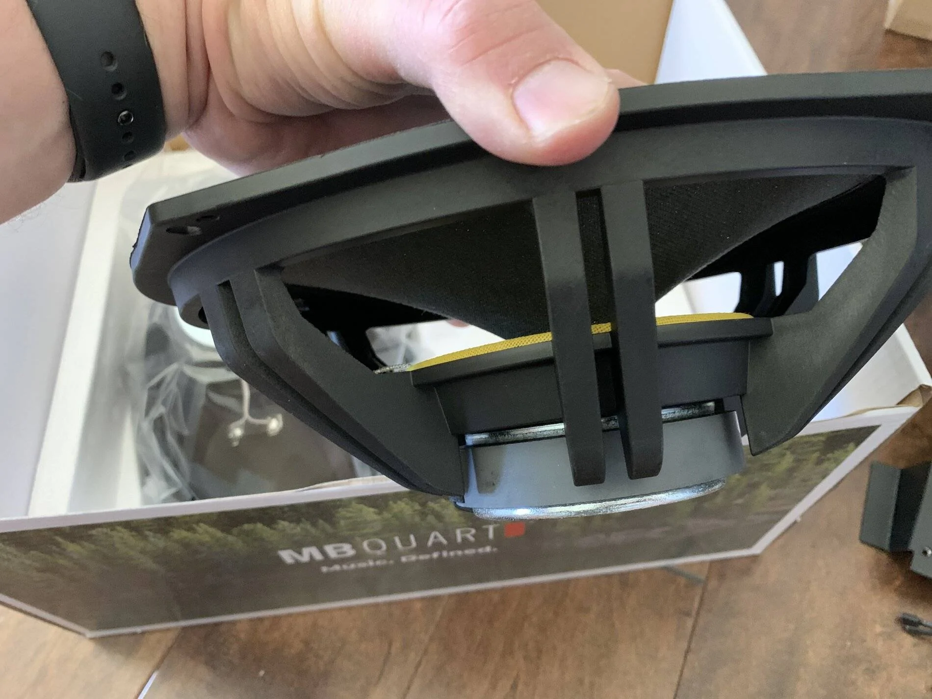

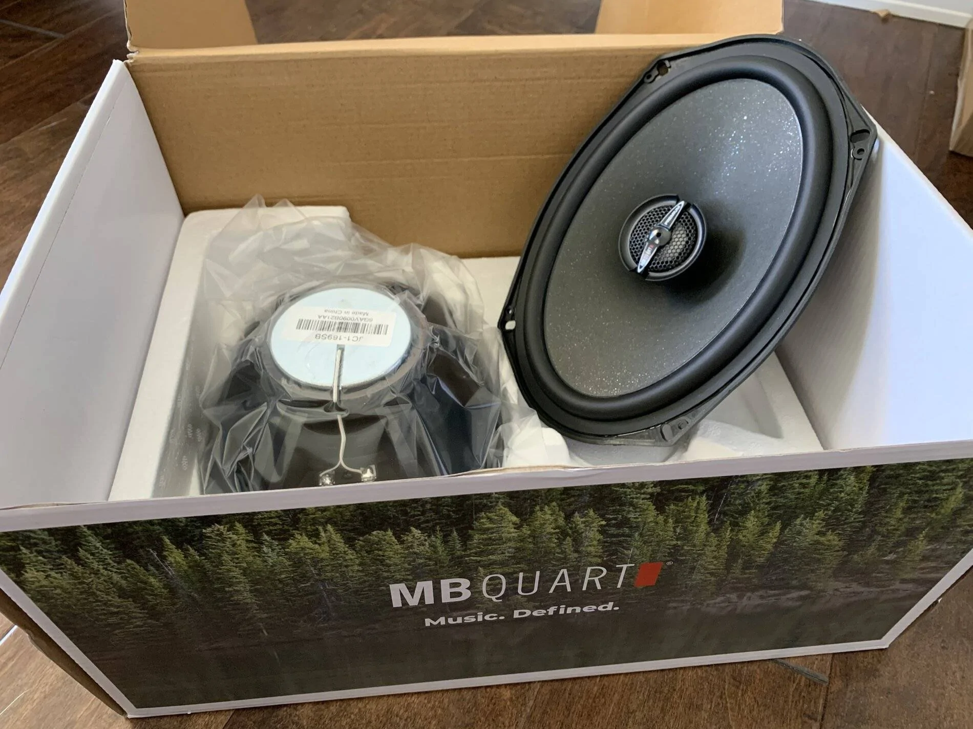

The 6x9's also look well made. Can't wait to hear the difference. No going back after the 6x9's are mounted.
Jeep Wrangler JL Adding an Aftermarket Amp(s) 14B59C67-DEFA-4169-AF87-56BCF3D22B6A
No sub or sub amp, but I bet they will be an add on later. We will see.

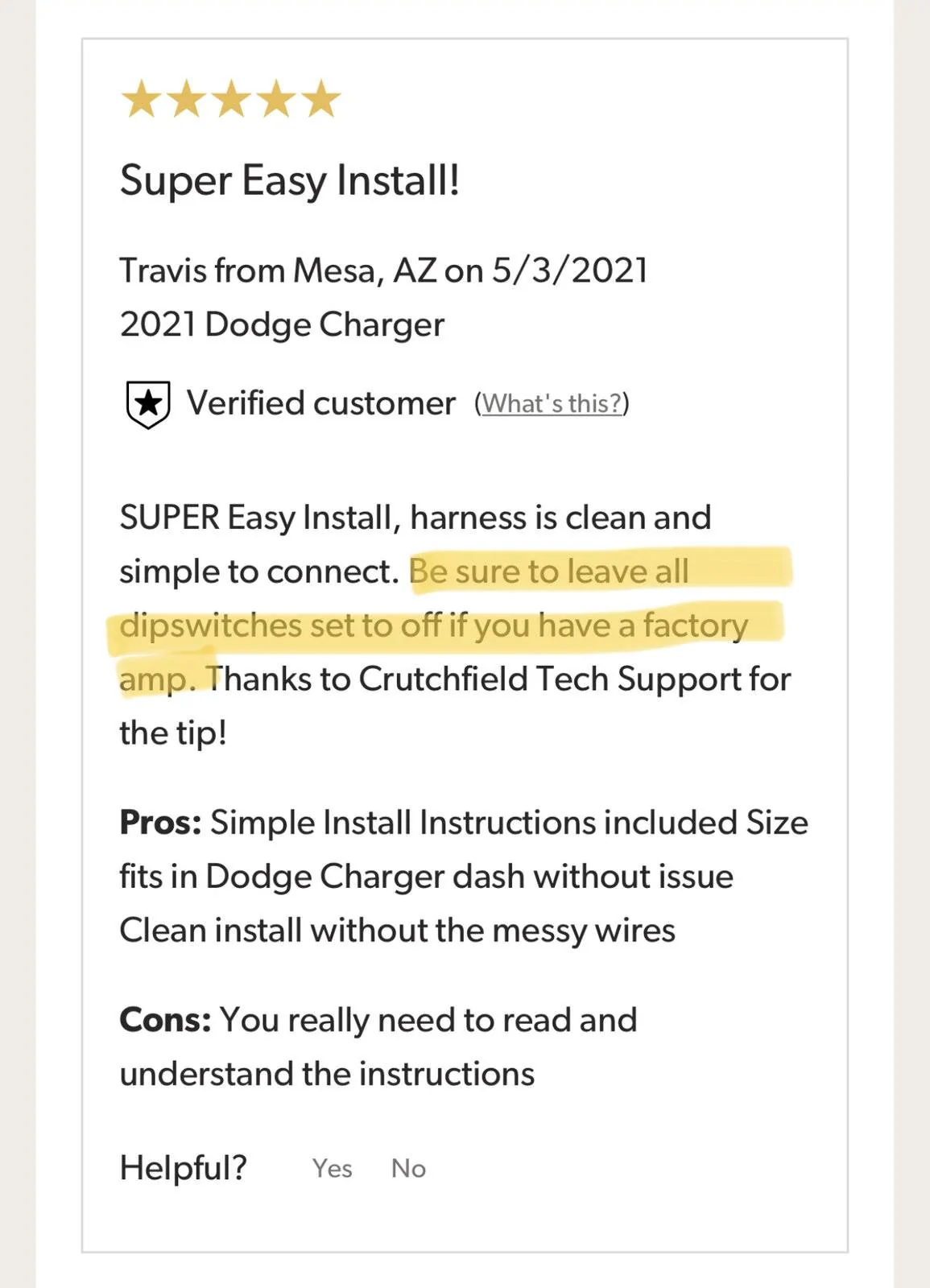

Ordered this a couple days ago and your sub question made me do a little digging. According to the PAC AP4-CH41 info page online (pictures show this model) it says this:
“It can be used to upgrade the entire sound system or just part of it thanks to the retention of the original amplifier”
Then has a diagram which looks like you can still use the OEM amp along with this system to run the sub.
*How it works:
Jeep Wrangler JL Adding an Aftermarket Amp(s) DDC019F9-44FC-4F40-AE62-FE9298E7D160
This is one of the reviews on crutchfield for the PAC unit. Maybe you turn the dip switches on for the two amps for the front and rear speakers and off for the sub amp since you still want to use the alpine sub from the upgraded system. Whoever installs this that has the upgraded alpine system please update us on this and well...everything else. I don’t even have a tracking number yet. I ordered on Friday.
