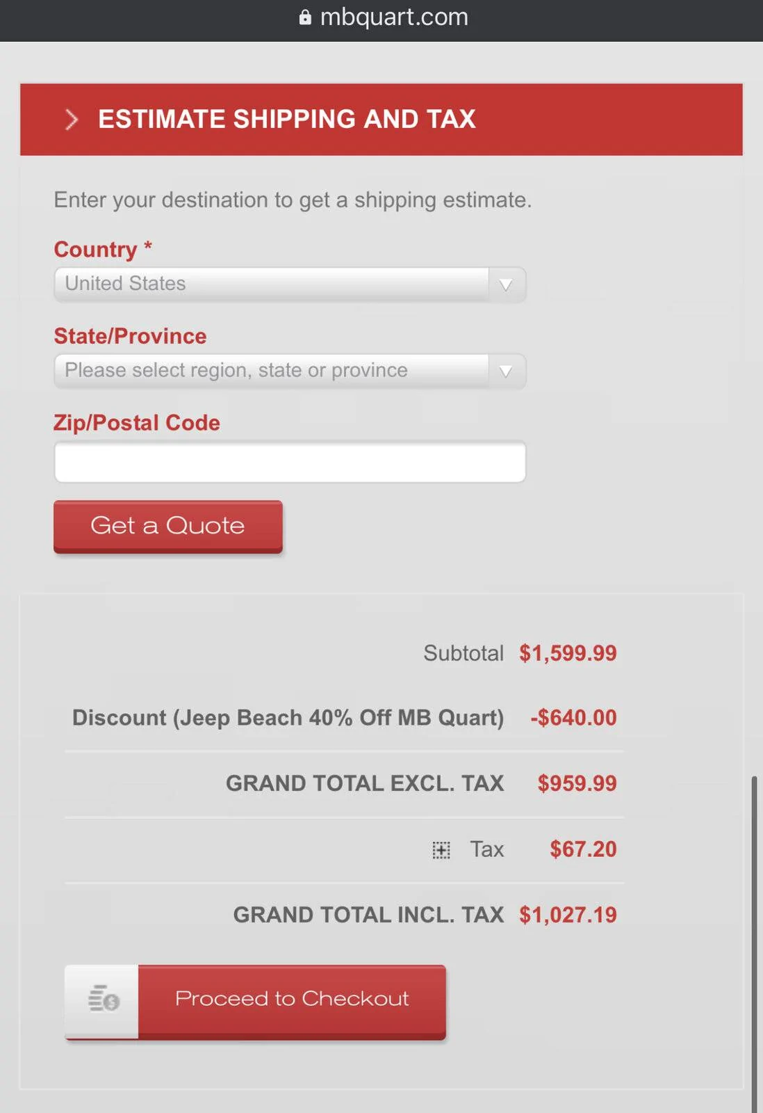

Looks like the code works, I did not purchase them but it did recognize the code at checkout.
At that price this MBQuart system is really tempting. What I can't tell from their website is if this includes any DSP. They show it includes two amplifiers, each with a pair of RCA inputs, but it's really unclear as to how you get a signal from the OEM headunit into the two amplifiers. If I need to purchase a DSP separately that's fine, but the 3-band OEM GEQ doesn't cut it for me.
