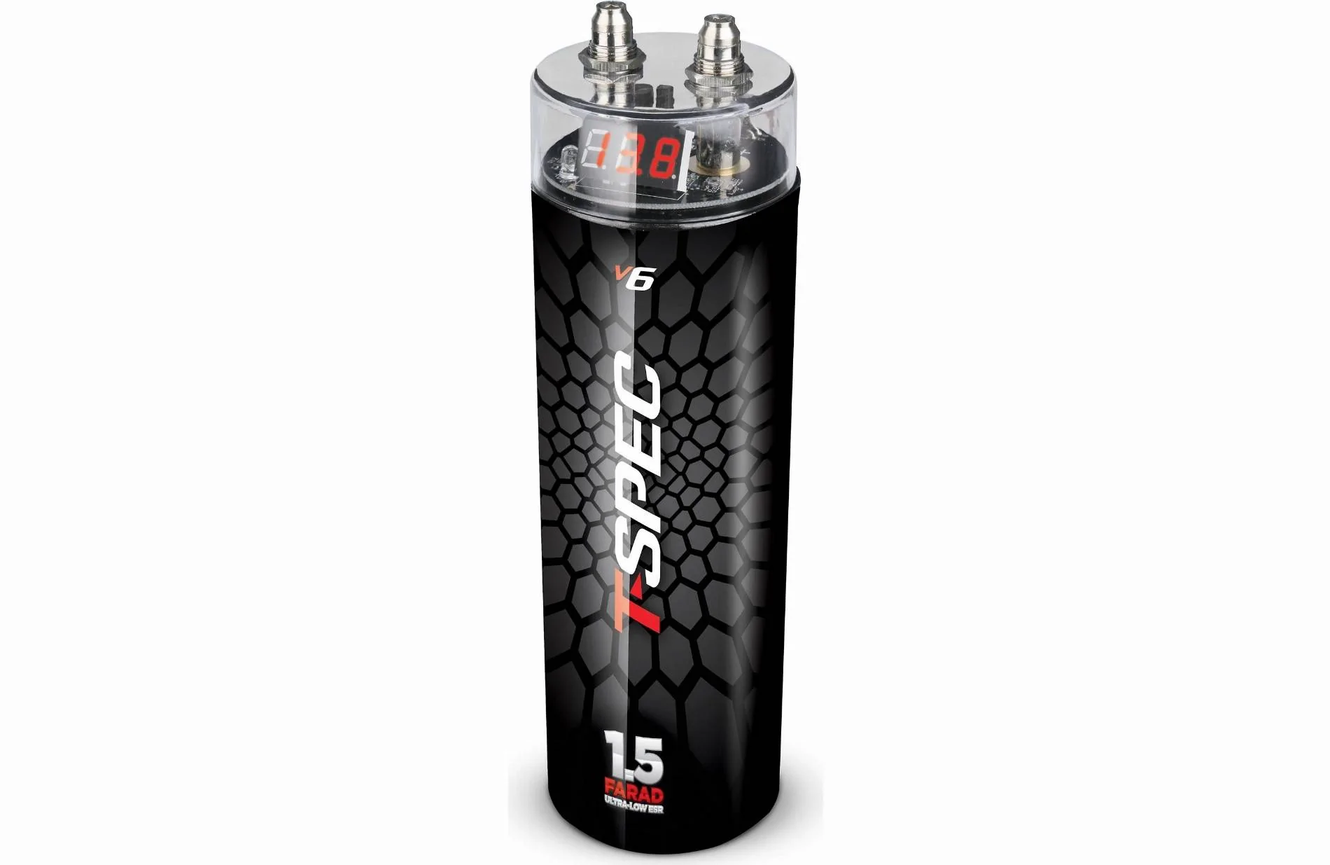

It looks like you are troubleshooting it correctly. It definitely appears to be a low voltage issue, but I'm concerned that it drops down to 9-10 volts at crank. I would wager you have a battery going bad. One other option to look at would be to buy an inline capacitor and tie it in pre-amp to your 4 gauge wire.
https://www.crutchfield.com/p_12015DDC/T-Spec-Capacitor.html
