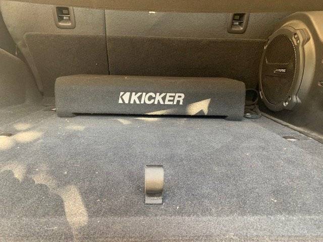

Where did you get the sub cover?

just flat in the cargo area against the back seats. its load bearing so can just throw things on top if need.
I left the factory sub in place bc didn't have the time to rip out yet. plus also wanted to keep the flexibility to add a larger sub later when brackets become more readily available.
like this... https://www.jlwranglerforums.com/fo...-using-same-housing.54580/page-4#post-1417777
Did you pull your audio feed from the sound bar of from the subwoofer harness? I've been trying to figure out what is best for powering just a woofer in a Jeep that has the Alpine system. I know that the feed is pulled from the sound bar for many, but most of those don't have a woofer feed to pull from.
I installed a new amp under the front passenger seat (and replaced front and soundbar speakers with 6.5's) and ran new speaker wire to the dash and soundbar (probably overkill though). I left the factory soundbar speaker wire (cut at the soundbar interconnect) and the factory sub speaker wire. If i venture down the path of replacing the factory sub, i'll probably just run a new speaker wire there as well.
by the way, i really like you 3D print. really interested to hear how it installs / sounds.
