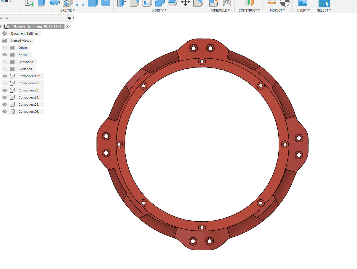

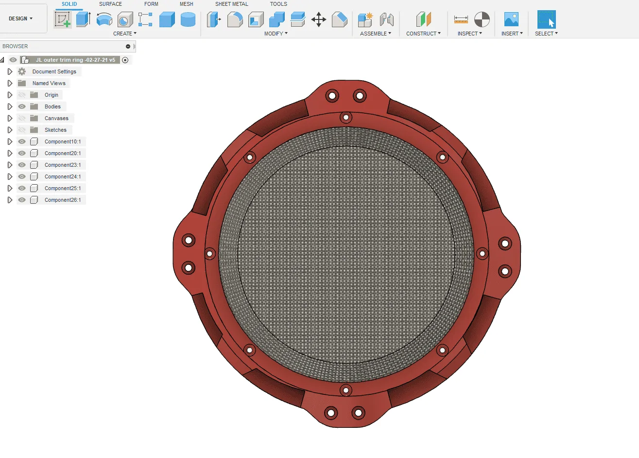

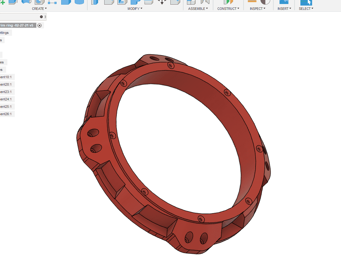

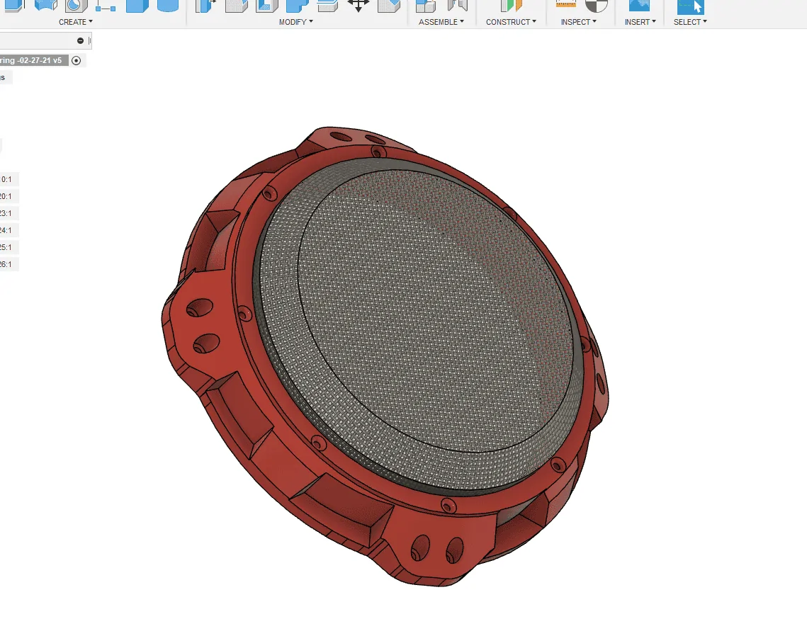

One last design update. I think this will be the final version. Print time is down to 32 hours with this one, and it is a much cleaner design. I created a component to replicate the JL grill that can be purchased with the speaker I am getting. I'm still not sure how well this would play out for the community, as with the quality of material I use to print with, as well as the time taken away from other projects, my cost comes out to $73.28 as calculated by the software I use for pricing prints. Then there is the hidden issue of failed prints that cost me. It isn't many, but I'd say one in 10 has a flaw. With needing to absorb that potential, these would have to sell for around $150.00. I just don't see there being a market for that. If someone knows of a company that can take my design and make a mold of it and mass produce it, then I can contact them and maybe we can get a product that is affordable.

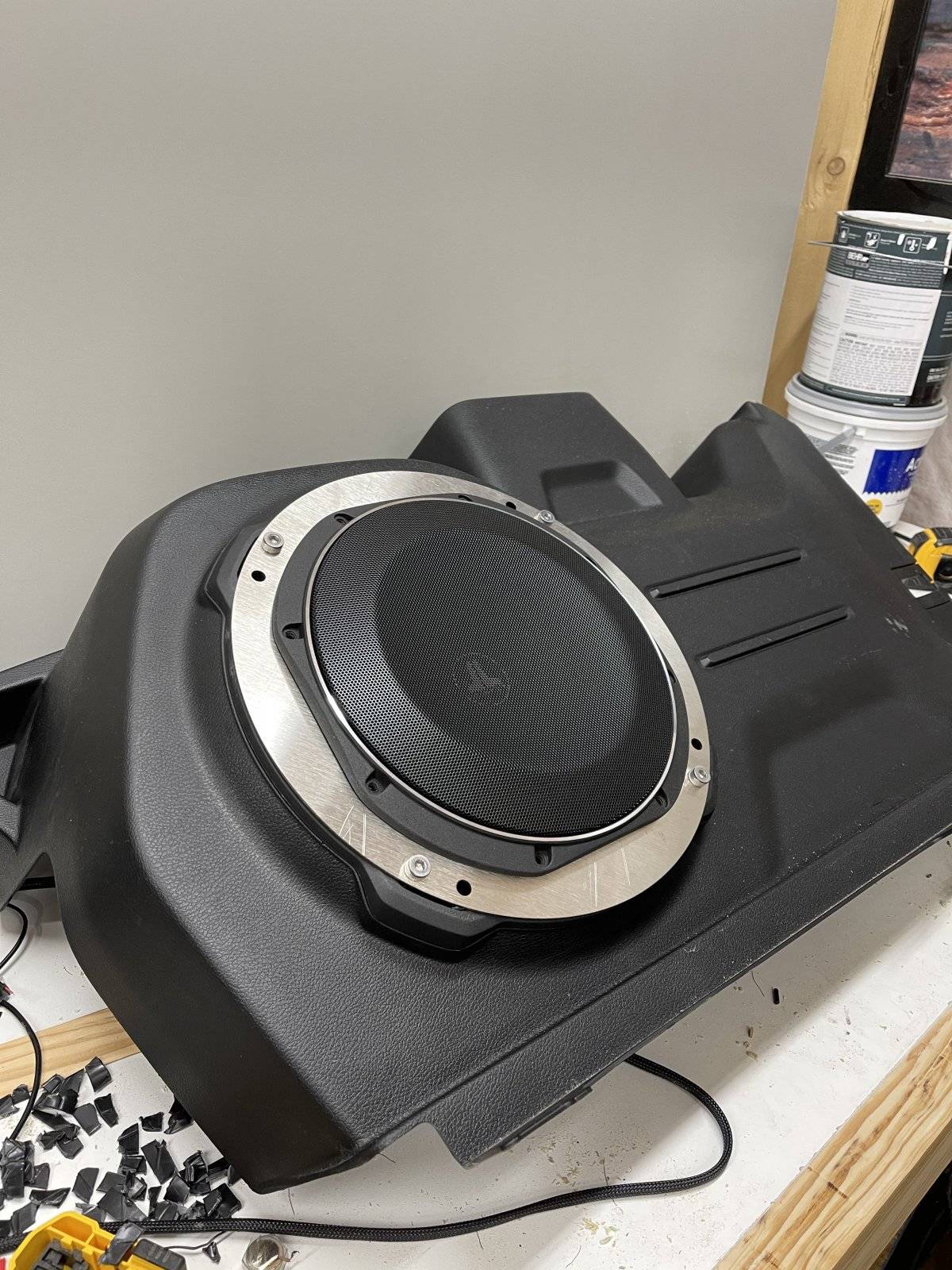

I’m loving all of the CAD and 3D Printer designs! This is what I was looking for a week ago. My 3D printer isn’t large enough to print entire ring so I divided ring into 4 identical pieces that overlapped at the bolt locations. But I have a friend who laser cut a piece of stainless steel to make my adapter. I went this route but forgot to account for the depth. So I had to mount the adapter on top of the Jeep ring and I had to remove some of the enclosure ribbing behind the sub. Fits perfectly now.

How is the sound? I'm buying stock in dynamat..LOL. Just as insurance against vibrations. I'm also wrapping the back of the enclosure with it so it doesn't vibrate against the body.
chris1374
Feb 22, 2018
36
Slidell, LA
2019 JLU Rubicon (Ordered 10/24)
I finally got it fully installed and playing yesterday and it sounds great! I did place dynamat inside the enclosure on any flat surface that I could reach and then some more along the flat sections of the fender well before I reinstalled the enclosure to the Jeep. I may add some polyfill later to see if that has any effect on the sound.
