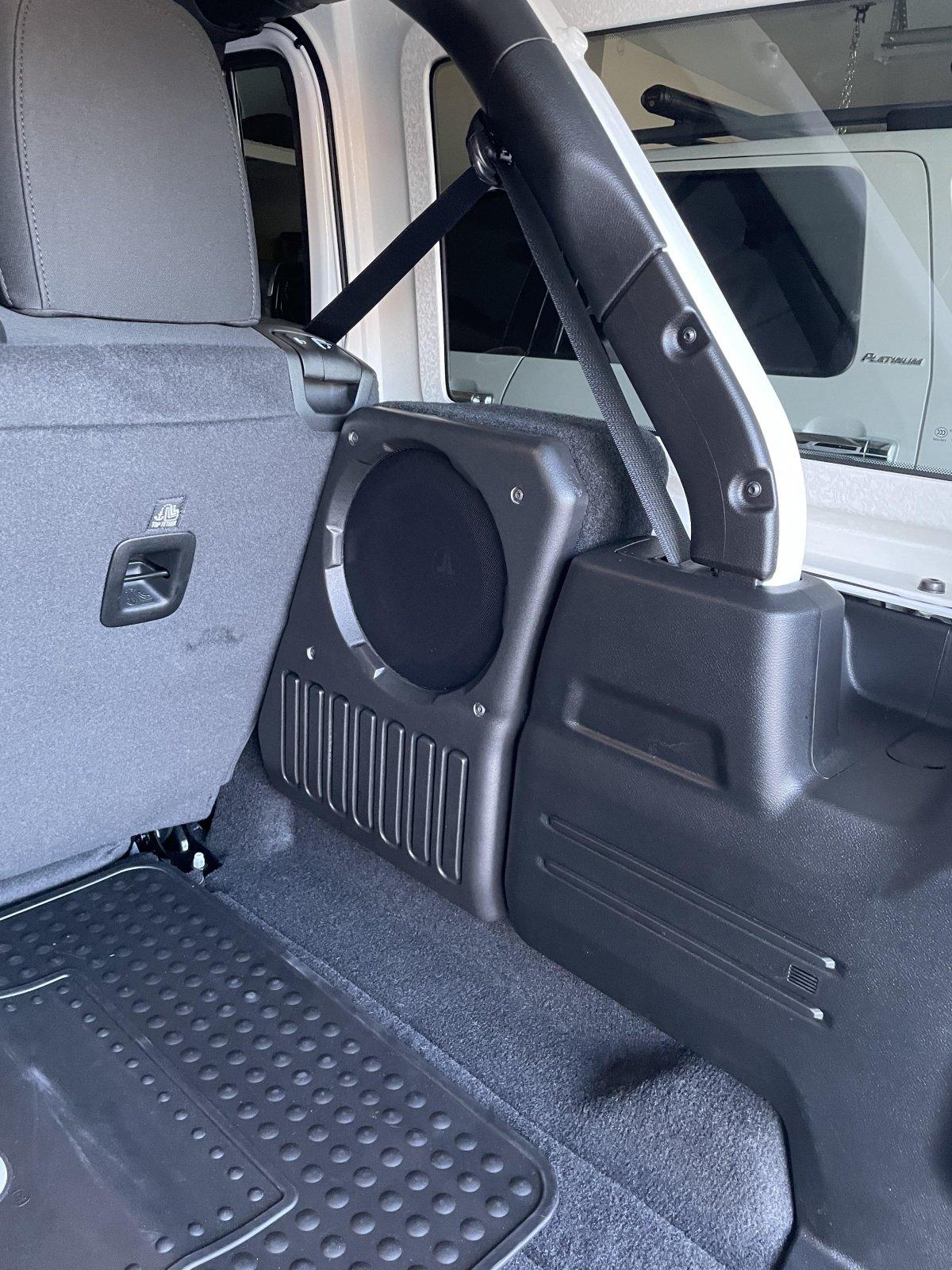

I just finished my stereo upgrade. My first change was from the 7" to the OEM 8.4” Uconnect system. I found a like-new one on eBay for $1,100. That install took about 30 minutes and within a few hours, it had synced up with my Jeep and everything worked great. I did lose the center console USB port, which is a known issue with upgrading to the 8.4”. I was able to sell my 7” for about $500 to offset the cost of the upgrade. The sound is quite good and is definitely louder. The lower impedance tweeters must be drawing more power in from the factory unit. I did not use resistors anywhere and I have not experienced any issues with the head unit cutting out. I installed the included bass control knob that came with my Kicker amp so that I can easily control the sub. I turned the bass down to -2 on the factory EQ.
Here are the components I added:
Infinity Reference Tweeters (these are plug and play for the front dash and roll bar tweeters as many others have mentioned). I have no clue how anyone managed to fit these into the roll bar WITH the bass blockers. There's hardly any room in there.
https://www.crutchfield.com/p_108R3032CM/Infinity-Reference-REF-3032cfx.html
Metra speaker wire adapters (these make the swapping out of the tweeters very simple). If you're replacing the kick panel or the 4" speakers in the roll bar, you will need different adapters.
https://www.crutchfield.com/p_120727902/Metra-72-7902-Speaker-Wiring-Adapters.html
Kicker 300W mono amp
https://www.crutchfield.com/S-B5eglsc3yWR/p_206CXA3001/Kicker-43CXA300-1.html
JL Audio amp rack (makes it so you can seamlessly mount the amp under the passenger seat)
https://www.crutchfield.com/p_13699837/JL-Audio-SBA-J-JLU-UAR.html
JL Audio Stealthbox (crazy expensive, but the only subwoofer I could find with great sound that also kept a very clean look)
https://www.crutchfield.com/p_13694666/JL-Audio-Stealthbox-2-ohm-Passenger-Side.html
Kicker Line Input Converter (I tapped into the rear speaker wires in the B Pillar)
https://www.crutchfield.com/p_20646KISL/Kicker-46KISL.html
Amp install kit
https://www.amazon.com/BOSS-Audio-Amplifier-Installation-Wiring/dp/B000FKP7TY/
