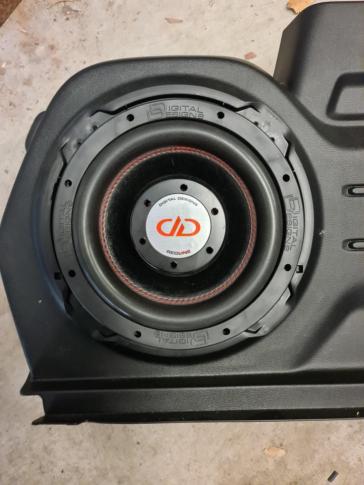

The factory box for the Alpine premium system is 16L (0.55cuft) volume which might be a little small for the 12TW3 you're planning. I know the 10TW3 will go into the available space. The Alpine sub is also tiny in comparison to anything that is aftermarket so its driver displacement is going to be a lot less than anything that replaces it.
I'm going with the DD SL710. It is recommended for anything between 0.4 and 0.8 cuft so should be fine especially if I have to space it out a bit. Going to have to make a custom adapter and grill for it but plan on giving it a significant amount of power to really get the bass bumping.
